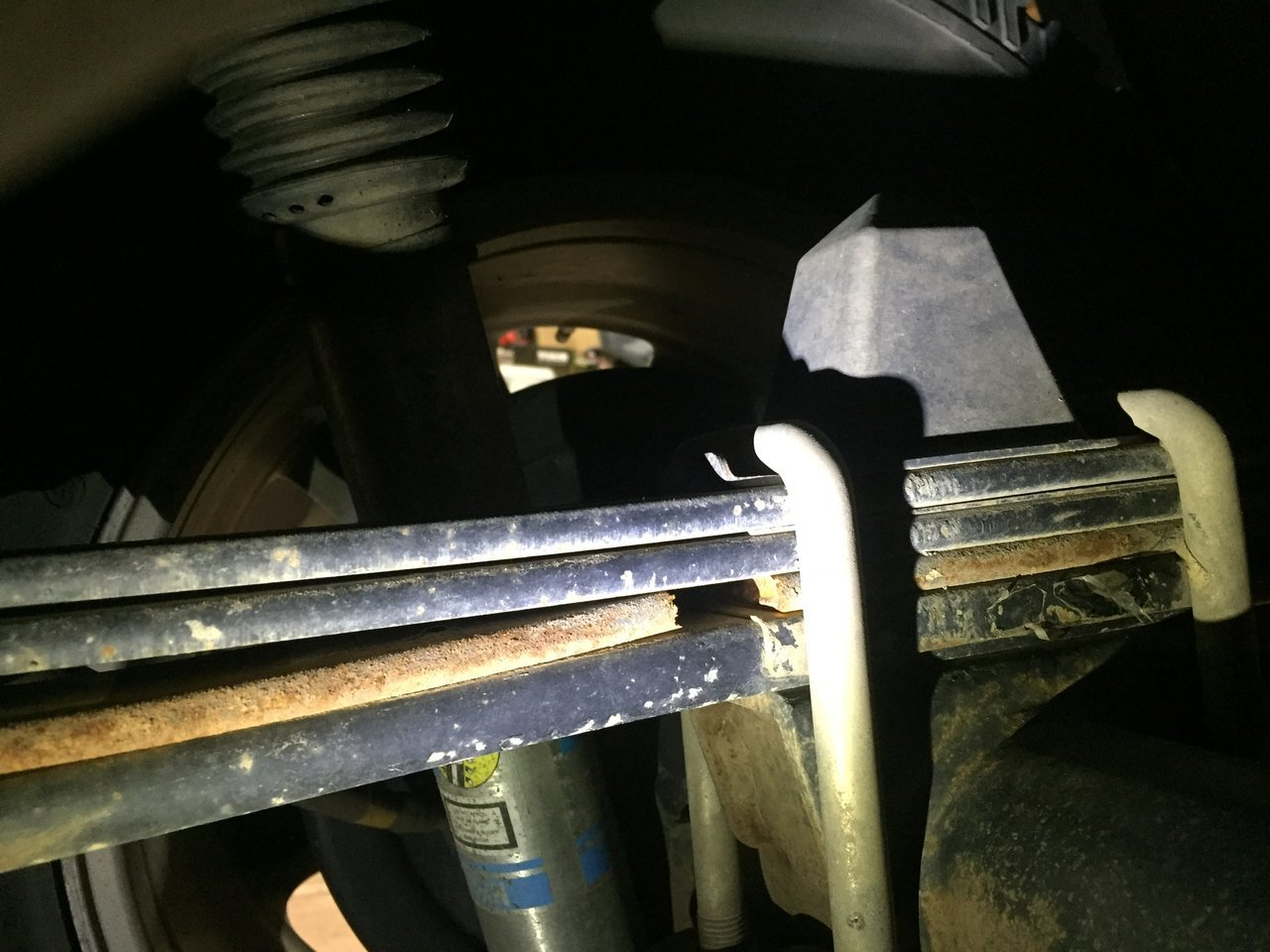

    My AAL lasted about two years.
    Wish I would have went Dakar's right off the bat.
