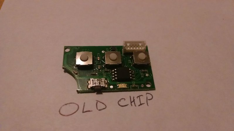

    Here is my key's old V.1 Chip

    Range. The V.2 chip has a major advantage in terms of range. With the V.1 chip, my FOB's range was roughly 20-30ft (length of my driveway). The new chip works at a much greater range, was easily working at 50 feet and at that point I was across the street and in my neighbor's yard. If I find the time, I might do some more testing in the future to see if this is simply better contact with the battery or some other variable, but my guess is an improved antenna.
