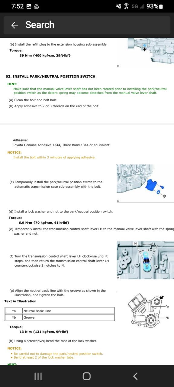

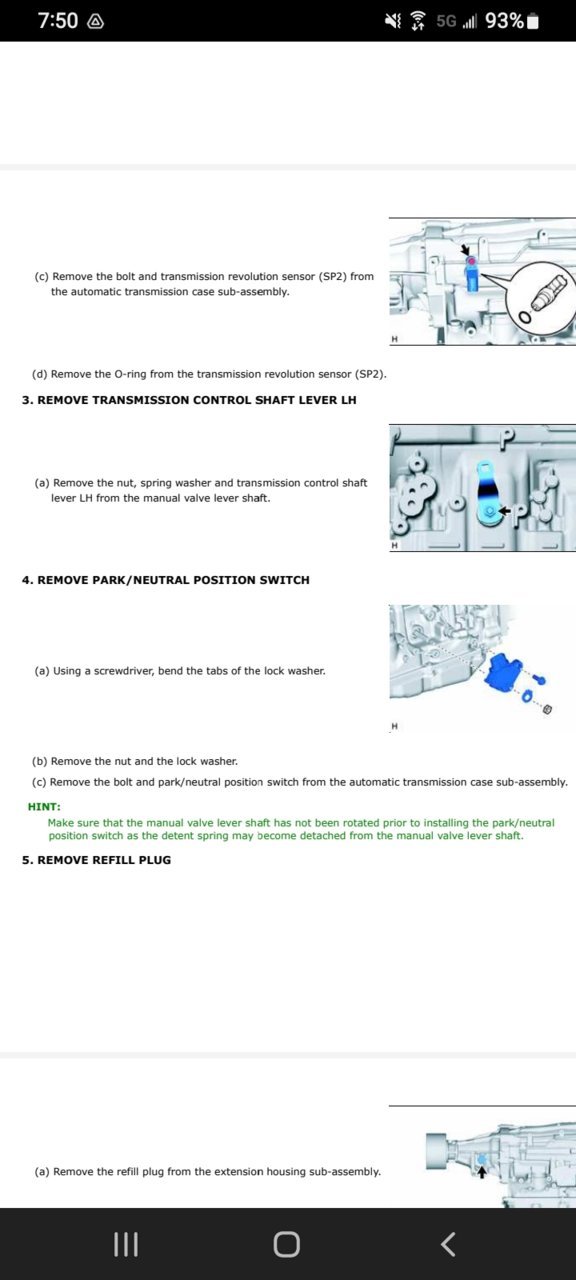

    Thank you! Where'd you find that I couldn't find anything for 3rd Gens. Dealer actually sent me a video of where it is I was just gonna pop it off and put the new one on.

  5. Feb 3, 2023 at 7:29 AM
