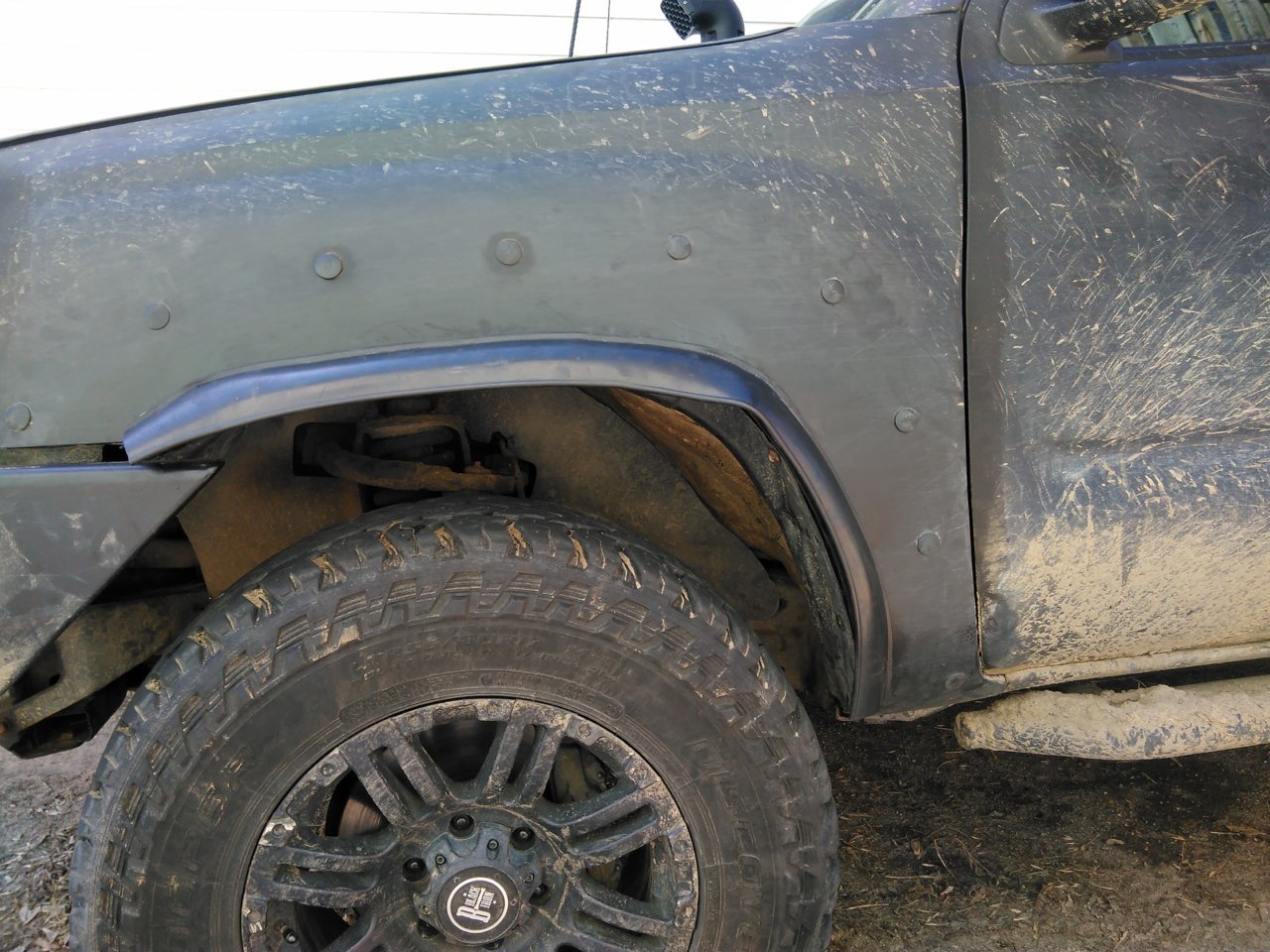

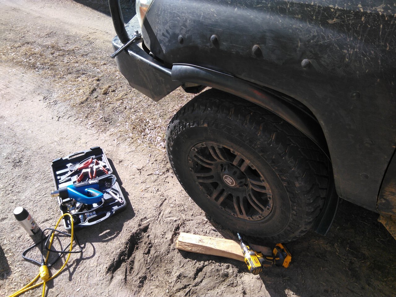

    Added some new Low Range off road flexy fender flares to the rig, they work really well. Super happy with them so far.
    I also learned that the hardest part of this operation is the inner fender liner push pins. That was until I got the correct tool. Now its no problem at all. I did the 1st one and struggled with out it. Bought the tool and waited until it arrived to do the passenger and it was a night and day difference in time and struggle required.

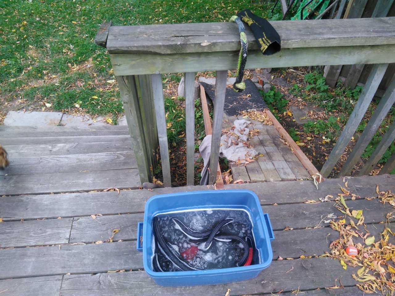

    Then no fun....:mad: Have to wash all that synthetic line stuffs

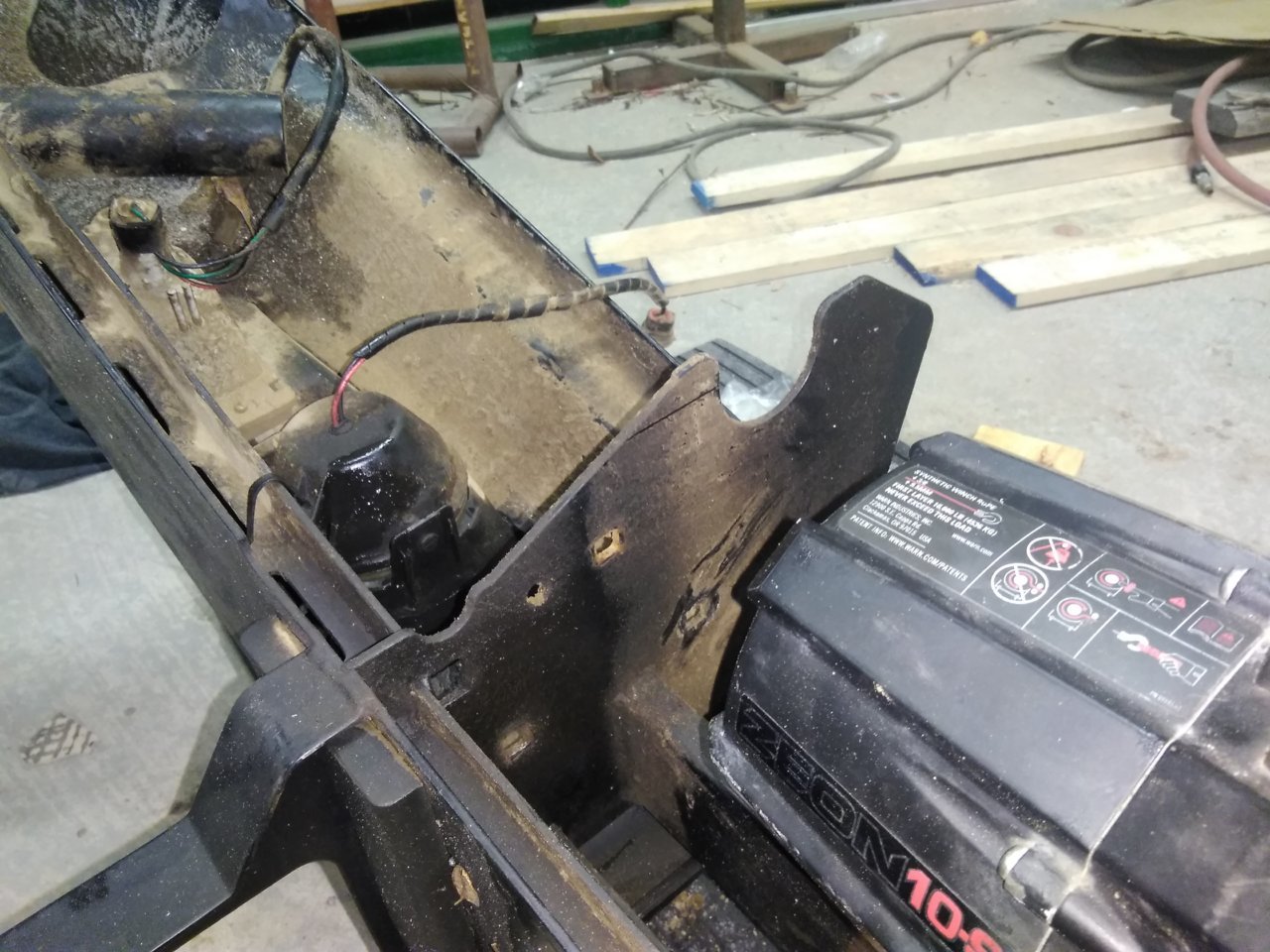

    Got the winch installed last night, only took about 6 hours :rofl:
    Had to slightly modifiy the selenoid casing to fit the box we wanted to mount it in.
    Then slice a small corner off the bumper so it did not contact the box.

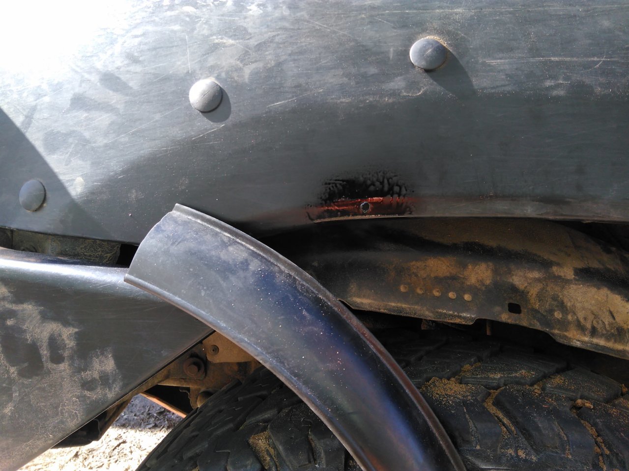

    Found some cracks on the front rad support area's of my truck, on both sides. Drilled a hole at the top most point of each crack to try and stop them from spreading. It is very thin gauge metal that is cracked, not really sure about this.

    Take a read through these thread:
    https://www.tacomaworld.com/threads/polyurethane-radiator-support-mounts-cab-also.361346/
    https://www.tacomaworld.com/threads...all-now-with-pictures-and-a-video-too.432885/
    Id look into replacing the two front core support bushings with the ones from the 8.4109G kit asap.

    Yea I did the radiator support bushings already. As described in that thread, 'Upside down' with the larger one on top.
    Guess I need to do the body mounts as well. :eek:

    Mine are cracked too....it’s the vibrations. The worst!
