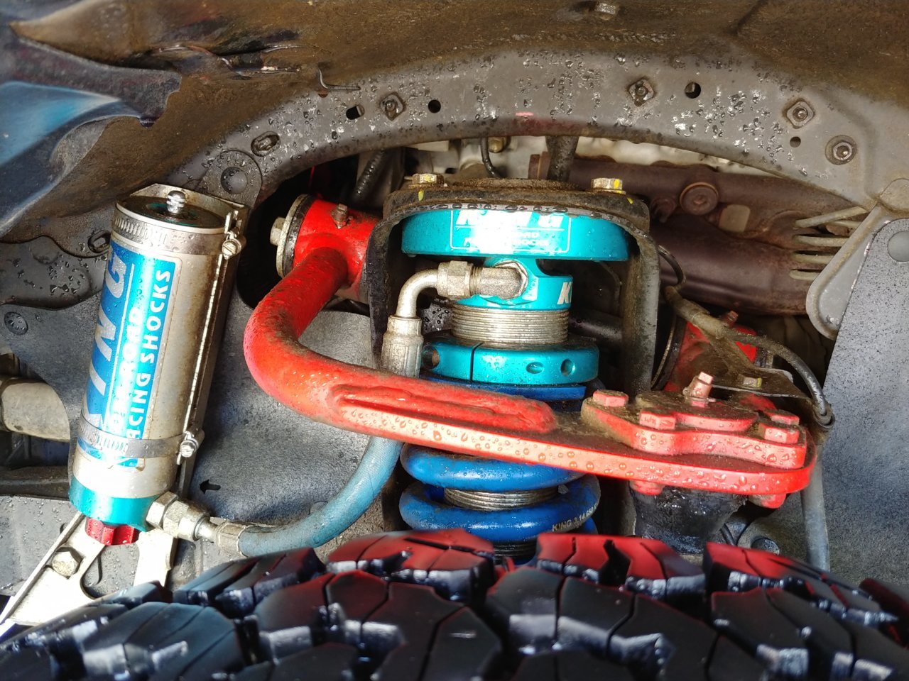

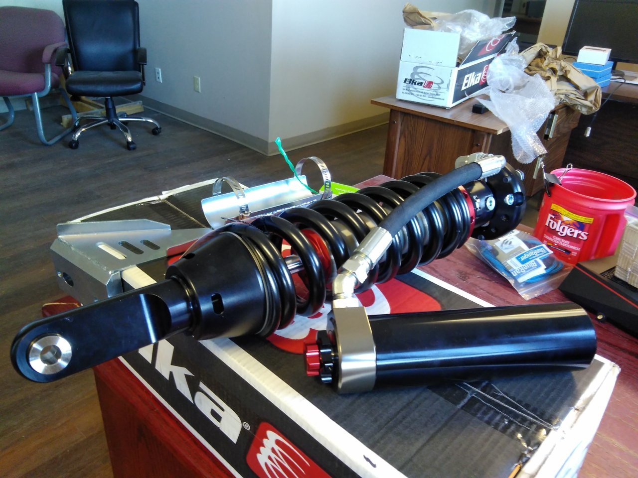

    Had to do the same thing with the brackets for my Kings. Its amazing how intrusive the ARB is compared to others haha. I cut mine out so it still maintains a portion of that rib and the structural rigidity. But I like the gusset you made.

    Thanks for the pic!
    We were wondering if it was a problem with the Elka bracket or what. Now I see its just the ARB getting in the way.
    :hattip:
    Jeremiah fixed it up so it had structure to it again, we were happy with how it turned out. I was over the top excited :bananadance:

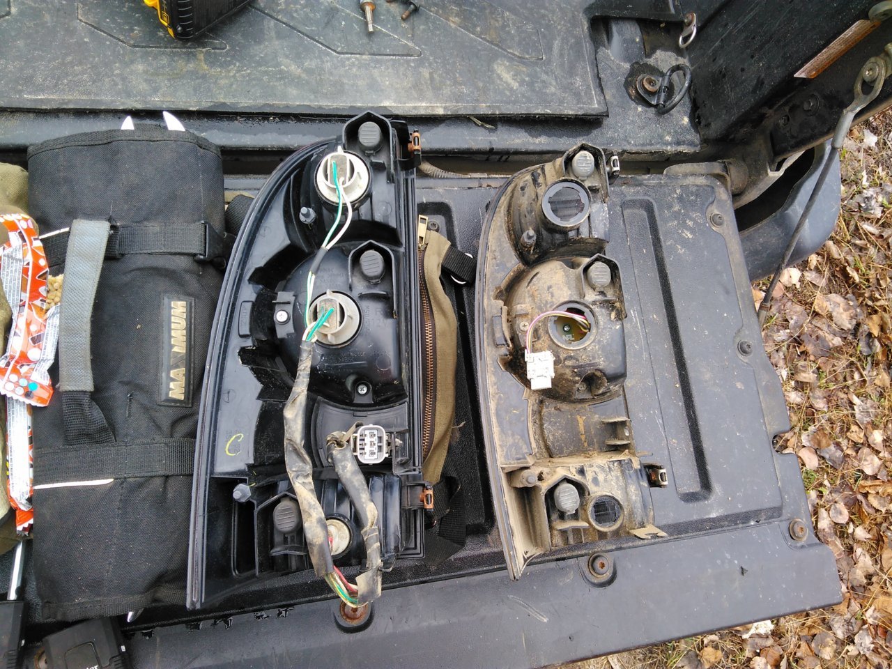

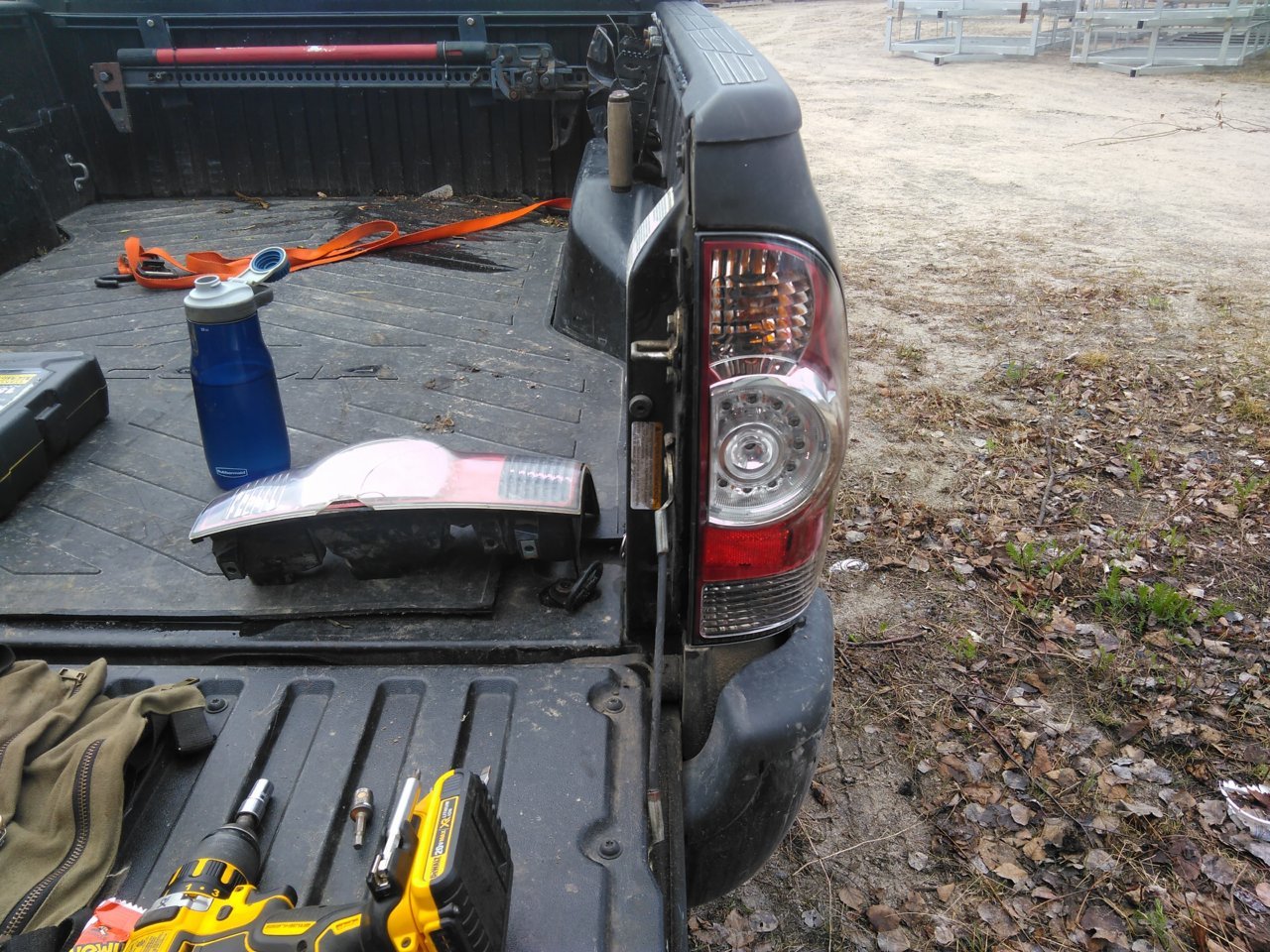

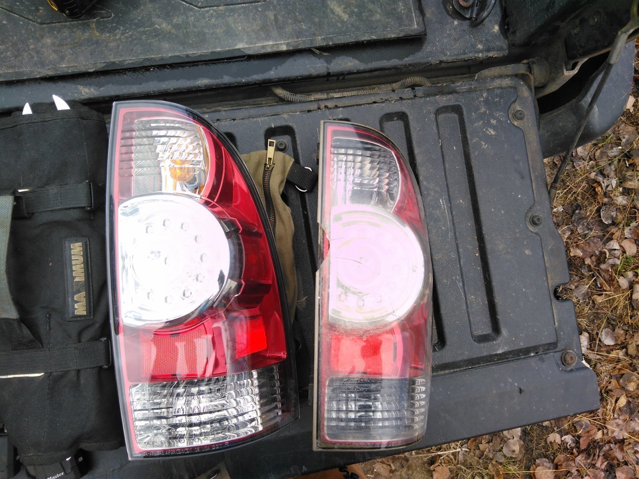

    Found the rear tail lights I got from @3JOH22A, decided it was time to replace the busted one. :rolleyes:

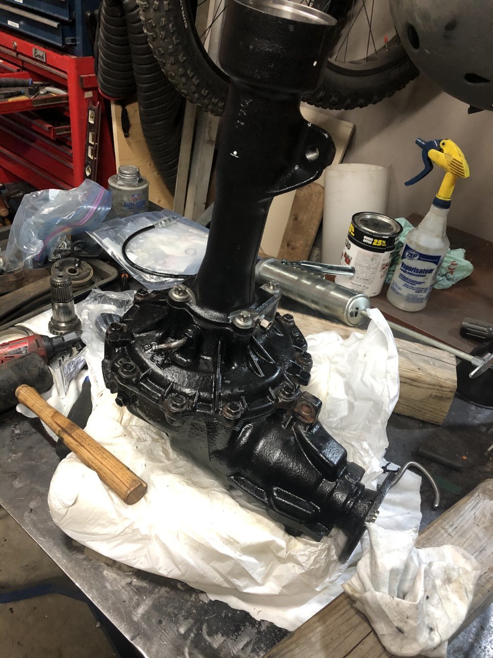

    @tacoma16 now that I did some reading, it is in the ADD delete thread
    1x – 4132135050 diff tube hosing from manual FJ cruiser $110
    :thumbsup:

    You need a few more parts then just that. I would recommend sourcing a manual front diff like @Windigo since the parts new are close to $1200 cnd. I had the pleasure of having to buy them twice.....
    you can also weld your stock tube keeping it engaged.
