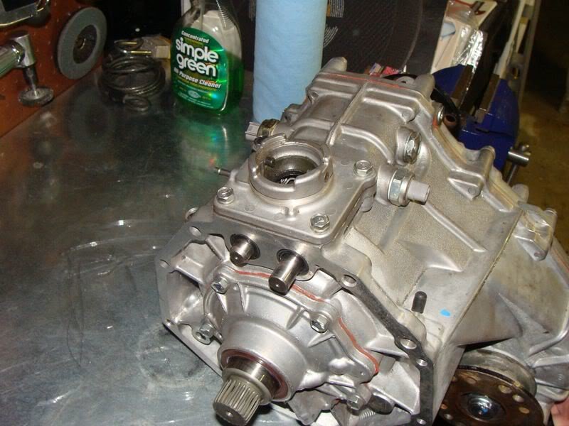

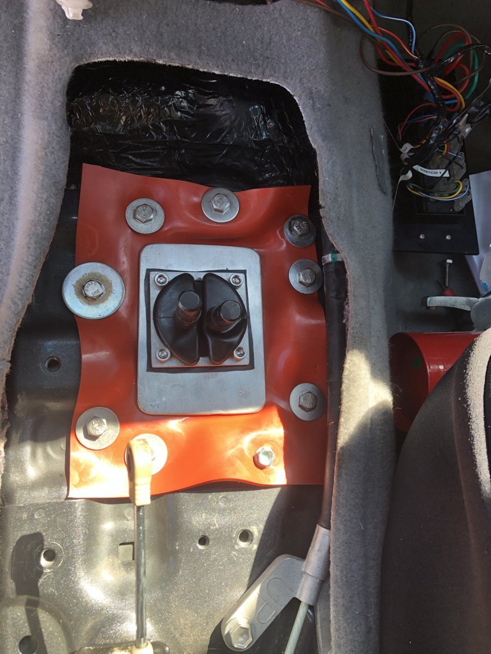

    Yeah that was the route I went. New everything as I didn’t think I was going to find a manual case. I even got a rebuild kit for the fj case too.
    as for the wiring you only require two sensors from your Tacoma case. You will need to plug a third in the fj case. These go to the wiring under the dash and directly to the dash lights so it all works as it should (I got my sensors mixed up so it was a matter of swapping the wires in the dash).
    this is the pic I used for sensors. I can’t remember if I payed attention to the sensor types which is why I got them mixed up and had to adjust my wiring under the dash.
    You will notice one of the holes is plugged. I used the drain bolt from my stock tcase for this.

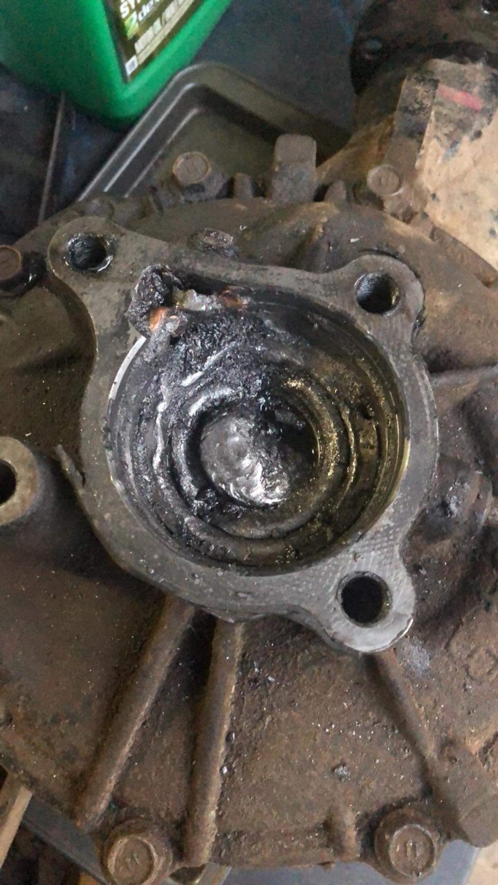

    That pic is from @tacoma16 fiasco with badness.
    I have not broken anything, just want to unnecessarily upgrade things. :rolleyes:

    Fiasco is right. Too much droop, cv popped, diff go boom. Torque loading is no joke.

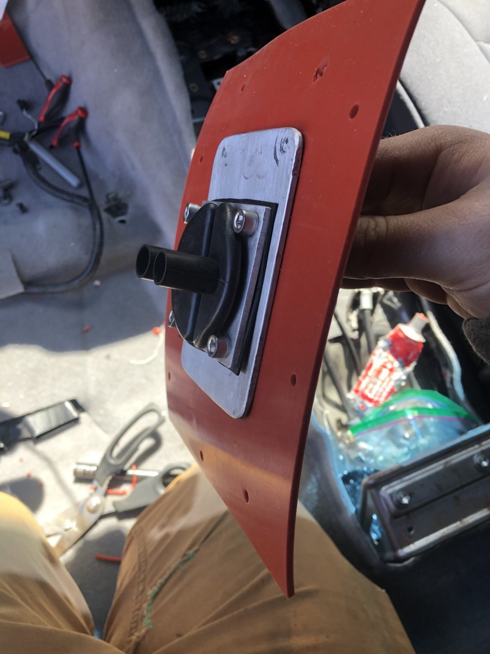

    No I made a new seal. The rubber boot around the shifter will come with yours. I made the aluminum plate and bought the red rubber off of Amazon.
