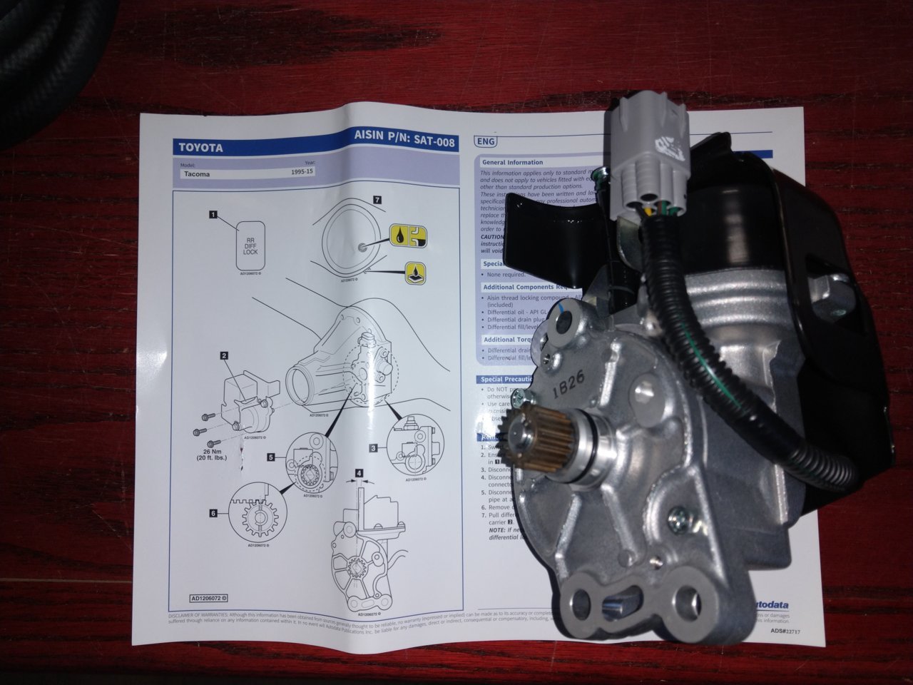

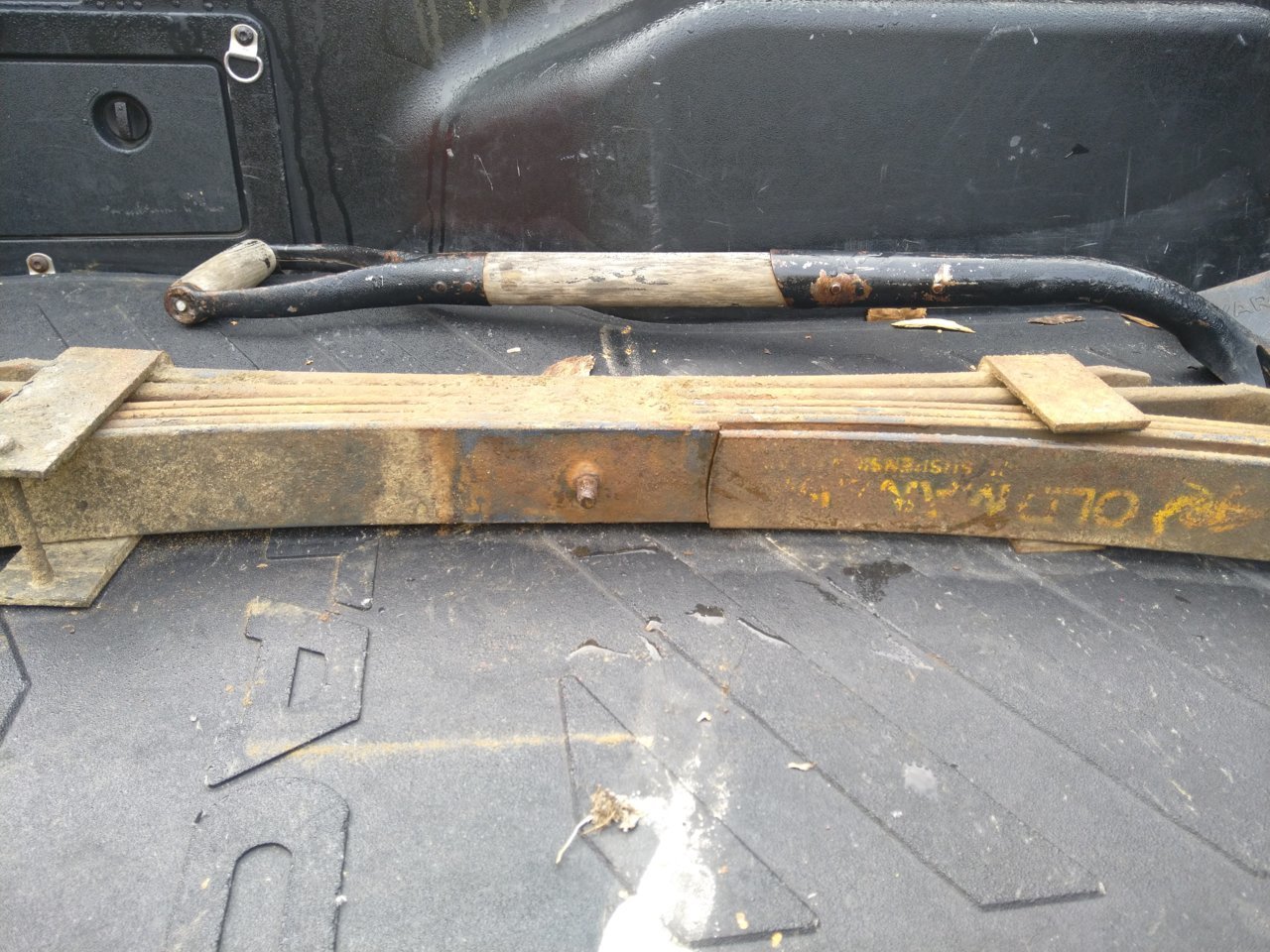

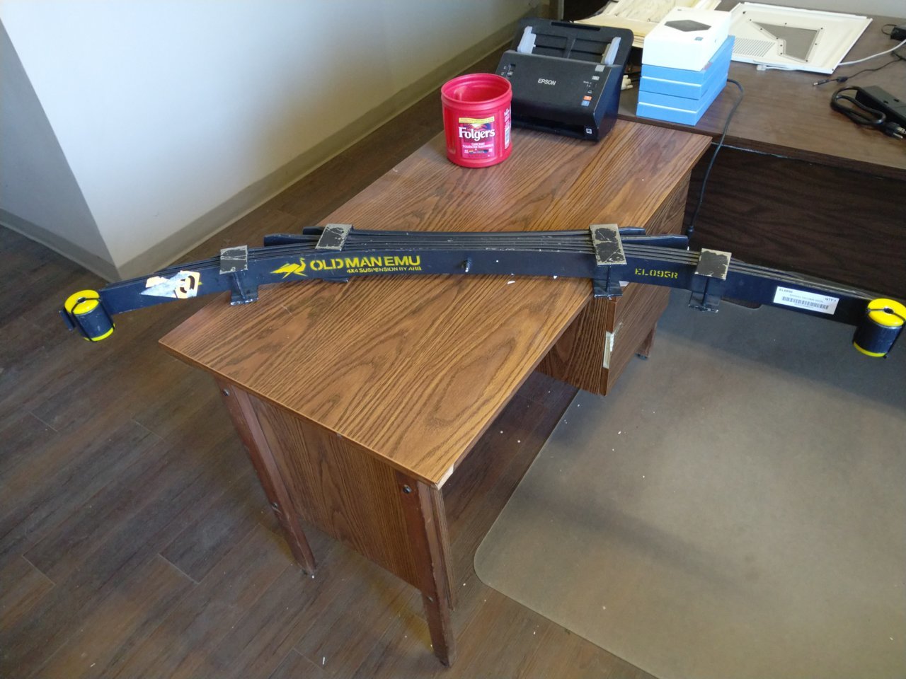

    While replacing the locker actuator :bananadead:
    We noticed that the passenger side top leaf was broken on my OME EL095R pack. :cookiemonster:
    All fixed, replaced with the exact same garbage. I will upgrade next time I have an issue with the leaf packs.

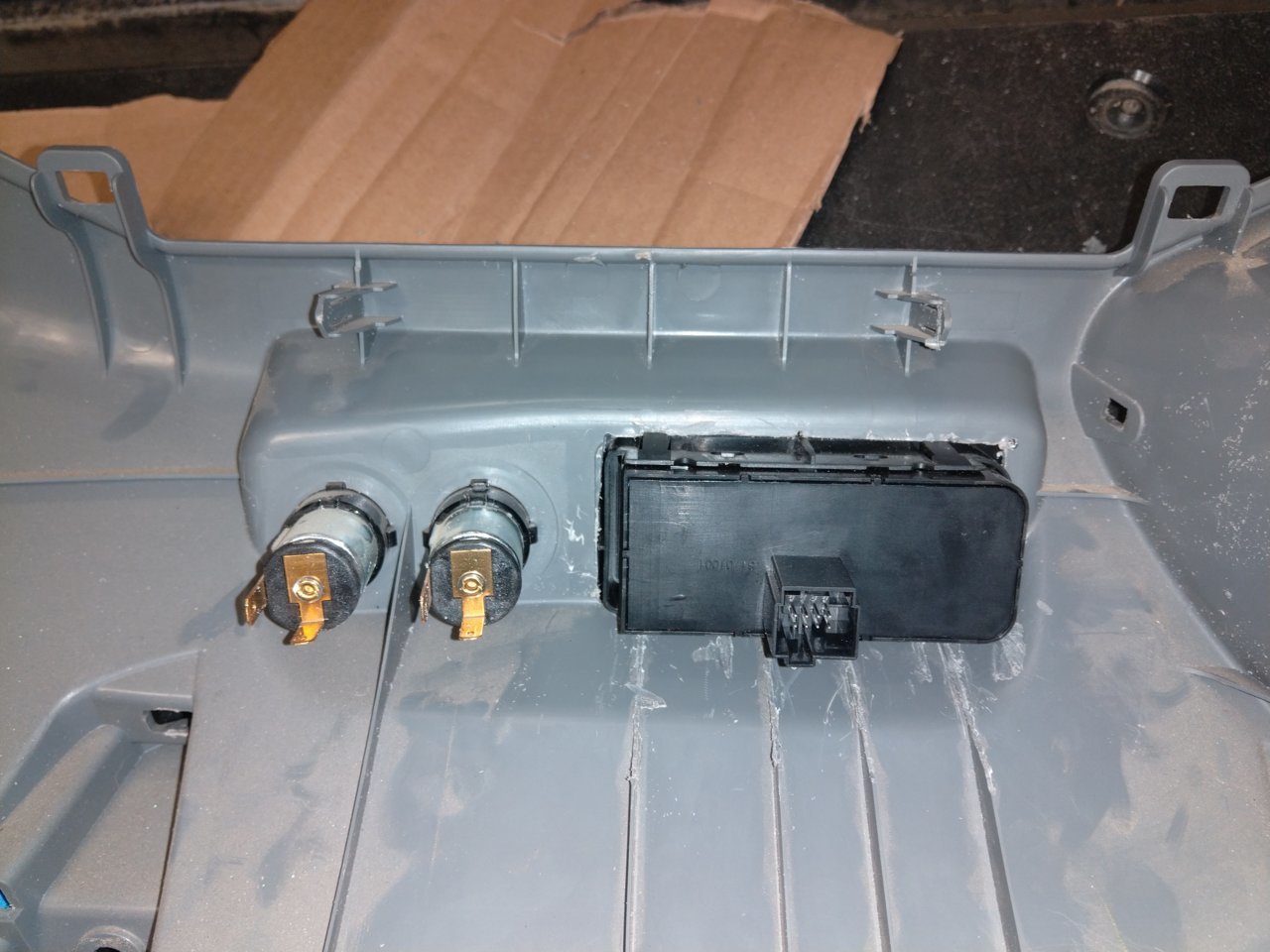

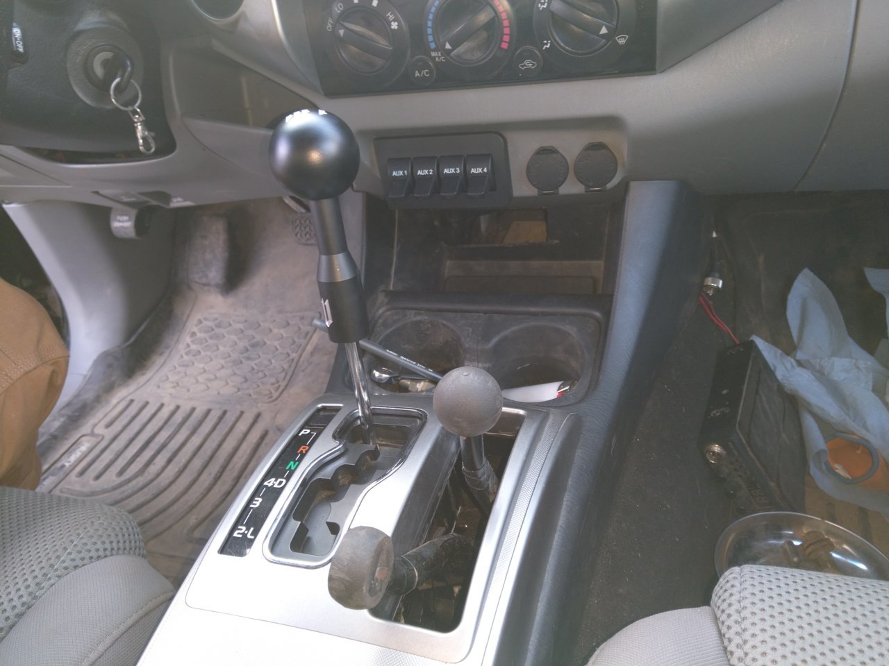

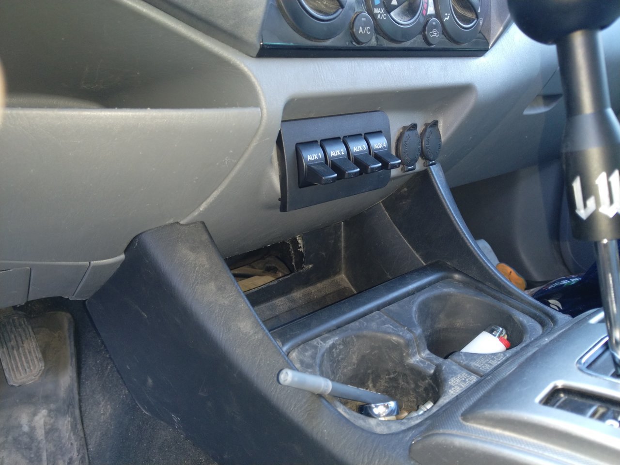

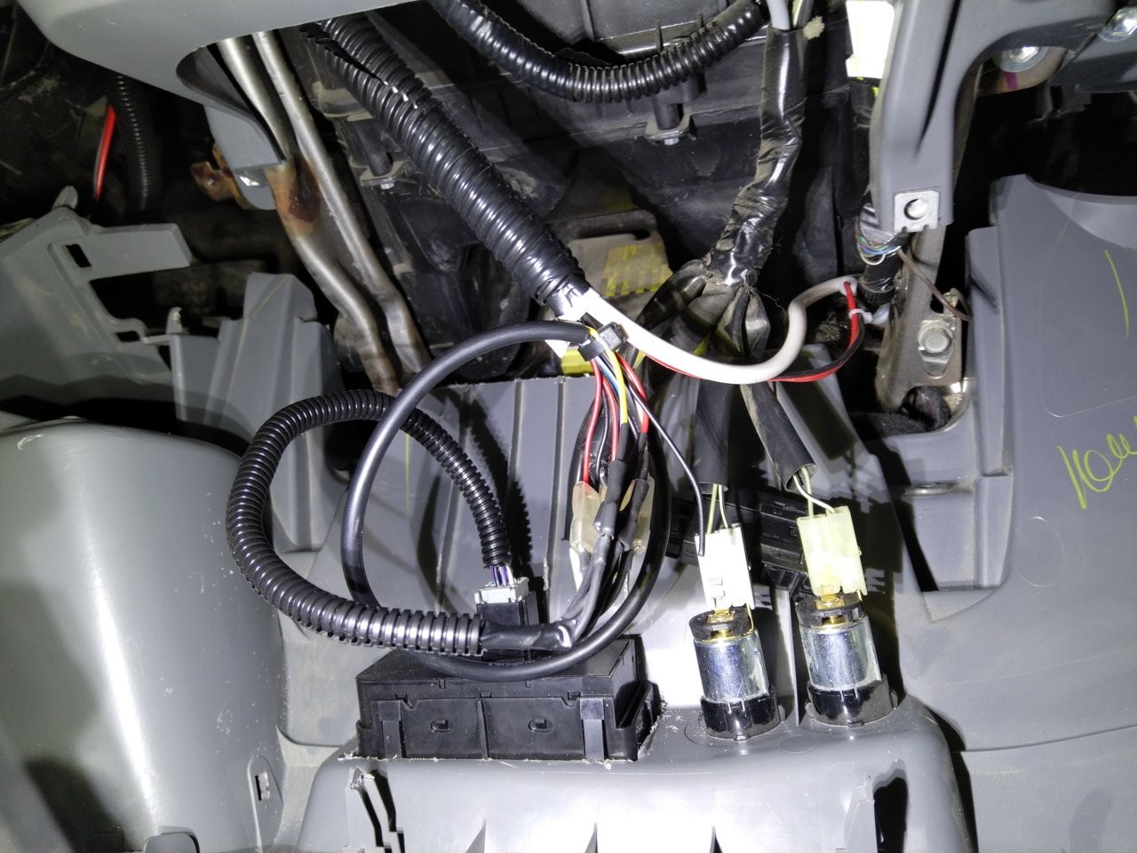

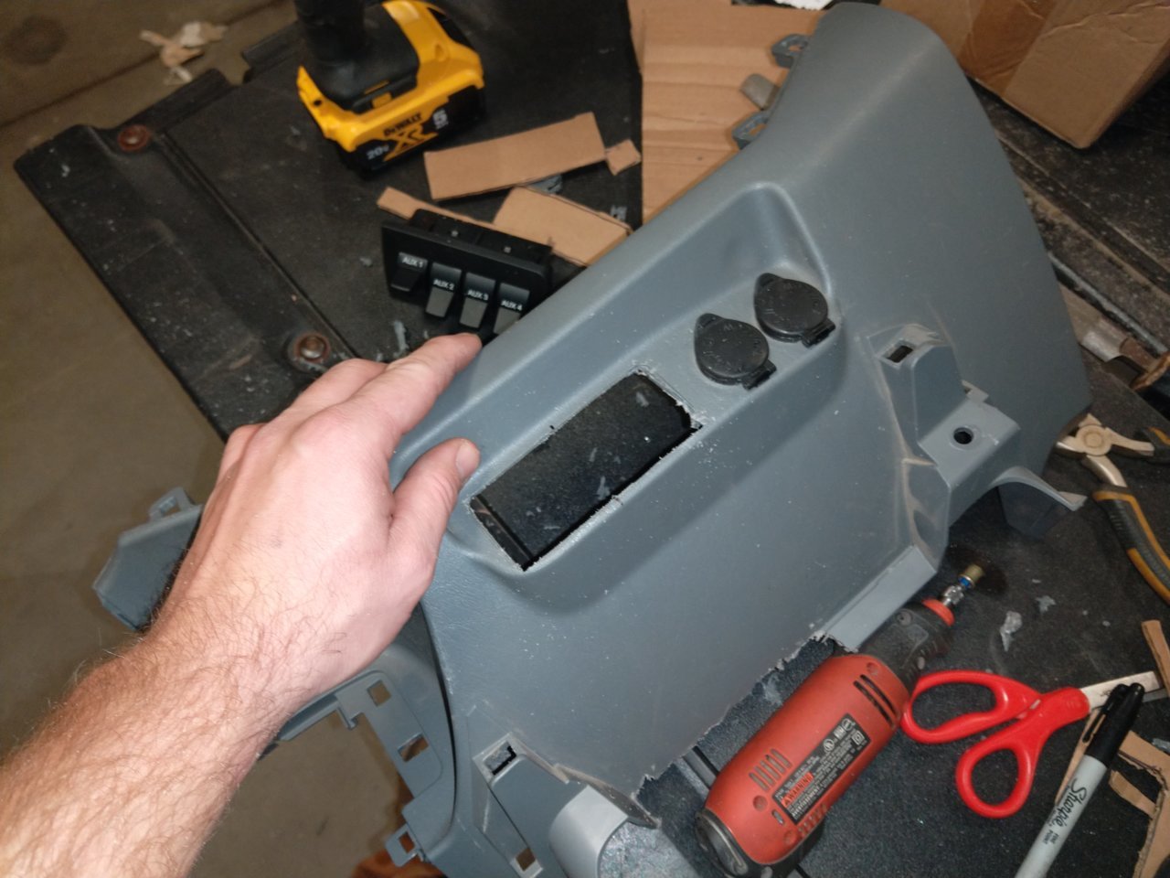

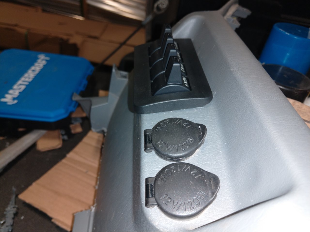

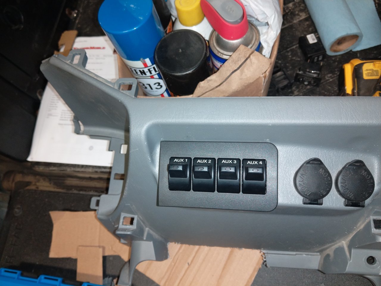

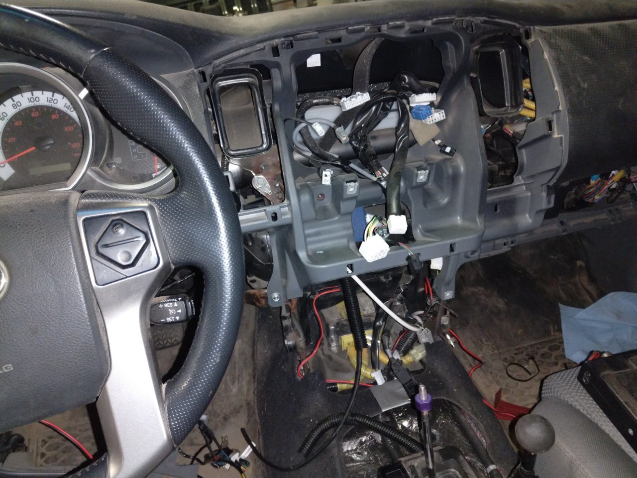

    Spent quite a few hours this weekend completing a project I have had on the back burner for awhile.
    Getting a 4 x switch bank from Ford installed in my truck for accessories.
    @TjAeCeOpMAmiah showed me how to correctly use corrugated tubing to run wires. Tried my best after he showed me to clean up all the wiring I had been ignoring under the dash area for the compressor and CB. It looks great now. Wiring is so time consuming with all the dissembly / re-assembly required.
    :sawzall:
    :transformer:

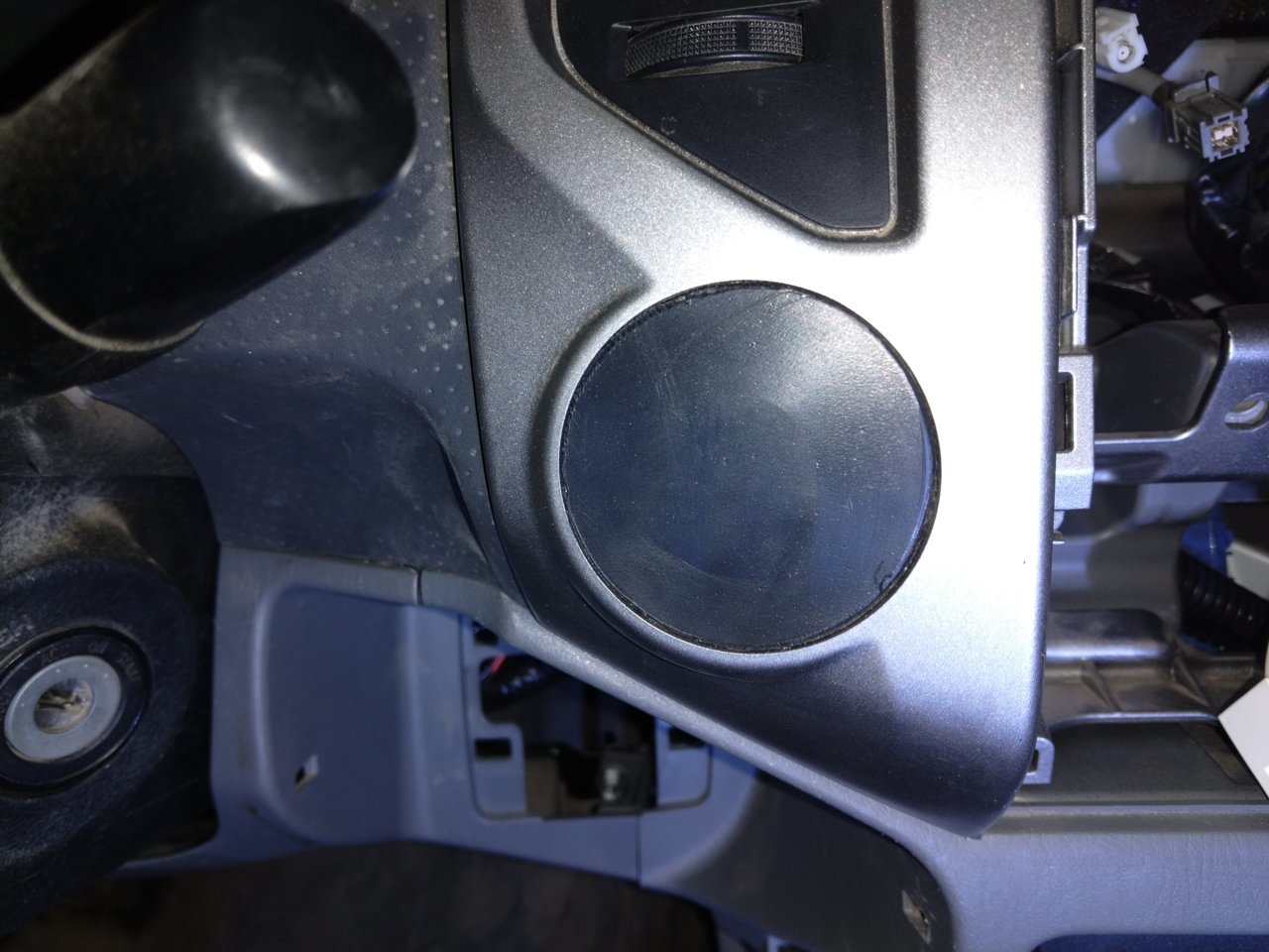

    Also put a blank plate in the 4hi 4lo switch spot. No more useless switch.

    Toronto Ontario Canada
    '14 Acess Cab
    Wow that looks minnt. and love the 4X switch plug

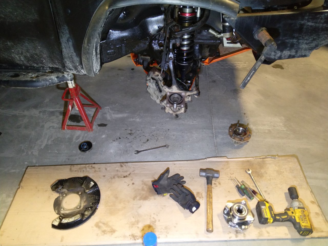

    More thought and investigation, we found the issue with my 'brakes'
    After wheeling hard a few weeks ago, it felt like the truck had a problem with the brakes. We bled them and ran through the Techstream fix for bleeding the system.
    It seemed like it worked at 1st, then it was back all of a sudden. Having the press the brake peddle really far sometimes, other times it was normal.
    :bananadead:
    Found the problem.
    Wheel bearing on the passenger side is toast. I always thought that if your wheel bearing was that bad, you would feel it in the steering wheel or something. Everything felt fine, except the brakes.
    :cookiemonster:
    Feels really good to to finally find the problem. :goingcrazy:
    Parts ordered to correct the problem on passenger side, and stay ahead of it on driver.

    Yep this was the problem with the brakes. Truck is all fixed! :cookiemonster:
    Did both the front bearings and hubs. Did not want to wait like 3 months and the driver side would be gone.
    We assembled the new hubs and bearings using a small 6 ton jack that @TjAeCeOpMAmiah has.
    Now I can take my old ones to a shop and have the bearings pressed out and reuse em!

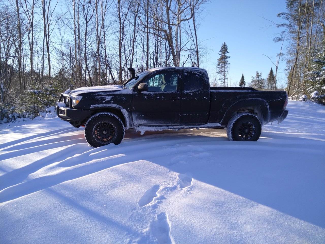

    It has begun!@
    Just enough to get some on my pants when I got in and out a few times on the run I did today. Next time hopefully I have to wear my gaiters.

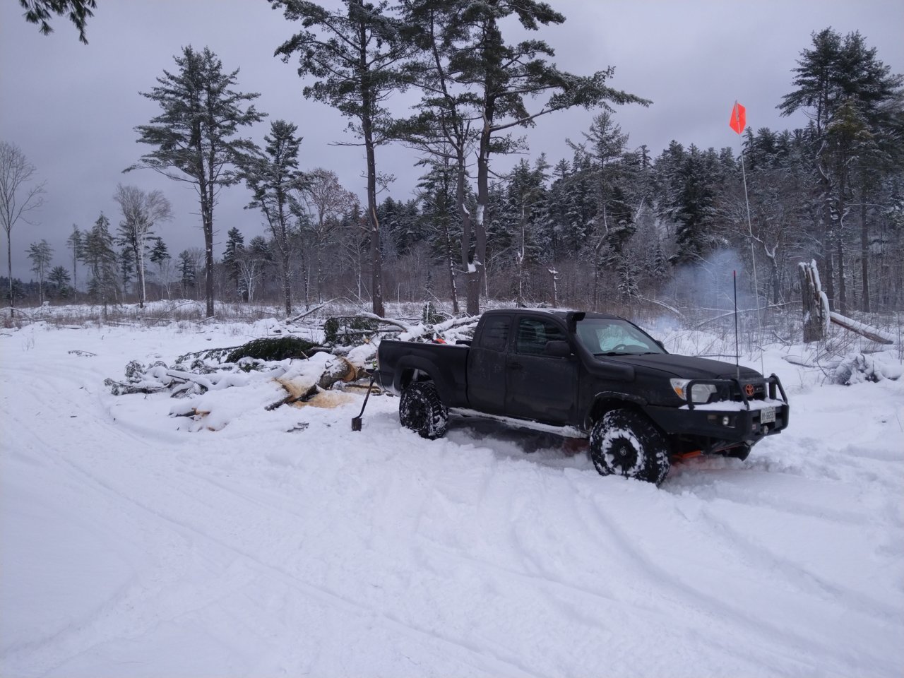

    Went out yesterday and did some trail clearing. :rolleyes:
    Planning on another trip or 2 this week for some more.

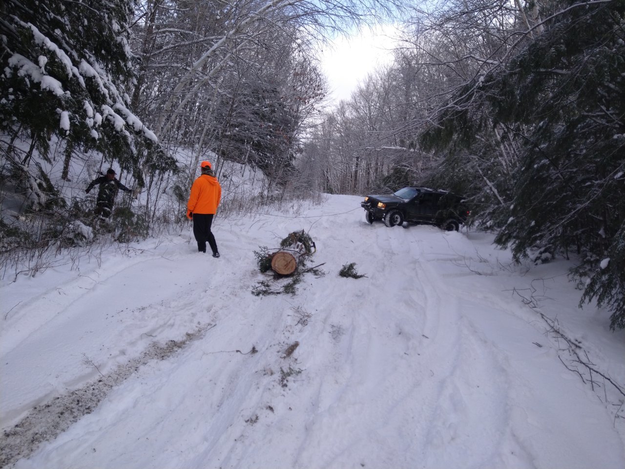

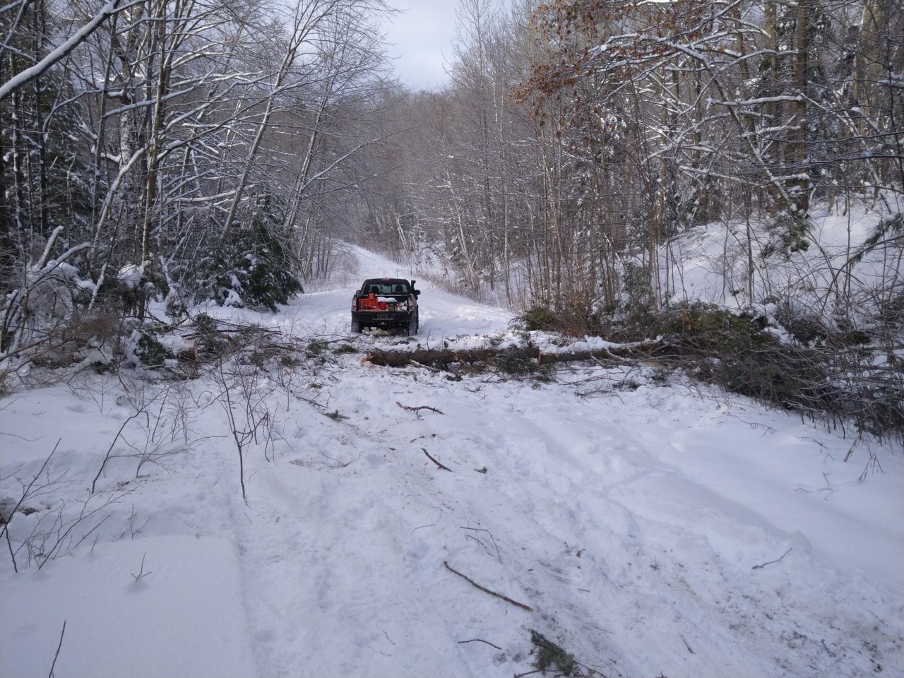

    Had a blast on a solo run today, using my truck as a skidder :cookiemonster:
    Just cleaning more trails, it is really needed at this time of year. I always enjoy doing this.
