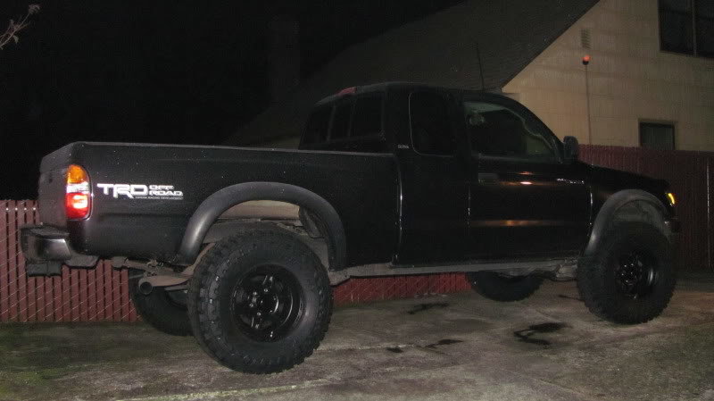

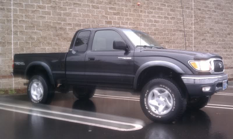

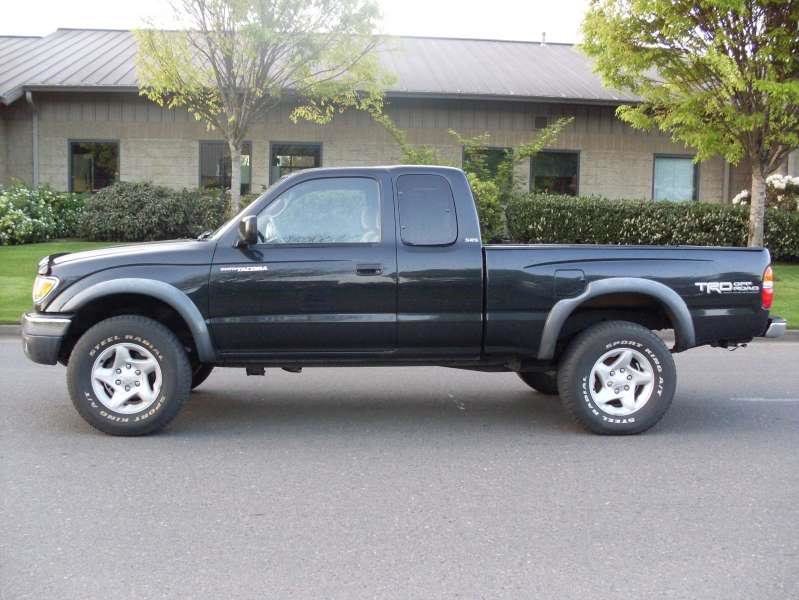

    if you're looking for a modest lift, ~3", and want to replace all the shocks, I would recommend going with Billstein 5100s and an add a leaf in the rear. The front shocks are pre-load height adjustable, meaning when before mounting the coil you can adjust the coil perch to three different heights, stock, ~1" lift, or ~2.5" lift, using the factory coil springs. The add a leaf for the rear is an extra arched single leaf you add into the rear leaf pack for ~2" of lift. just installed this set up on my 02 Xtra cab, about 4 hours for the AAL and another 3-4 hours for the fronts. I did this install by myself, with handtools, and help of only a rack of my favorite beer. Turned out great, and fit 285/75/R16s Toyo M/Ts (a 33" tire). For about $400 total you can buy the 5100s from downsouthmotorsports.com, the AALs from toytectlifts.com as well as a new bushing set for the front shocks as they are not included with the shocks sold from downsouthmotorsports, but for the price you can not beat it.
    Cheapest option, less than most any coil spacer kits which would have a metal or polyurethane spacer which mounts on top of the factory coils and blocks for the rear lift.
    Sounds like you're in the same boat as I was, wanting a moderate lift at a good price, needing new shocks all the way around. I can't say how pleased I am with the new ride of the truck. Stiffens up the factory suspension perfectly to lift the truck and improve the ride.
    STOCK HEIGHT
    WITH THE LIFT
    AND NEW TIRES/WHEELS

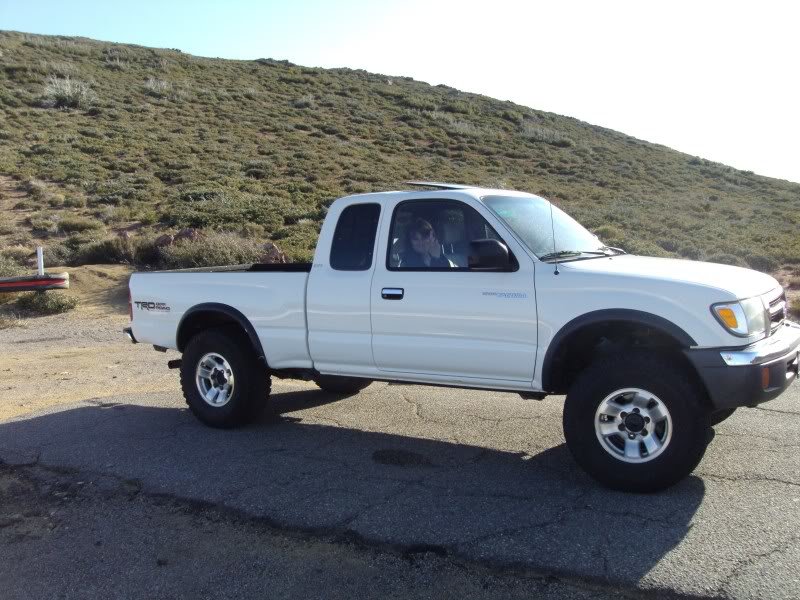

    If you're looking for 2"-3", I'd go with 5100's set up front (set to 2.5") and a 2" AAL in the back.
    Before:
    After:

    Thanks man. You got a sharp looking truck - those black rims really pull it together.
    The 5100's and AAL are great. Rides and handles real well

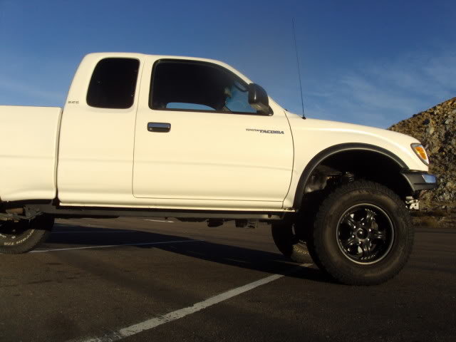

    Before 5100 install..... basically stock height
    After 1st gen Tundra adjustable 5100's in front on stock coils
    now have 5100's all corners w/stock rear leafs stock front coils
