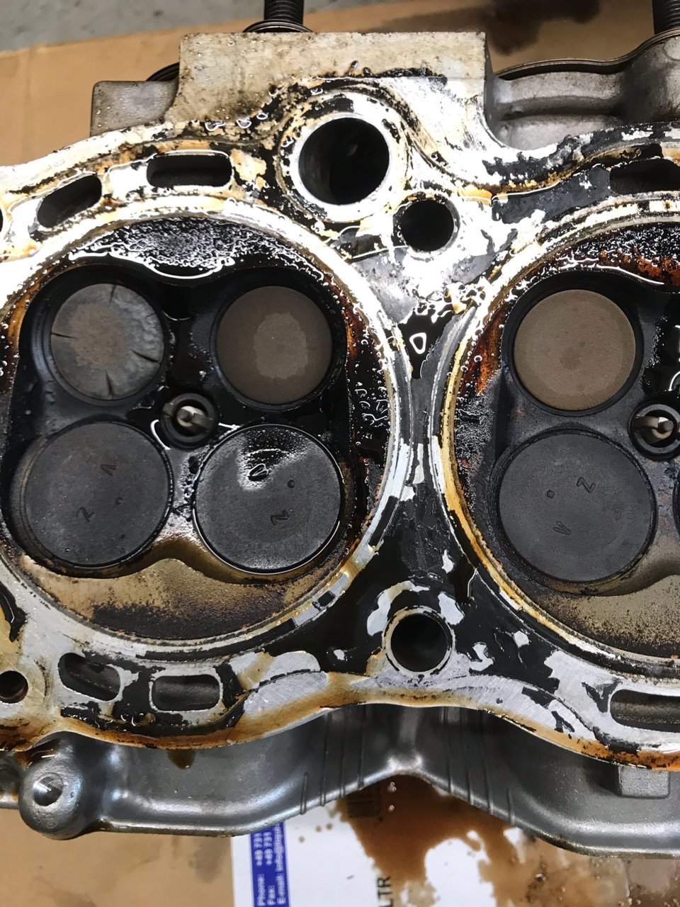

    Thanks for the replies. Mechanic did a leakdown test and determined it was an exhaust valve problem. Pulled the head and found the culprit: IMG_9097.jpg

    Oooh that is one unhappy valve. What are they recommending for repair?
