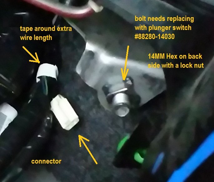

    My base model is wired.
    The clutch disengage switch is Toyota part number: 88280-14030 and costs about $25 whether you get it from them, Amazon or eBay.
    It replaces the stop bolt which needs a 14MM wrench or socket and has a lock nut, unseen behind the steel plate in the picture.
    The wire connector has enough length to reach the switch. There is a piece of tape holding the extra length.
    I ordered the control wand from eBay for $10 (China). Toyota wants $177. This is where China's ability to copy really works in our favor.
