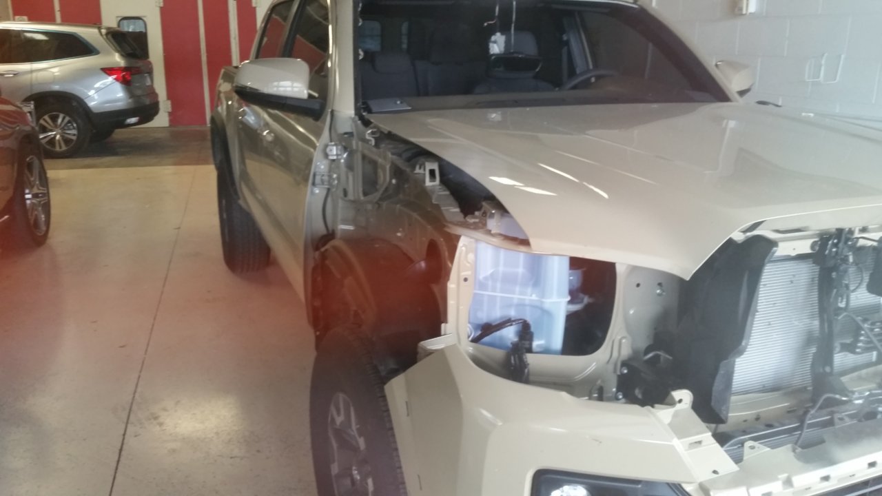

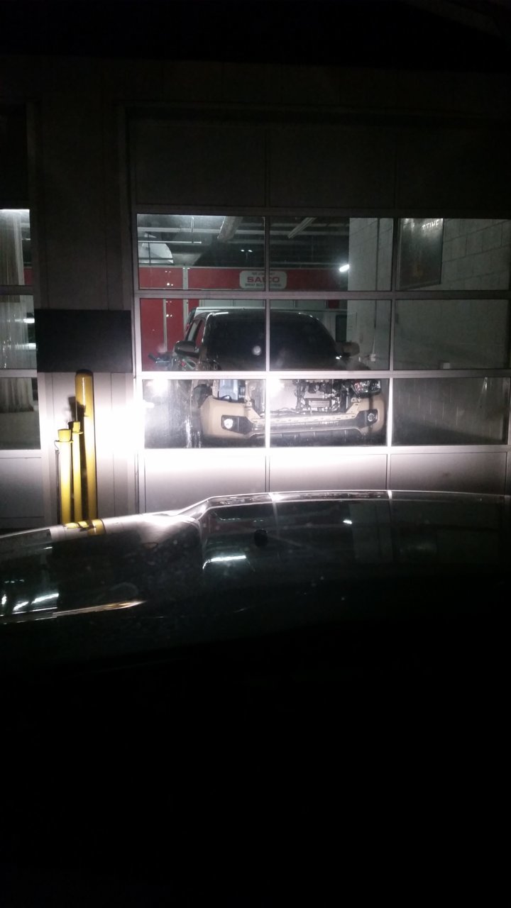

  14. May 28, 2018 at 9:02 AM
    #134
    Utfan1
    Utfan1 [OP] Well-Known Member
    Jul 12, 2016
    #191893
    110
    Day 22. Truck still sits in the same spot with no windshield, removed front right qtr, grill gone and the entire bumper loose and lowered . No interior and roof cluster hanging down .
