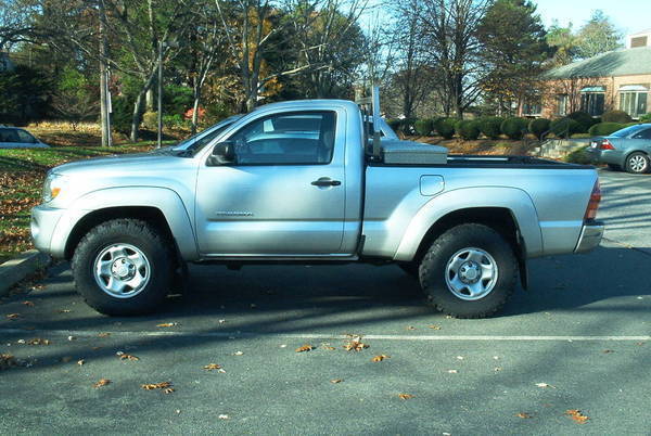

    Here is the truck, no lift, riding on 265/75-16s

    Thats a pretty bad ass truck ya got there bud...I liek the tires. Stick w/ the Billy 5100s and you'll be gold!

    Eh... You're truck looks pretty sharp as is. If there's no rubbing or other need for a lift. I'd say skip it and invest in some armor.

    If that were my truck I'd pop for the 5100's and set them at .85 to level the truck.
