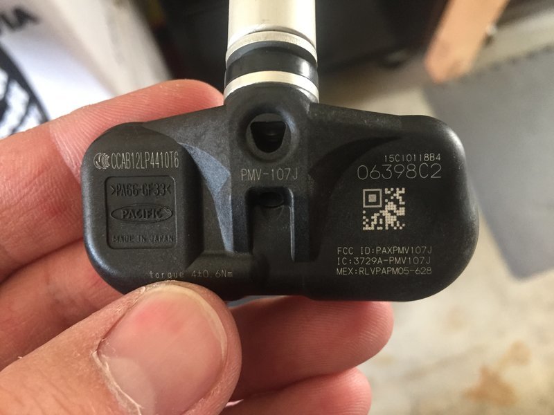

  15. Mar 19, 2017 at 7:06 AM

    Thank you all that contributed to this thread. I will be buying the 17" TRD Alloy wheels soon as well for my 2007 Tacoma and realize that I will need new TPMS that is compatible. Based on post #14 above, PMV-107J is required however noticed that there are the digits 3729A listed in front of PMV-107J on the bottom, right of the TPMS.
    When I try to look up that part number, all of the results I receive are listed as 42607-33021 PMV-107J. Before ordering, I'm trying to understand the difference, if any. Obviously at the end of the day, I want the TPMS to be compatible with the truck so will await clarification before buying.
