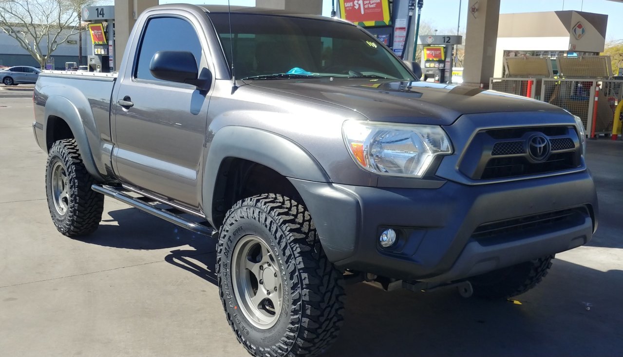

    I had my new wheels installed at Discount Tire. They didn't even question me, which I was kind of expecting. They just took the stock sensors off my steel wheels and put them in my new wheels. Been running them for over a year without any issues. Maybe you need a different tire dealer that isn't looking to pad their sale by selling items you don't need?
