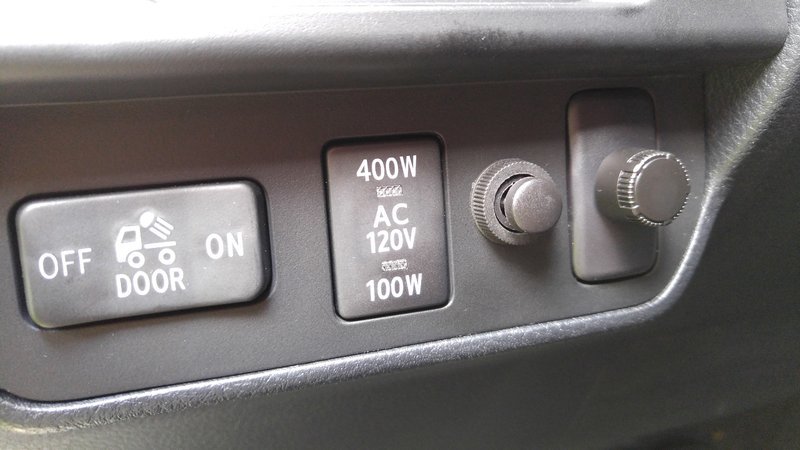

    Sorry, no good pics as everything is tucked away under the seat. I was, however, pretty pleased with the way my bass knob turned out. I also gutted my garage door clicker and soldered a momentary switch to the contacts. Now I can just press the button to the left of the bass knob to open the garage.
