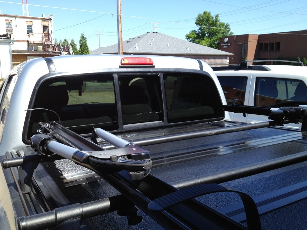

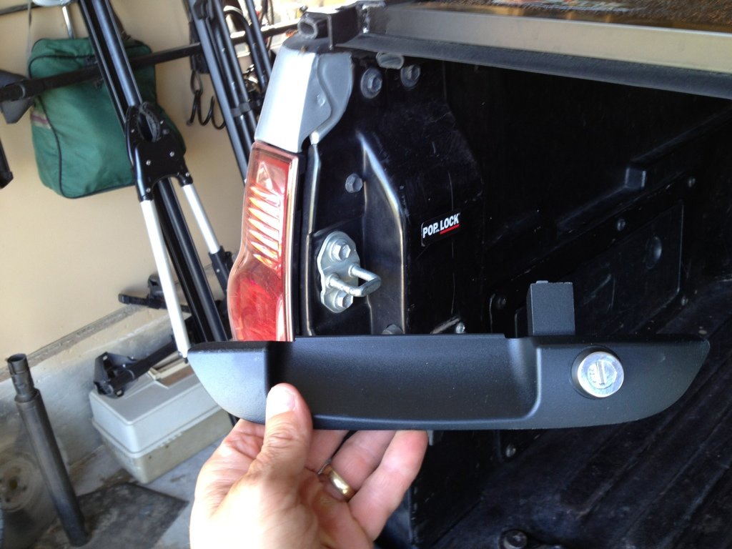

    Yep PopNLock ftw, snap to install. BakFlip works perfect under my Yakima rack setup.

    Where is the yakima rack bolted to? Hard to see small pic on my phone.

    I removed the bed rail covers and installed Yakima tracks with Plusnuts. I used thin flashing and gorilla glue to cover factory sheet metal holes and then taped off and bedlined. This way I'll be able to knock out the covers and return to factory setup easily and add tracks to next Taco.
    Plusnuts work awesome and very easy BTW.
    The top pic you can see a round projection from the rear of the bedrail. The BakFlip is obviously made to use in conjunction with factory plastic rail covers so I had a big gap along the edge after install. To fix this I cut some old air compressor hose (black rubber) and tucked along edge and helps seal and looks great too.

    Airun, do you have the rear backup camera on your truck? I was wondering if the PopNLock can be used with vehicles that have the camera.

    I have a poplock for mine with the backup camera. the only difference was the camera is on the right with pop and lock and it was on the left with the orginal.
