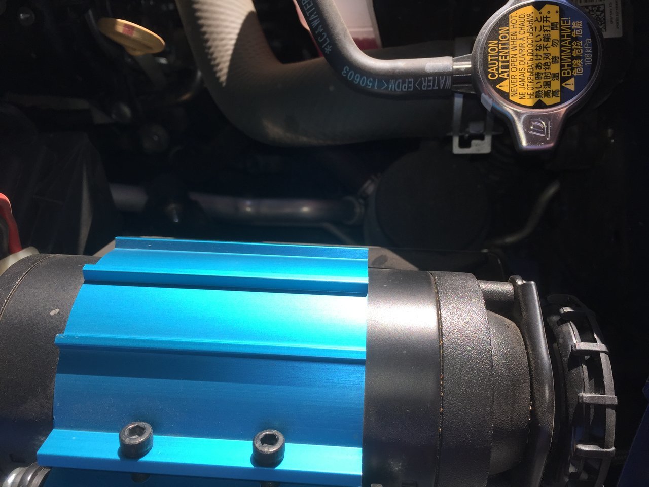

    Gentlemen------I have a 2017 off road and note that there is a power steering reservoir in the general location of where the ARB compressor would mount. Which compressor is being mounted here? The single or double? Also------If the power steering reservoir is indeed in the way where are you relocating it?

    This bracket is for the twin compressor only (I think Slee also makes a mount for the single in this location). This mod simply adapts Slee's kit to work on the 3rd Gen Tacoma. Relocation of the PS reservoir is part of the Slee mounting kit... You can follow the links above and view Slee's installation instructions.

    OK. I understand. I did look at their instructions and I believe I see what you mean about the PS reservoir being moved to the right. I also went outside and looked at my truck. I noticed that there is what appears to be some kind of ac line running past the engine side of the nice opening that the compressor fits into down at the bottom. And there is a fitting with an electrical connector attached to that line that sticks up at a 45 degree angle into what I figure is where the compressor will want to go. What did you do about that? Bend it out of the way? Do you have some more pictures of your installation? A picture is worth a 1000 words as they say.

    Hard to get a picture down there with my phone, but here you go. The compressor mounts along side those hoses & connectors, but none of them get moved/bent out of the way for the compressor install. What you can't see in the picture is that the compressor is up a couple inches on its mount, so there is more room than it seems down there where the hoses are... It looks tighter than it is. Things are close, but there is a gap all around the compressor.
