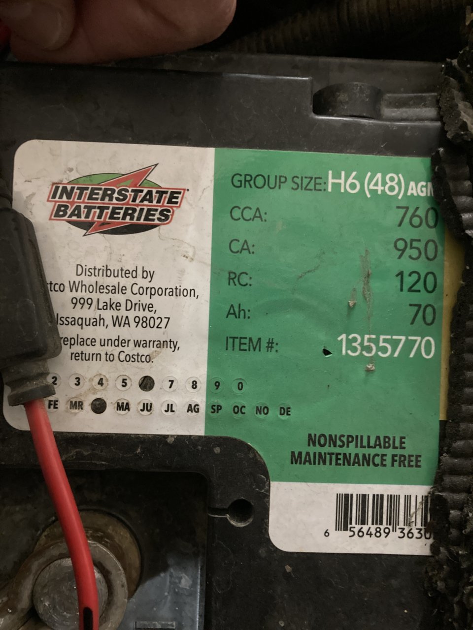

    You could do an interstate AGM from Costco for $94. It’s not a 24f, but it will fit with slight modding.

    Good luck finding an AGM for $94.
    Without a link to this mystery battery, I call BS!

    Ok. Could have been $97. Whatever. It was under $100. That was 6 months ago though.
    Boise Costco. Idaho
    I’ll take a pic after I get out of the tub :D

    Im out now. Cold in the garage....
    notice this is not a 24F

    @9th - You got lucky, or Costco got screwed by their employee - pick one, or both. The lead-acid battery is $99 the AGM right beneath it is $159. Either way - good on ya man - that's a fantastic price for an AGM!
