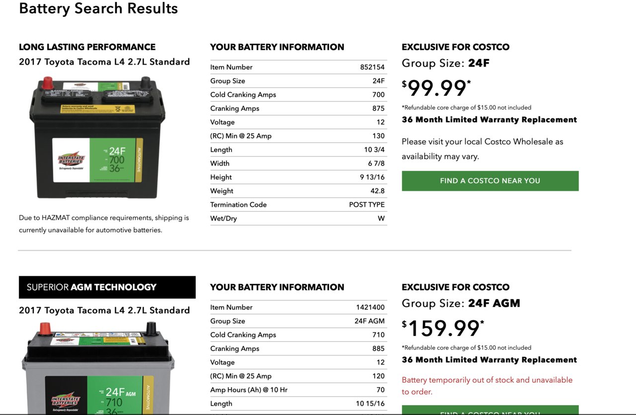

    yes, but the one I bought wasn’t a 24F. And, I confirmed with the guy at Costco behind the counter and he said that is the normal price. If you are a Costco member, you typically get lower prices than what is online to the public.
    One thing to keep in mind is that the stock alternator settings won’t charge and AGM to its fullest so you either need to trickle charge once in a while, or tune the alt settings (which I did)
