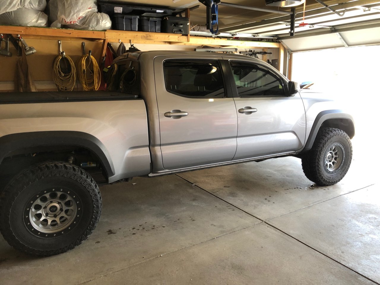

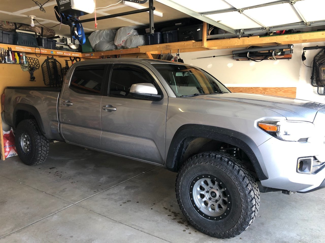

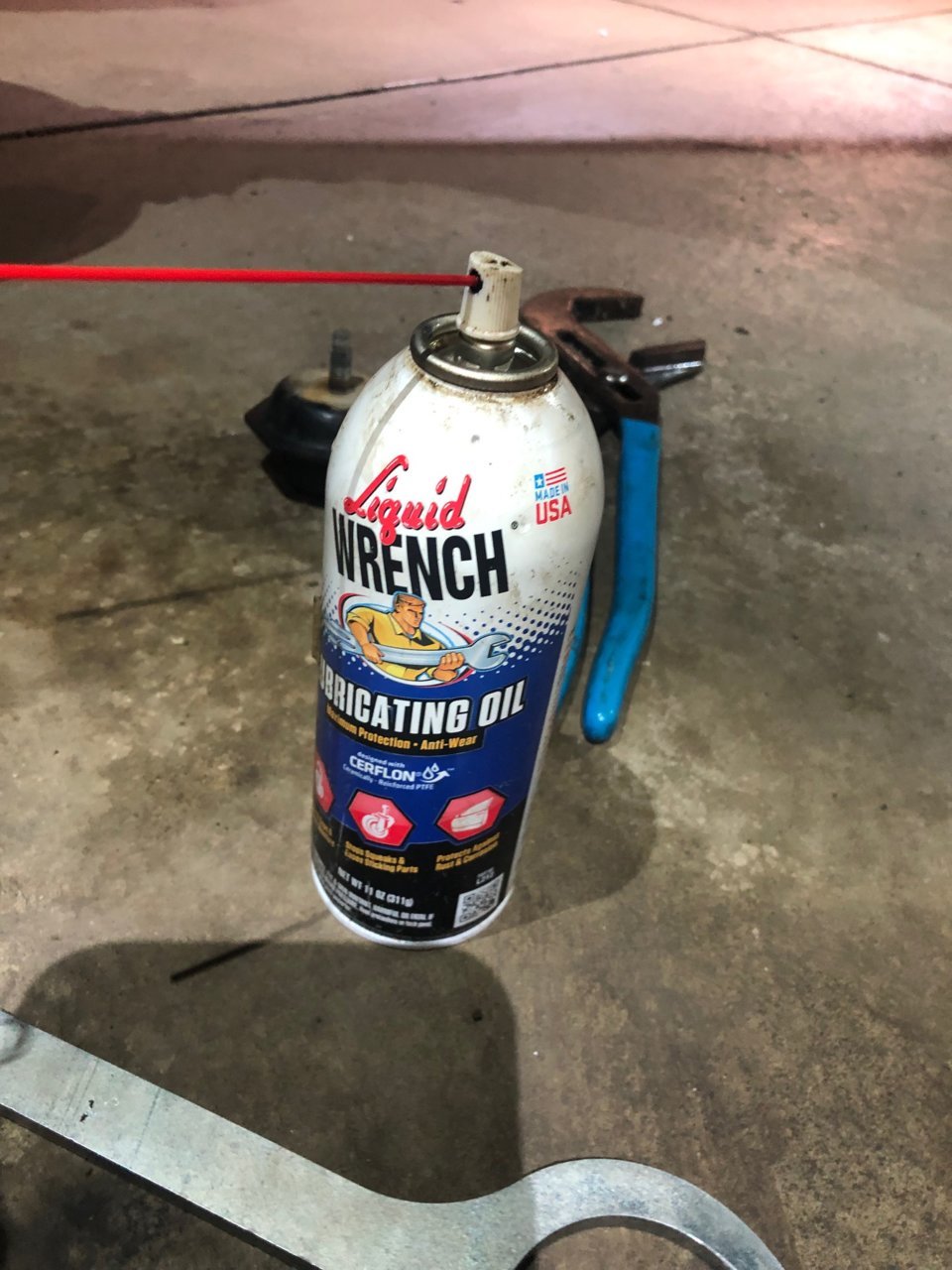

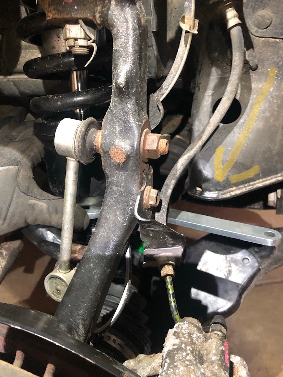

    So im gonna share a little info for those interested. Bare with me im not a seasoned writer. Heres a little info on my truck for people that are on the fence about 8100's.
    2017 Tacoma DCLB Offroad.
    Cooper St Maxx 255/85 r16
    Stealth Custom Series Ray 10's
    Deaver Aal without overload.
    Firestone Airbags with cradles.
    Spc light racing uca's
    Bilstein 8112's
    Bilstein 8100's
    Measurements fender to hub;
    Drivers Front: 22.25"
    Passenger Front; 22.50"
    Driver Rear; 23.50"
    Passenger Rear; 23.50"
    Measurements fender to ground;
    Driver Front; 37.75"
    Passenger Front; 38.00"
    Driver Rear; 38.50"
    Passenger Rear; 38.50"
    I had to crank up the drivers coilover for lean. Drivers thread measurement is 1 3/8" and the passenger is 1" from the bottom of the locking collar to the silver ring at the bottom of the threads.
    I found if you remove the bumpstop it gave more room to rotate the spring perch. I also used a 2ft hollow tube as a breaker bar.
    I used this to lube the threads
    As far as the rears go I unscrewed the values 2-3 turns, on both compression and rebound and it softened up the rear a bit. I probably gonna soften it a bit more.
    Im really pleased with the ride so far, im on e rated tires and still the ride is very nice. It looks like the drivers coilover is about topper out, so if you were gonna do a bumper and winch I would look into heavier coils.
    Alignment went fine wheel is centered back to front @ 3.0 caster 0 for camber and toe.
    No offroad use yet but its coming.
    Just thought id share my experiences and findings, as I know how hard it to make a decision on suspension.
    Roaming__Taco, mgmdclb, daks and 3 others like this.
