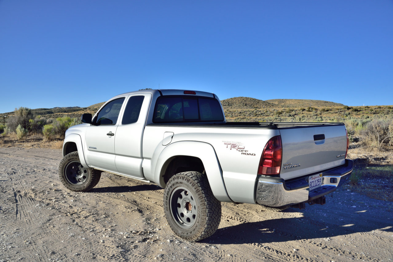

    OK, I've been rooting around here for a couple of weeks and an advertiser of mine asked me to do a Toyota project in TRAILS Magazine. I bought a 2006 Access Cab TRD OR and we're off to the races.
    The questions are these and excuse my poor search-fu if these have been answered and I couldn't find them.
    1) I see a lot about tires size increases but nothing about re-gearing the diffs. Do you re-gear or just shift down? Seems that the relative ratio change wouldn't be large but still advisable for max power but...? I'm running a 4.0/Auto.
    2) Is there a favorite compressor for airing up tires? Since it's going to be 33s or shorter, are there good single compressor versus the expense of a double ARB?
    3) Does any one make lighter swaybars, swaybar disconnects or something like a Currie Antirock? Do most just remove it? Trying to find the balance between cloverleaf on-ramp disaster and good flex on the trail.
    Thanks in advance, this has been a lot of fun so far.
    John
