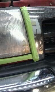

    Original headlights were a bit yellow after years, so I decided to get the 3M kit and polish them up a bit. A word to the wise. DO NOT,,I REPEAT,,DO NOT use a air powered die grinder with the cleaning kit. Use a elec drill.
    A air powered tool it waay to high speed for the sandpaper disks,,creates to much instant heat and smears the plastic dust that gets filed off right back onto the plastic. A new way to plastic weld,,if you will. the brown goober in the corner is what is left after a couple hrs of sanding, wiping, blowing off the disk, repeat, repeat, repeat. On my way this morning to the paint store to get some more disks because I still have some whirls and swirls left on the lense,,,Blahhh. It is probably so thin now that any pebbel will blast right thru it.

    I put some stuff called Wolfgang sealant back on,,supposedly good stuff.
    The body shop man told me that the UV coating is what turns yellow,,so now thats off of there. he said that just a regular car wax would work fine also for a coating.
    They did turn out just fine, and much brighter.
