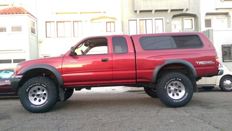

    The new Taco with a 3" lift and 33s...!

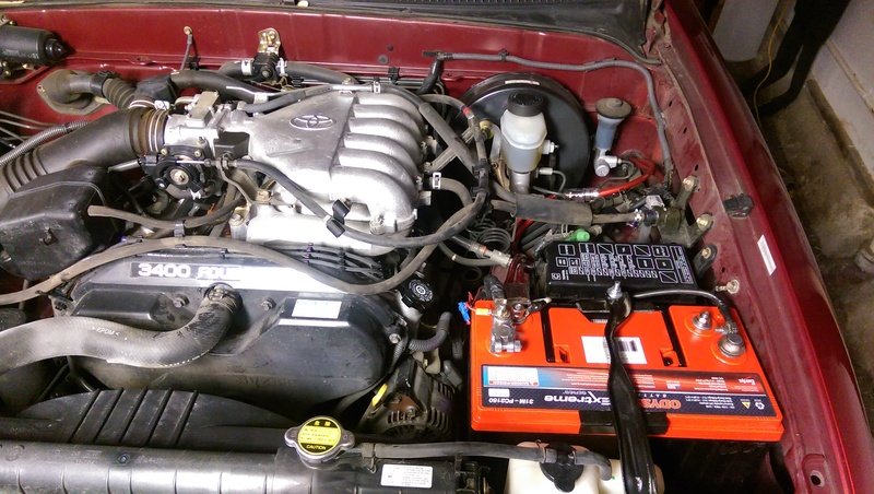

    A 31M battery in the factory location using the factor strap. Couldn't find a thread on whether is could be done. It can. Just needed a longer J hook for the strap.
