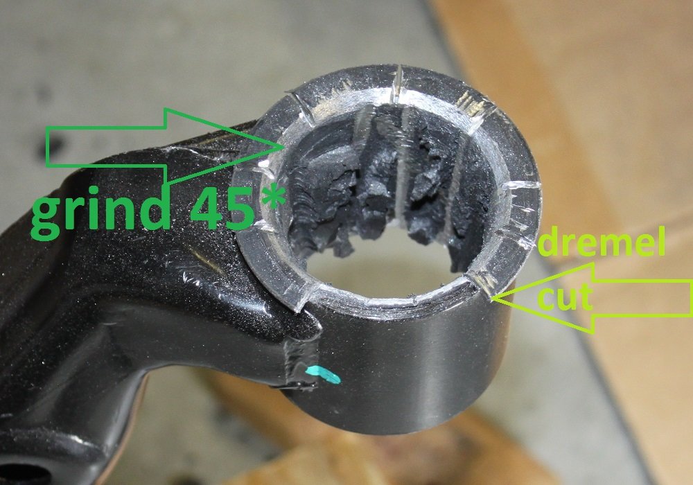

    Sorry to resurrect such an old thread but I'm changing my bushings out and was wondering if pressing them out is safer than cutting. I did notice a few folks cut into the bushing housing so anyone here had success with pressing?
  16. Mar 28, 2020 at 10:42 AM
    #156
    BackOff
    BackOff Well-Known Member
    Jun 19, 2018
    #256888
    310
    Derek
    The corner of Idiocracy and the Twilight Zone
    2004 SR5 4Runner V6 4x4
    Noise mods/Weight Mods
    Its a flanged bushing, prevents a normal press and the shape is a pain to deal with.
    If you grind a 45* to the inside edge, pie notch the top with dremel, fold flange.
    Then you can use a press.
    eatsleepstacos just used a sander disc and ground the flange off.

    Ok awesome picture....makes things much clearer. The new bushing (25476) eliminates that flanged type sleeve correct? The kit I purchased seems to be just a urethane bushing that sits inside the housing.
  18. Mar 28, 2020 at 11:40 AM
    #158
    BackOff
    Jun 19, 2018
    #256888
    310
    Derek
    The Spec-Ride? then yes.
    Is a newer style bushing too, beyond the Spec-Ride.
    That pic is a LCA but is the same as the UCA.
    I cut the SPC UCA a couple years ago doing this bushing replace.
    Messed with a set of LCAs for a Whiteline bushing install and realized i needed to get that flange out of the way.

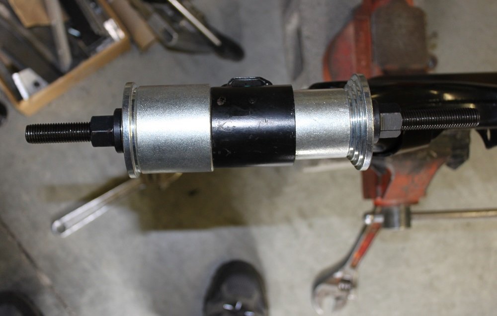

    Tools that helped...
