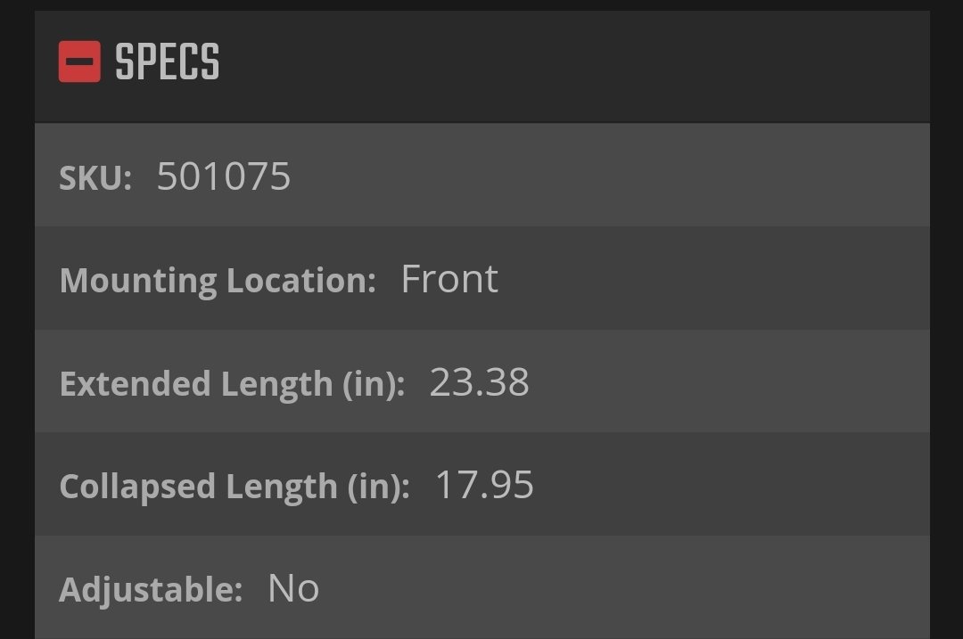

    Here are the specs

    I meant, what is the length and rating of the coil? Like, is it super stiff, so it gives a 2" lift to all Tacomas, but you feel potholes in your teeth?
    Or maybe they are softer springs, so it gives a different amount of lift for a reg cab, access cab, DCSB, and DCLB because they weigh different amounts.
    Your truck might only get 1" lift from those, or get the full 2" lift but are too stiff on the road. See what I mean?
    That's why Bilstein 5100's, and better fronts options like Fox, King, Icon, Elka, ADS, etc have adjustability.
    You will be stuck with whatever that Rough Country gives you out of the box.

    Oh ok, I got what your saying. I'm looking for the stock feel just with a lift. Wonder how I found out the info on the coil rating?
