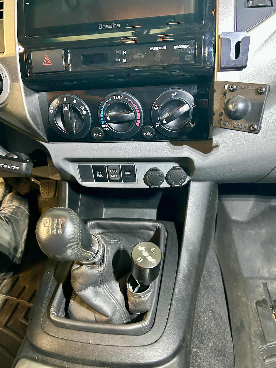

    All done, still need to finish the t-case skid plate. And it's still a little rough with the shift boot.
    Tyler with NWF has been a huge help with some issues I have been having. I am sure it's solved now.
