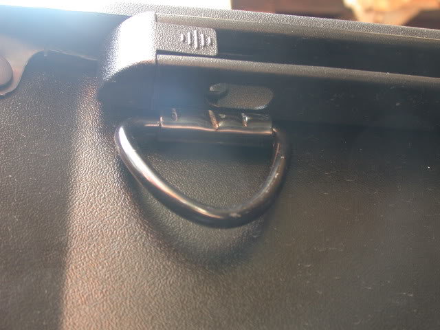

    You don't need to take the rail off, just take out the bolt with a power screwdriver, shove and wiggle the new D-Ring up under the rail, align the holes, and put the bolt back in. You'll see that I smashed in the hinge so it wouldn't rattle.

    I decided to put two of the D-Rings at the top rear of the bed - see pic. Has anyone put these D-Rings (the ones from ArmySurplus.com) under the bed rails yet? They look pretty thick and I expect will cause the rail to be extended out just a bit. Not a problem, but might be more stable if there was a D-Ring behind each screw (4 on each side....). Thoughts/experience?
