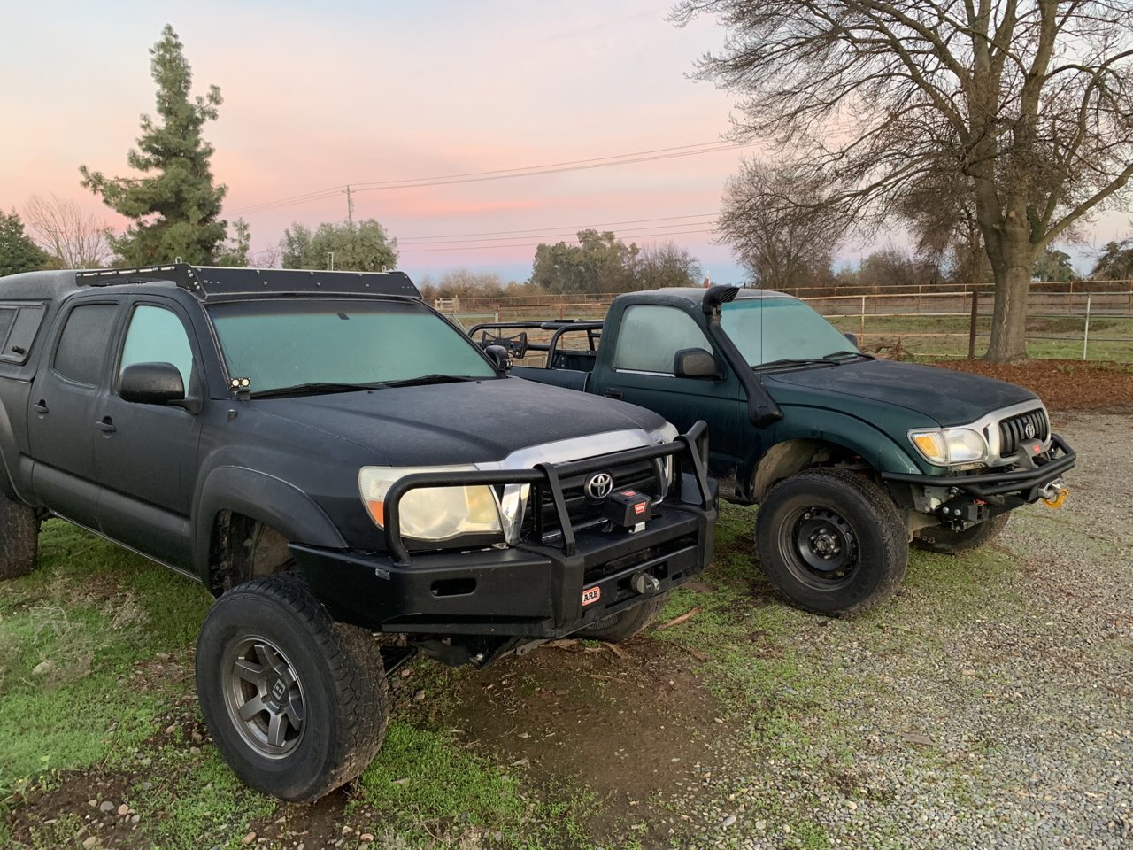

  15. Dec 27, 2018 at 12:11 AM
    #415
    kmcmahon5
    kmcmahon5 Well-Known Member
    Jul 6, 2016
    #191381
    219
    B.C.
    1996 Tacoma, 1989 pickup
  16. Dec 27, 2018 at 7:59 AM
    #416
    eon_blue
    Mar 4, 2016
    #180213
    69,777
    Azusa, CA
    Nice! Looks great
    What front bumper is that?
    FirstTimeFirstGen likes this.

  18. Dec 27, 2018 at 10:32 AM
    #418
    kmcmahon5
    Jul 6, 2016
    #191381
    219
    B.C.
    Thanks, it was custom built by a local fabricator
    eon_blue[QUOTED] likes this.
