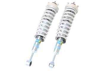

    What are people's opinion's on the new 5100/Eibach set up from Toytec? I already have the Eibach/5100's at .85 and the 1/4 taco lean spacer. TSB in the rear with a 1.5 AAL and 5100's in the back. The rear is still higher than the front. So I want to put the new set up in. Anyone have the new set up yet?

    There right? [​IMG]

    Those are the same thing that you have. Just with a bigger top plate spacer. Dont waste your money.

    x2. Maybe Toytec could sell you just the different top plate so you could get to 3"? :notsure:

    or change the setting on your billys for free and just get an alignment...

    It's not recommended to put the billies above the .85 setting with the Eibach coils which is why Toytec made a taller top plate.

    Yes I want the new ones pictured above.

    Either see if you can get just the top plate from Toytec or go for the new ones and sell off your old set-up. It should ride the same since it's the same strut, same coil, same pre-load, just a taller spacer on the top.

    They won't sell the top plate spacer, and yes the current set up will be sold.
