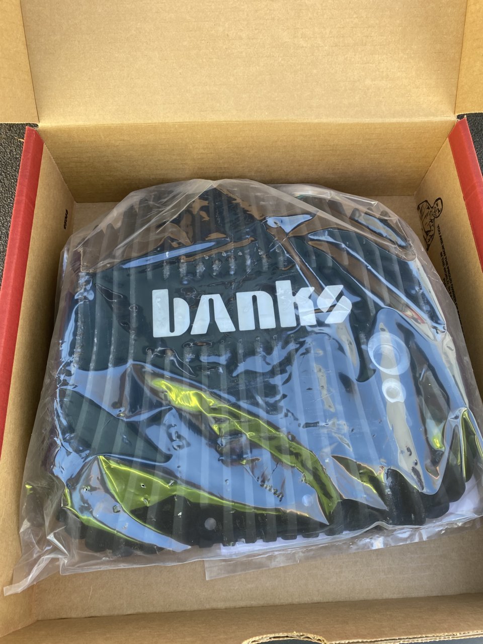

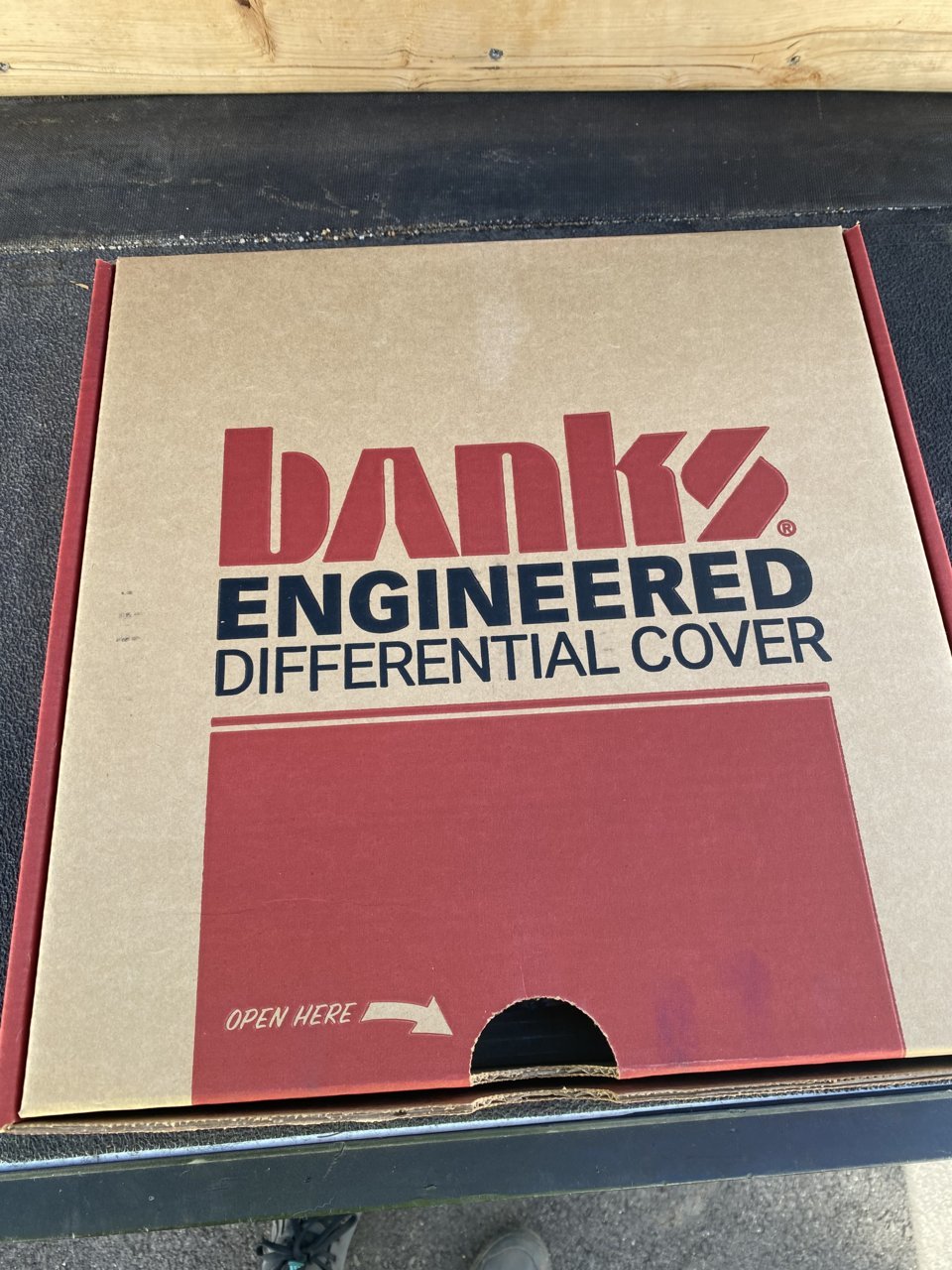

    I'd have to kick my own ass then... I only did it because the factory cover / housing doesn't have a drain plug and I hate the idea of silicone as a primary seal for the diff cover. The old cover was a PITA to get off, I wouldn't be at all surprised if I didn't warp it trying to get it loose. New cover should never have to come off, I have fill and drain ports built in with a sight glass for oil level (and of course all the fancy cooling crap that apparently does all sorts of glorious things for the diff).
