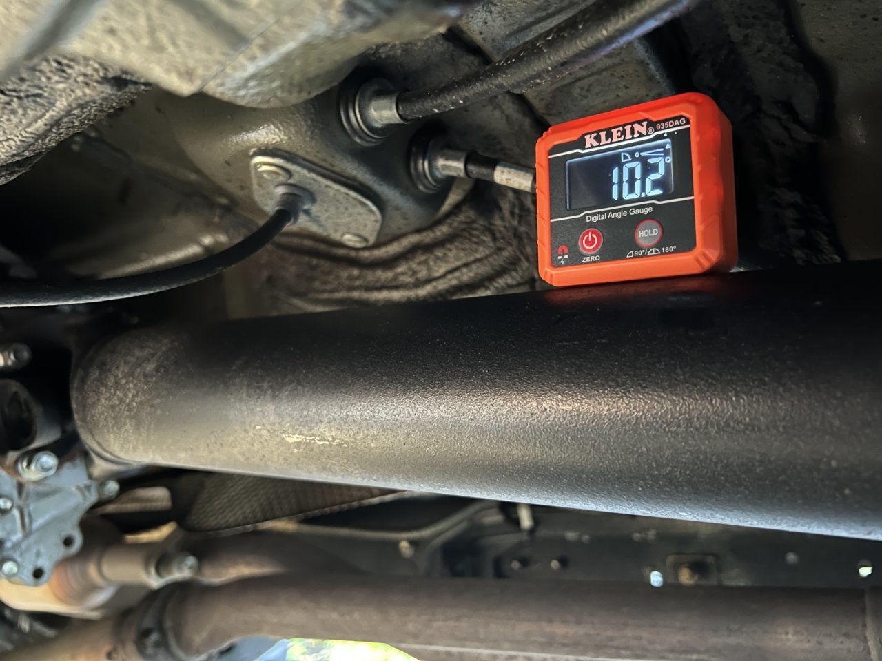

    A96C4E71-AE09-4C66-8D71-C1BB70092A3F.jpg Not sure if this helps but I’ll measure angles in a bit

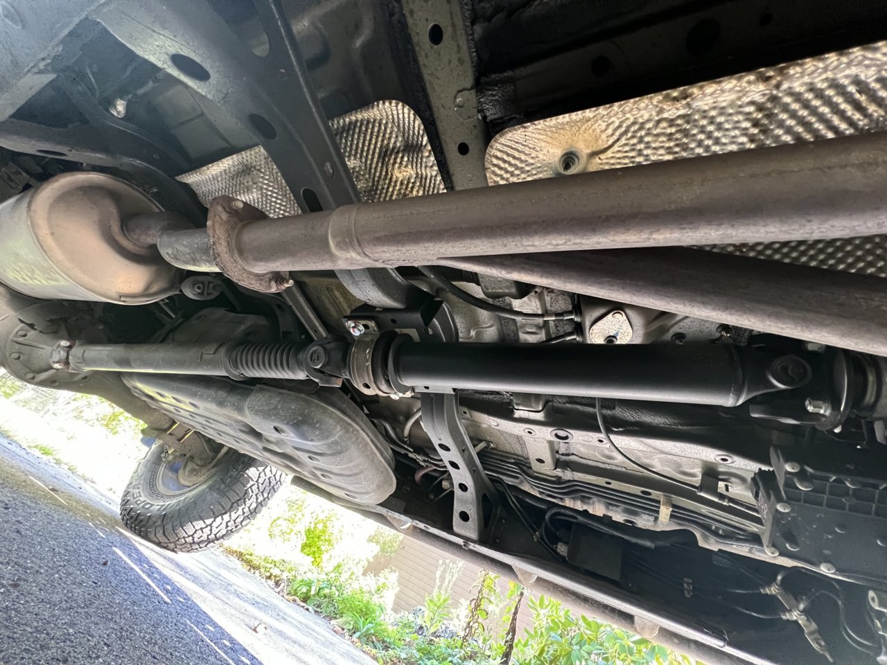

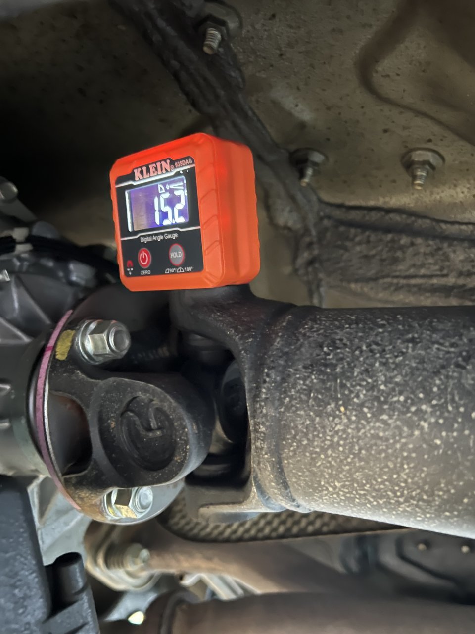

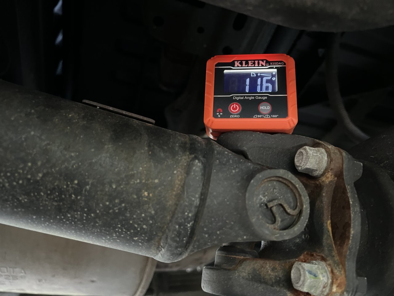

    Honestly, not sure what I should do for the angels so I hope I got it right
