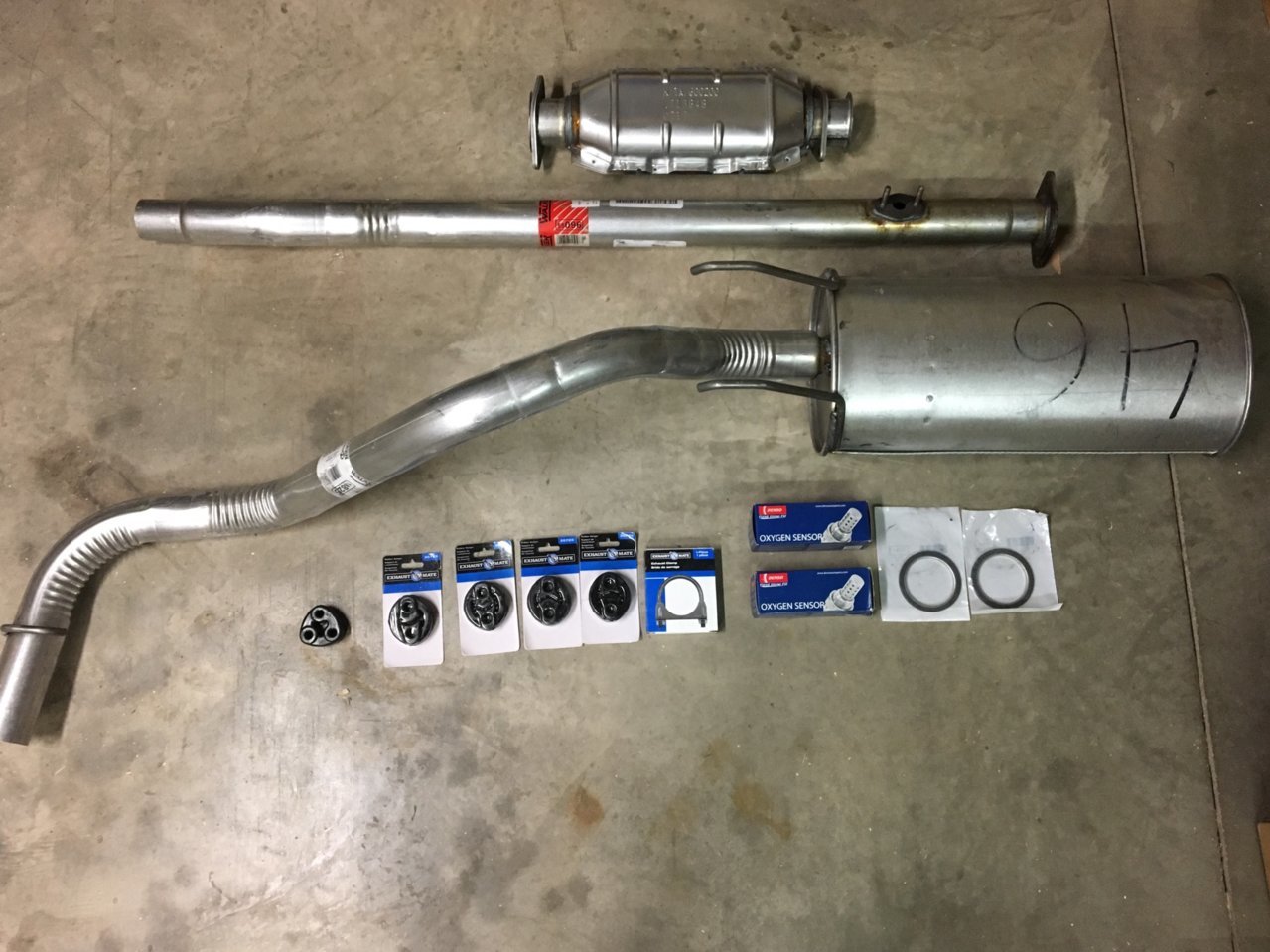

    With 327,000 miles on the original exhaust system, a split muffler and a cat code it seems time to change out the whole system. I’ve had good luck with Walker exhaust systems before so I’m giving to a go on my TRD. Cat part number 15826, gaskets (2) 31585, exhaust pipe 55096, muffler and tail pipe 18825, hangers (4) 35725, hanger (1) 35111, upstream O2 sensor Denso 234-4161, downstream O2 sensor Denso 234-4154 and a 2 1/4” clamp 35346. I hope to get started Thursday after work. I’ll report back on how the install goes. 668529D6-5A9D-4D64-B722-B3138CEC92E4.jpg

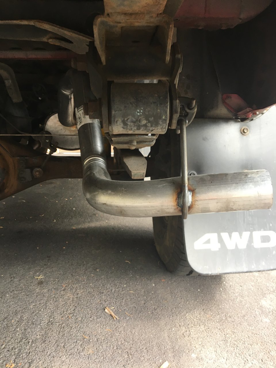

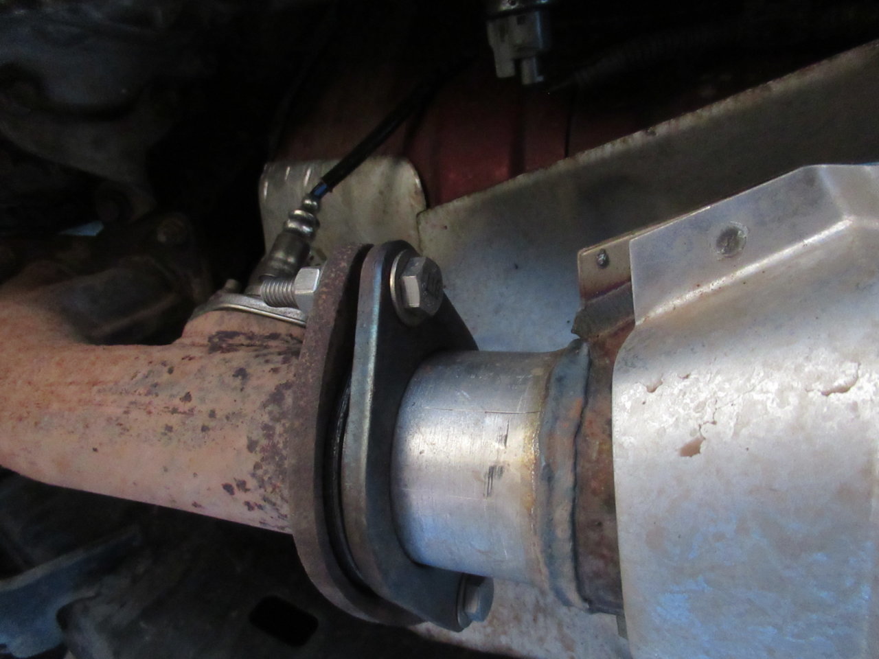

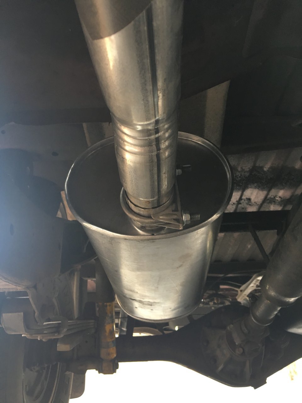

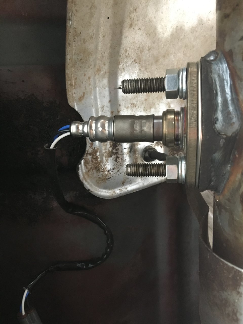

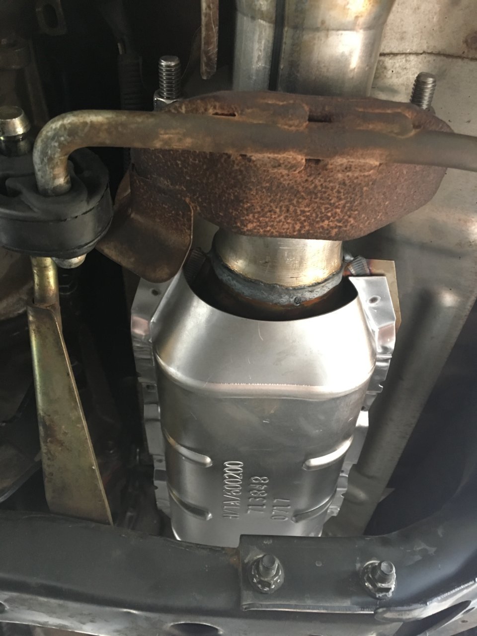

    Finally getting around to the install report. I ordered everything from Amazon Prime and only paid for shipping for one item and that was the last item to show up at my house. Total cost $425.91 to my door. The install went smooth, 2 hours. Only hitch and time suck was my inability to remember the orientation of the cat support bracket. Installed it about four times until I figured it out.
    Cat install including the support bracket.
    Muffler and exhaust pipe install. New leaf springs arrive tomorrow :)
    Muffler and tail pipe install.
    Tail pipe to original hanger
    Downstream Denso O2 sensor installed into the new exhaust pipe.
    IMG_0957.jpgUpstream O2 sensor
    I used new SS bolts, washers and nuts at the flanges
    The sound is exactly the same as stock. All in all a good experience and happy ending.

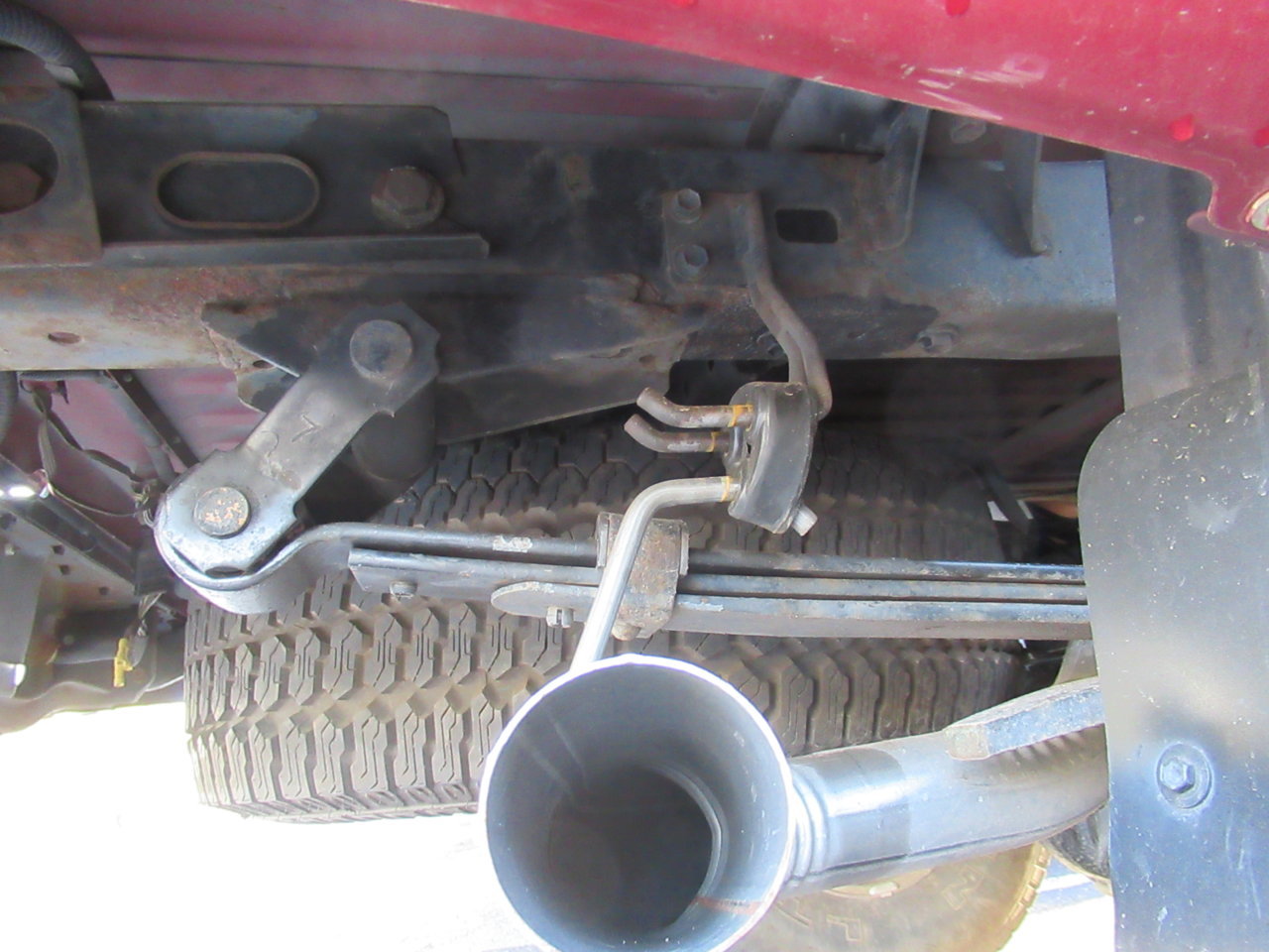

    The tail pipe hanger is also OEM. OME makes and extension hanger that might work for you. Not entirely sure but it looks like the OME hanger would bolt to the stock location/holes on the frame near the shackle. Here is a photo of the stock hanger,

    Great, thanks for the info the rear hanger is definitely different must be a model year improvement. Mine just has 2 bolts holding a rubber mount for the hook on the tailpipe. Looks like it bolts up in the same place though.
    Does your TRD have a header as well? I noticed the cat had an adjustable flange. I installed a TRD header and had to use the adjustable flange as the header outlet bolt holes were not parallel to the ground more like 10 and 4 o’clock.
    Great write up thanks for all the info.

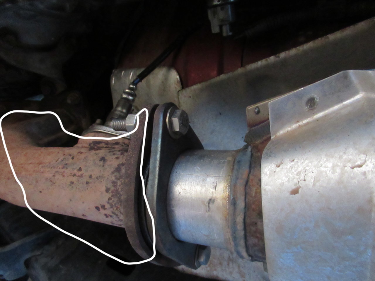

    csc (op) I snap a bolt trying to replace the upstream O2 sensor, now I am planning to replace these part do you know if this is possible ?
    mine is pretty rusted, so i might need to get gaskets and hardware since i think i will use the grinder tho cut stuff around....

    It’s called the front pipe. I replaced mine recently, bought it on EBay, 80 bucks.

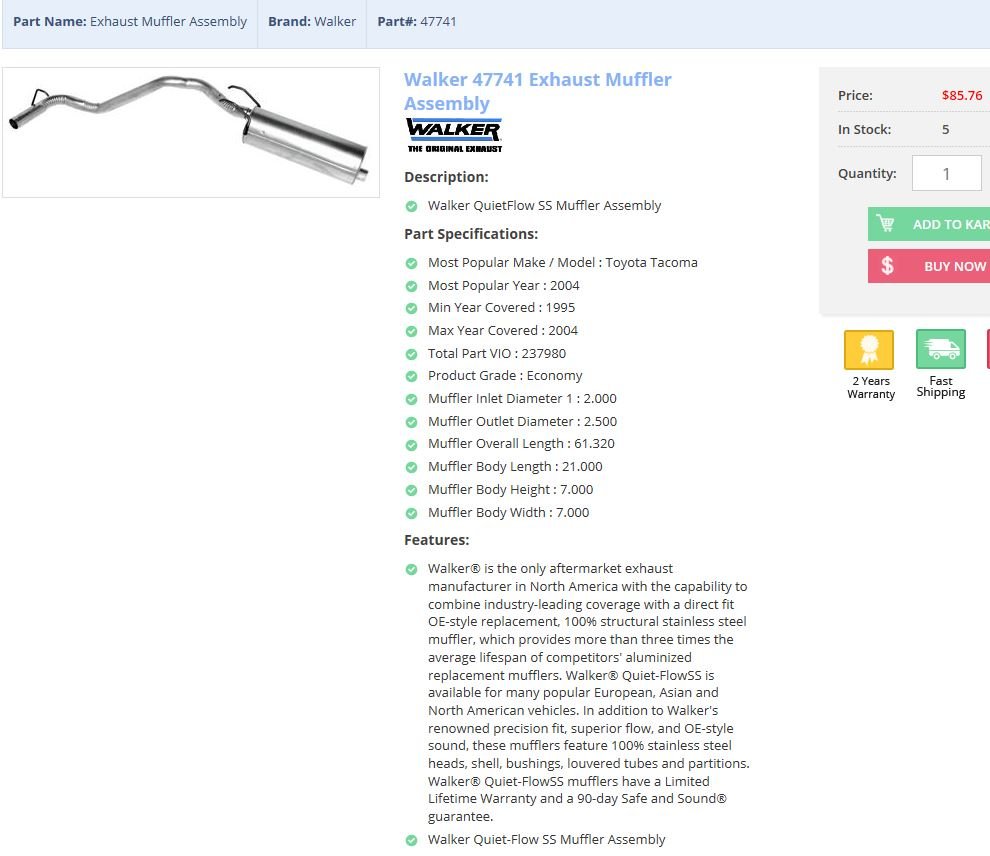

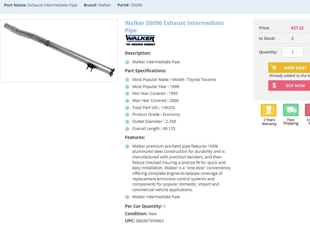

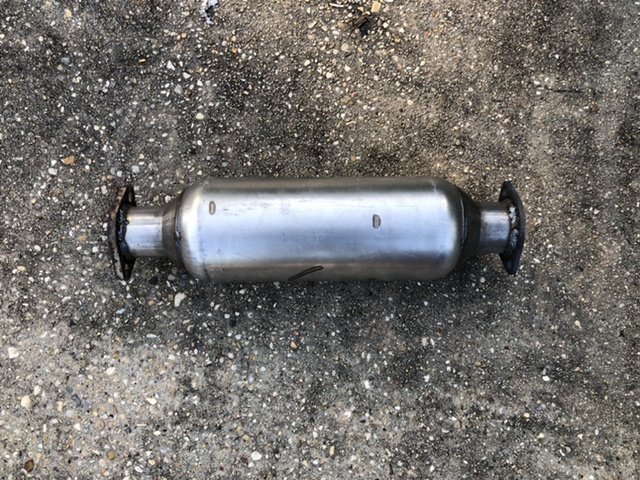

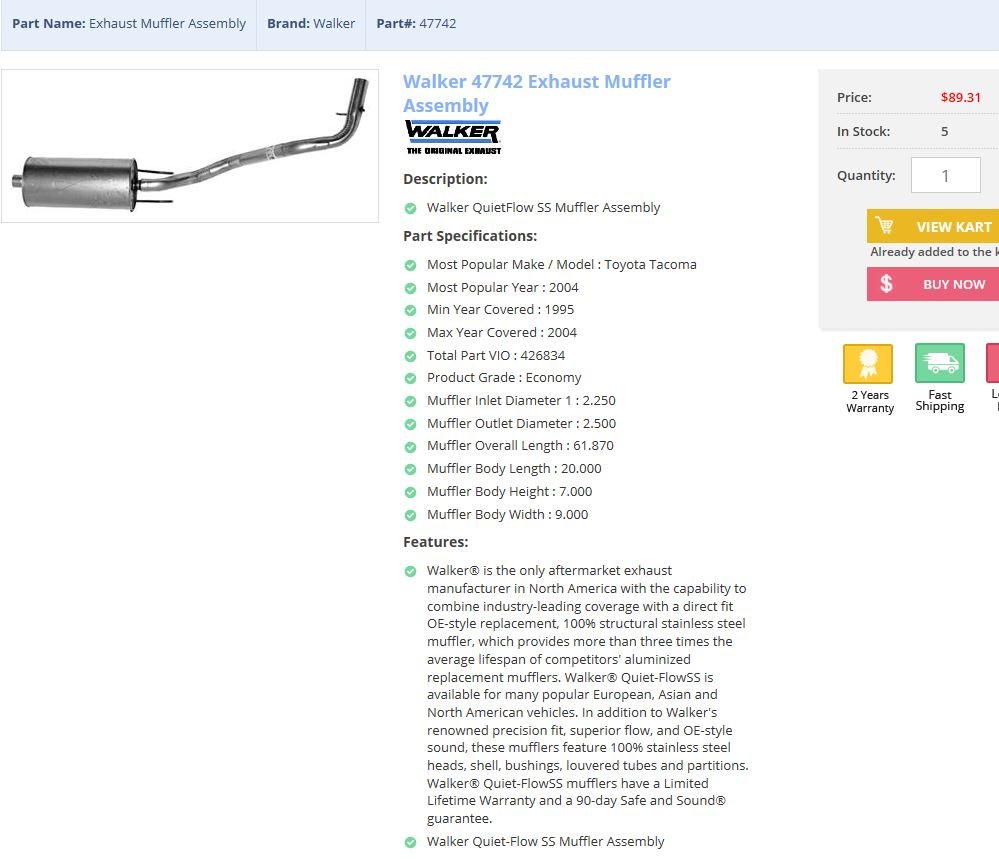

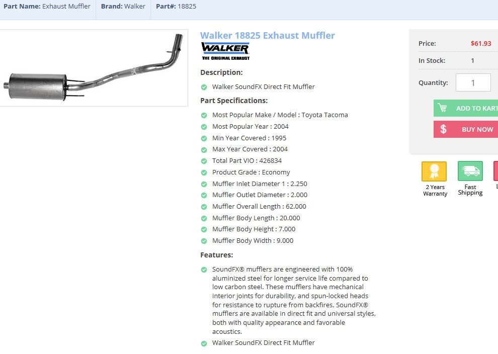

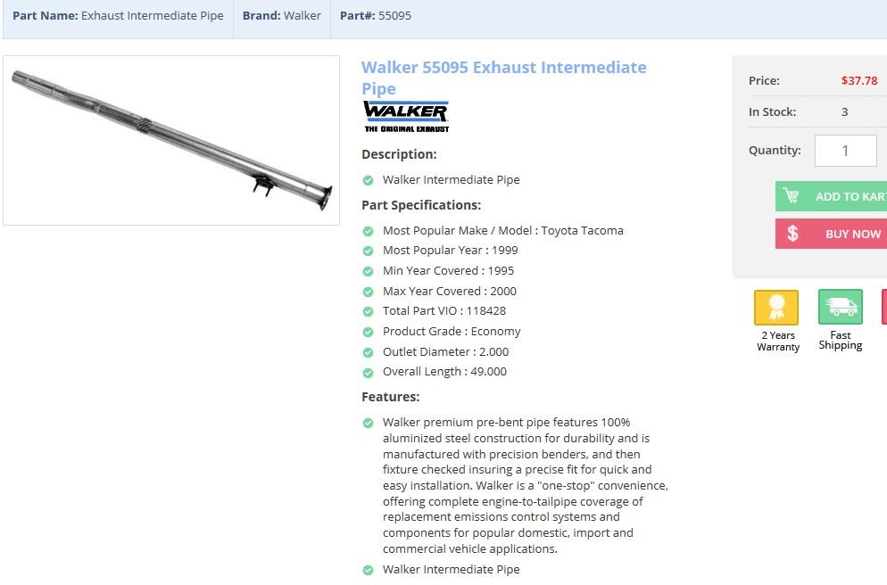

    I've been on a mission the last 3 days to determine what sort of cat back would fit my truck. Thinking I have it narrowed it down I was then on a quest for gaskets and flanges. Then I found this thread I'm about to hijack a little bit. Found very few sources with actual sizes of pipe and ect. So, here's my findings followed by questions.
    I have a 3rz and it looks like most everything for these is 2"
    But I wanted a little bigger and it appears the 5vz is 2.25".
    Then there is OP's muffler which lists as a 2.25" inlet to muffler and 2" outlet. Weird but it is also a different series muffler than the SS 5vz I ordered.
    So the question is why is there so much variation between 2rz, 3rz, and the 5vz? Factory tuning per engine, what was in stock at said factory, or year model specific? I know my 1999 3rz had a mixed match set of flanges. I'm hoping this will bolt up but do have a spare flange that can be welded onto the intermediate pipe to cat connection if need be. I have the same intermediate pipe ordered as OP, listed for the 3.4l, and I have the SS muffler that I listed for the 3.4l as well. Although I have the 3rz, maybe I'll have a little more 'sound' that stock was.
