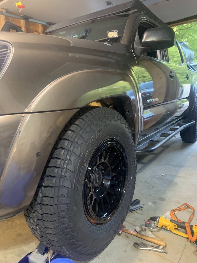

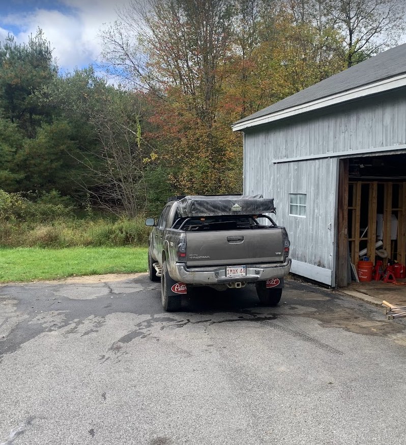

    You made a good move going with 0 offset. Sits nice and flush with the fenders and I am only lifted 1".
    As for tire clearance I had to fold the pinch weld and it barely rubbed the cab mount so I just did it.
