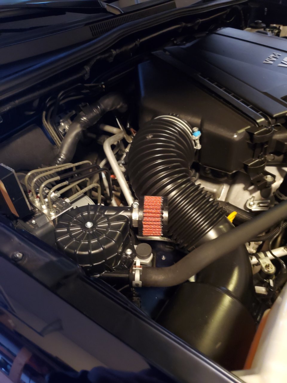

    Heard about the horrible smog filter issue so i figured its worth the 10 bucks and 5min fix

    :thumbsup: Pop that plastic cover back on if your truck came with it so your filter stays clean.

    I like this idea, where did you get the filter from?

    Did you pull the foam filter inside? And the plastic cover that goes over it stock should fit with the uni breather no probs.

    The lil plastic housing is back on i just took a pic before i put it back on because you cant see the filter when its on. And yes i did pull the foam off because the foam breaking down into the fan is the issue

    What year truck? If you have a certain 2012, have a look at this:

    I'd look into it. The warranty has been extended to 10 years, unlimited mileage on certain vehicles. They will only replace parts if there is a problem.
    Make sure you keep your original parts should you need to bring the truck to a dealer.

    Mine is supposed to show up Monday. $15 to avoid hundreds of dollars is repairs. No brainer.
