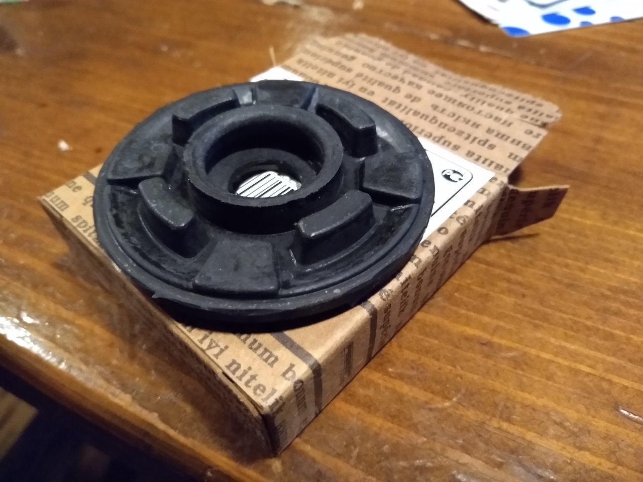

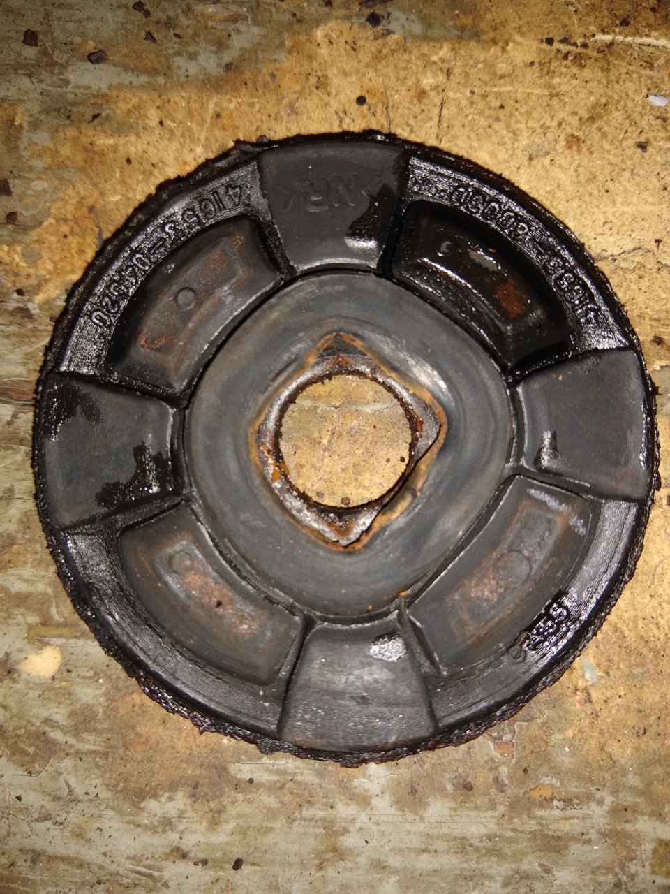

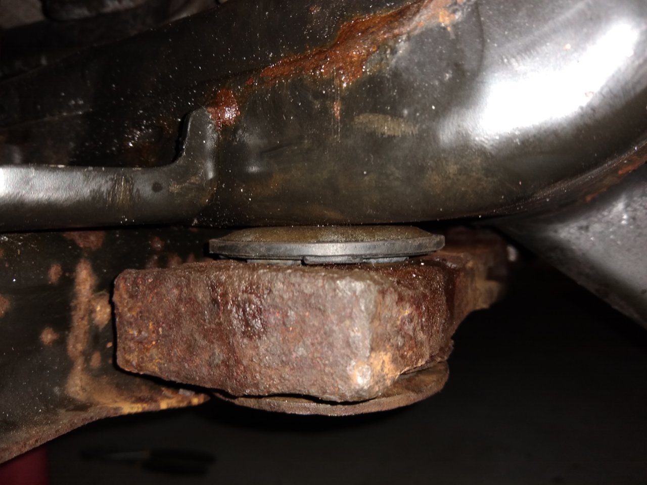

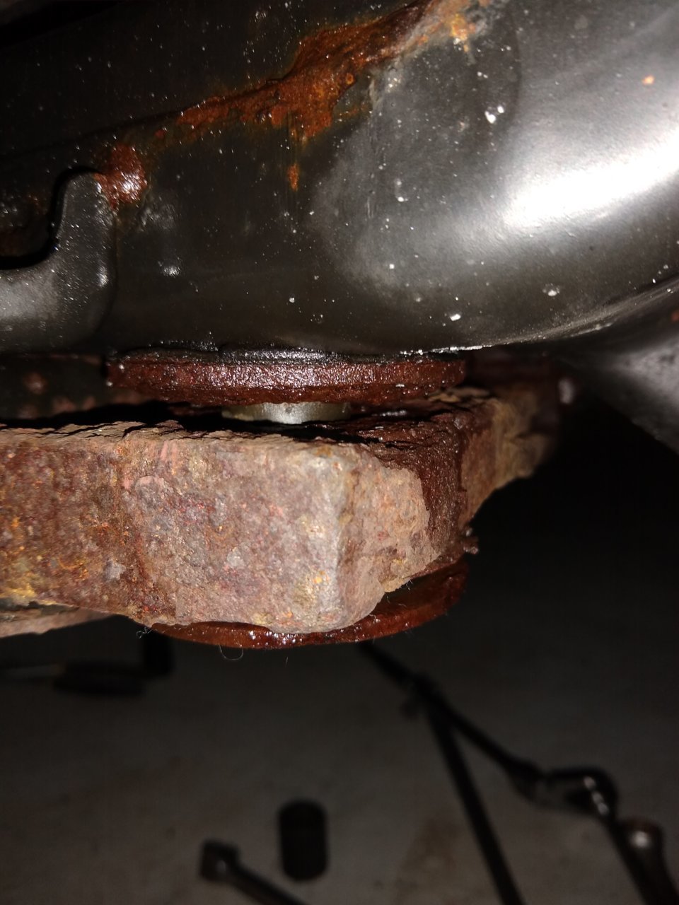

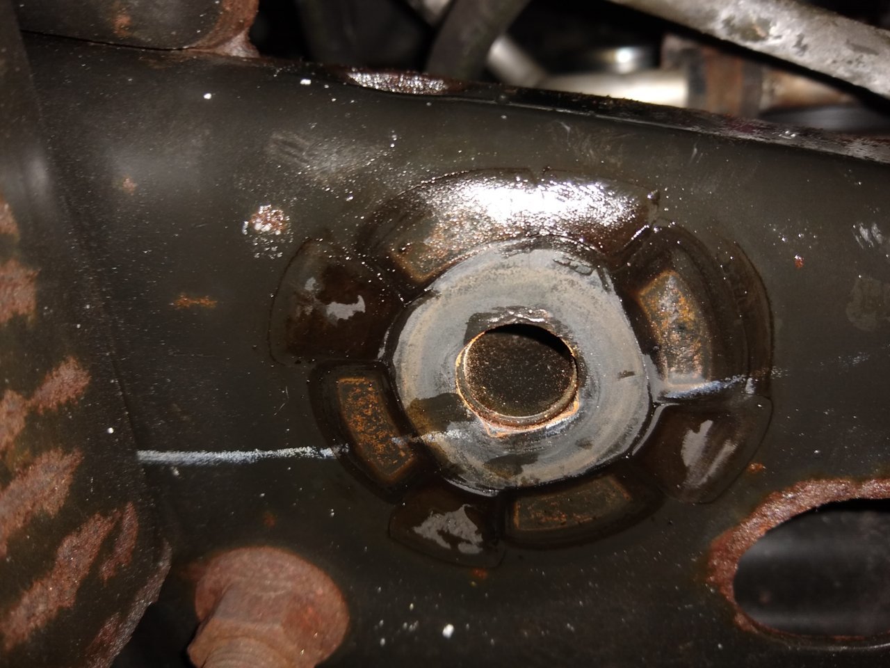

    i ordered 2 TAB-338's Febest Stops. and 2 TAB-339's (the internal bushings that aren't "replaceable") I am in the process of removing them and i notice something odd about the stops. the middle part is squished down in an odd shape. definitely not normal wear. i compare the two bushings and i can clearly see something when wrong here. I see the internal bushing is just fine so i only replace the top stopper.....
    LOOK WHAT I FOUND!!!! The people who put my lovely taco back together put the front Differential bushing Stoppers on BACKWARDS!!!
    as soon as i replaced the parts and installed them the CORRECT WAY, my vibrations diminished and no more clicking!!!!!!!!
    just wanted to say that i am not a trained mechanic and i could tell that the top stopper would seat into the middle bushing.... did not need to be a rocket scientist for that!

    Nice work but I have to ask why not replace the rusted arms since you have it off to install the bushings and stops?

    honestly, its still my plan to clean them up. i just didn't have the time to do it properly. Normally i would wire brush it, treat it with OSPHO, prime with rust encapsulator, the spray with black chasis, then treat with spray wax. This time i just treated with spray wax. i just got this truck from family. its really in great shape. got with 50k on it. it now has 75k. i have been fixing up and upgrading parts. treating rust slowly but surly. i promise you tho, these arms will be off and treated soon ;) also, new arms are like 125+ each... dont wanna pay 250 for paint.
