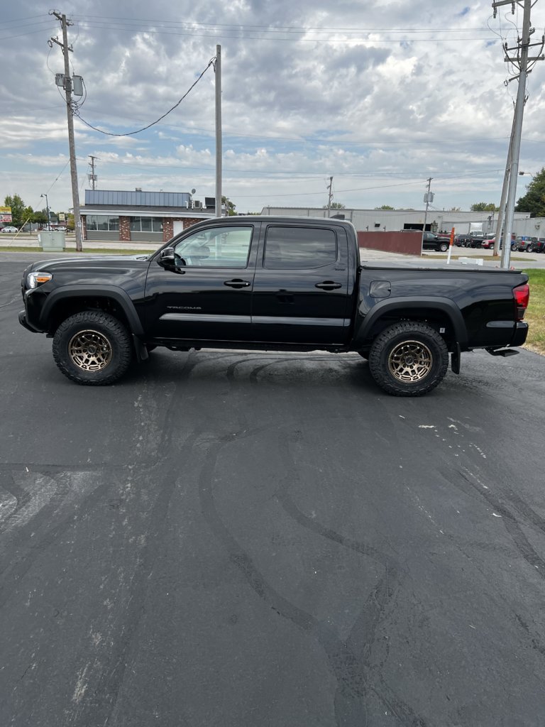

    265/70R16 XL. Surprisingly good ride. Just put them on yesterday mid weekend road trip so I’ll update any mileage change, but I don’t expect it to drop much if at all. Update: still at 21mpg highwayIMG_6246.jpg

    They’re maybe as quiet and the ride doesn’t seem any stiffer than the OEM Wrangler Territory ATs they replaced…albeit the Duratracs are only XL load. The tech said it took only 3oz to balance and I have zero vibrations at any speed including highway where I may or may not have exceeded 75mph. They gave them to me at 37psi front, 35psi rear. I chalked them and aired down 2psi due to the shoulder only imprinted about 1/4 of the block. Cornering is good, but the OEMs I think felt a bit better. However the OEM rear would break loose if I gave it the beans from a dead stop and these Duratracs will not. Great in heavy rain and no hydroplane at 65mph. I haven’t been off roading yet other than well maintained dirt roads. I don’t plan on really pushing the limits in that regard for the near future unless required so 3ply LT not necessary for me yet. The side lugs are more aggressive in person and I like the look…it’s different than the typical. They pick up and fling rocks more than the OEM, but it wasn’t an alarming amount imho.

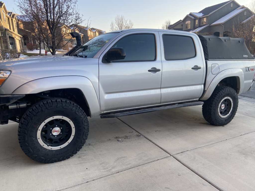

    Just installed 285/75 r16
