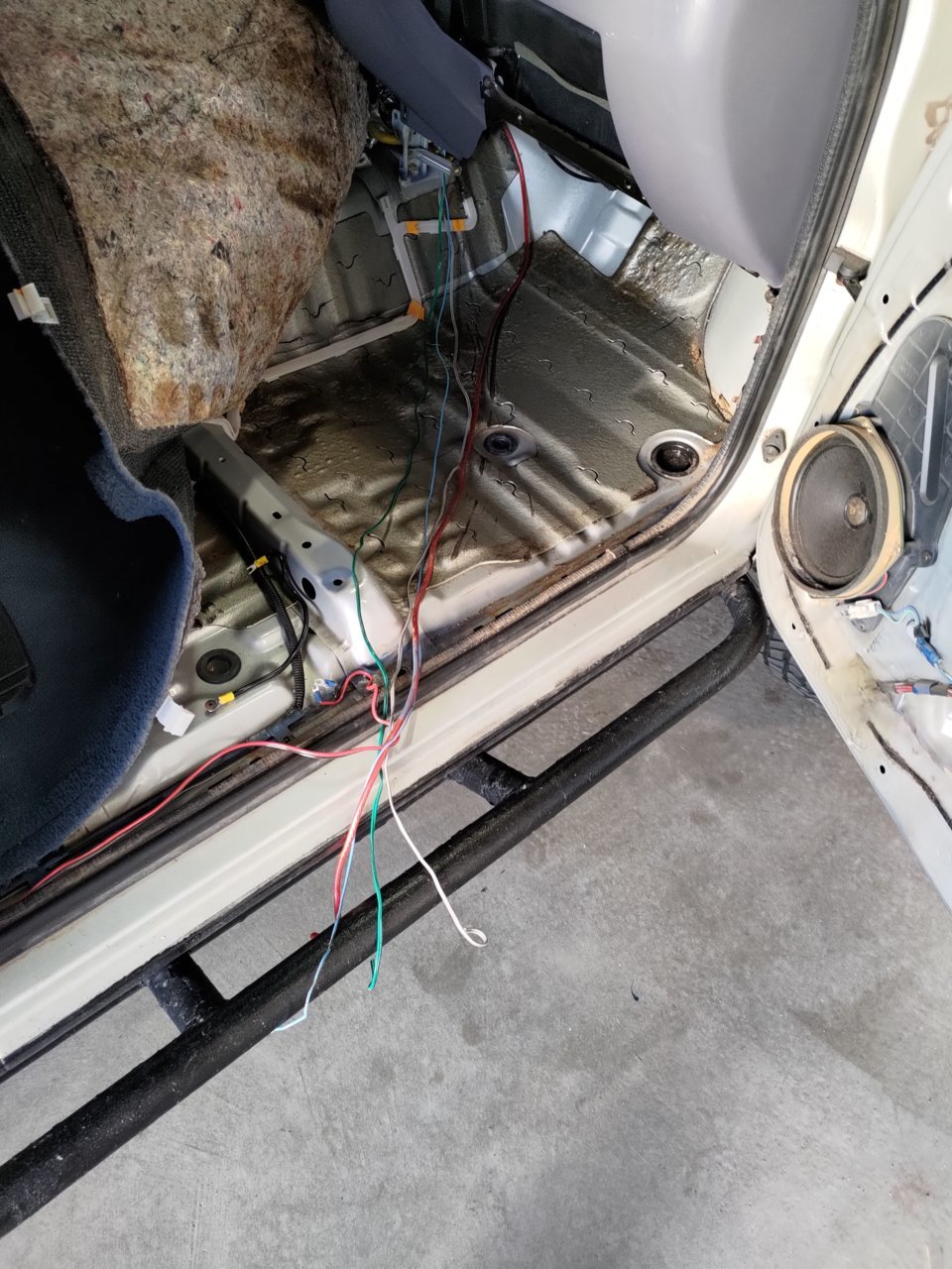

    So i've been pulling apart the truck all weekend. Found more of bubba's wiring. Looks like at one point there was an amp under the passenger seat, and then that got removed but the wiring was just stuffed under the carpet. I might have to pull the entire dashboard but i'm going to get the stereo wiring back to stock.
    I've got a new stereo (a Pioneer DMH-1700NEX), backup camera, and USB port that installs where the cigarette lighter was. Should be pretty slick when it's done.
    Also on the laundry list is replacing the passenger door lock cylinder, replacing the hood latch cable, and trying to figure out why clutch pedal sometimes won't fully engage the clutch. I'm thinking either flush and re-fill the clutch system, or replace the master cylinder for that last one.

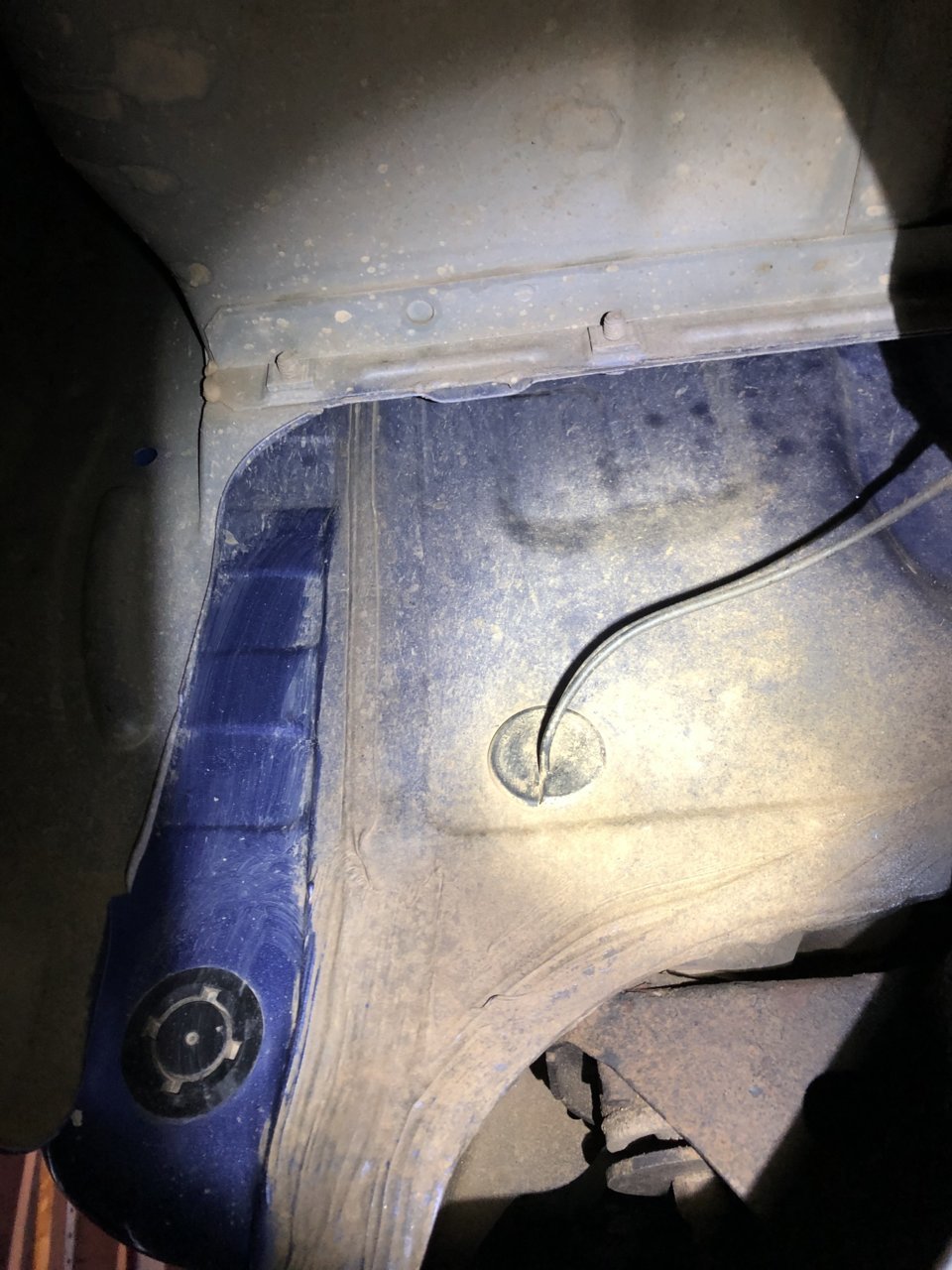

    @Winkle99 Where did you run the wiring for your camera? I'm guessing driver side, going with the rest of the wiring out the back of the cab and down the frame?
  17. May 30, 2022 at 6:20 PM
    #37
    Winkle99
    Winkle99 Don't Look Back
    Jul 19, 2017
    #224477
    921
    David
    CO
    99 XCab 3.4 Manual 4x4 TRD SR5
    Correct. For the rear camera, I ran the wire under the steering wheel, down behind the kick panel, under the carpet along the door sill, out of the back of the cab through this grommet,
    and down the frame.
