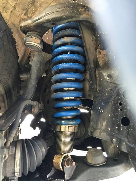

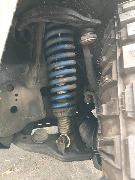

    Here's some pictures of the truck and suspension

    This guy. Also, check out the Colorado BS thread though, lots of people that might be able to lend a hand.
    And some other thoughs. First off, Toytec is out of Northglen so if you want to check them out they're local. Also, I've always been a little hesitant about the 5100/Eibach combo due to the 620lbs coil. It's gonna be stiff with no other weight up front. Might be better onroad, but clearly worse offroad. I've been running 5100s and OME 882s which are 500lb coils and give me the same amout of lift. Regardless, notwithstanding the issues with you coilovers, all of these options will be a downgrade IMO.
