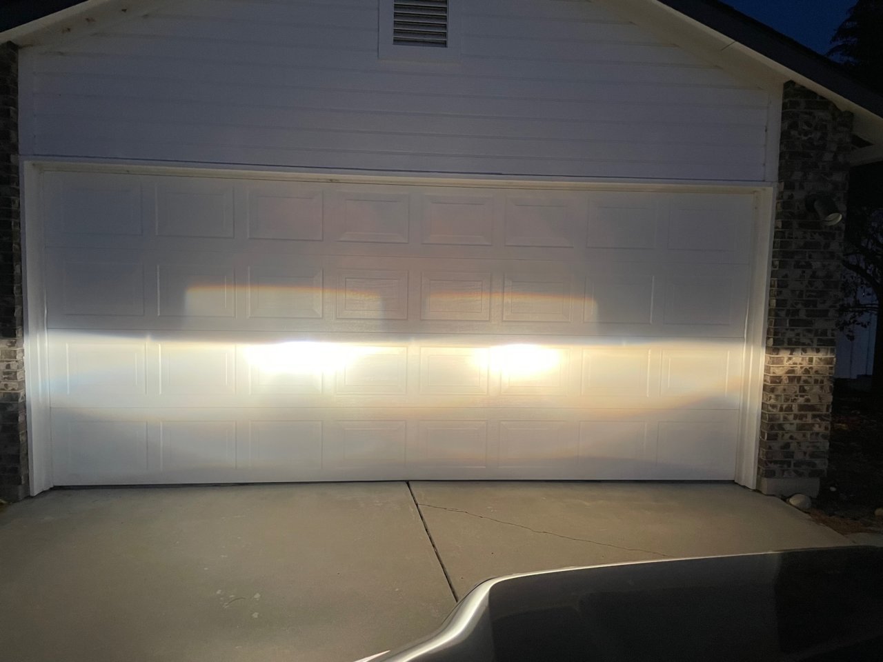

    Thanks again everyone for helping out with the info. So update here (more for myself than anyone) I'm hesitating on the OEM LEDS. I hope I can find a black friday deal somewhere....my local dealership quoted me $1006 per headlight. Seems a bit silly...especially when I still need a light bar and fogs to fill out the CBI bumper I installed earlier this year! In the meantime, I needed to get the headlight fixed so I got a pair of Sylvania Silverstar Ultra H11s ($58) at a local autozone this morning and popped them both in. I read @crashnburn80 reviews on alternate H11 and H9 upgrades but I couldnt find any Philips or Tungsrams on the shelves in town so I settled with the sylvanias. I had nothing on the docket today and wanted to get it done. They seem nice! Not a real noticeable difference for me, other than the color, but obviously needed to get the headlight fixed, as it seems this LED upgrade could take some time.
    Quick photo after I installed the 1st one.
    Ultra H11 (left) vs Stock (right)

    You should be able to find the OEM LEDs from dealers online for roughly $500+ less than what you were quoted at the dealer in -person.
    Silverstars tend to not be an upgrade, typically they are focused on whiter light which is achieved via blue coatings to filter out yellow light which makes the light whiter. However, the majority of halogen output is yellow, and filtering it out is removing output, therefore giving you less light output. Unfortunately Sylvania has a practical monopoly on the domestic auto parts stores. If looking to pick up a bulb off the shelf, I’d grab an Sylvania/Osram H9. Fred Meyer (if those exist where you are) carry Tungsram. Otherwise you really need to order online to get the best bulbs.

    Yeah I figured they weren't going to be great as they weren't really featured in any of the reviews (that I saw). Annoying that they focus so heavily on filtering out the yellow color...it makes sense that it would sacrifice output. There was a "super nice" upgraded version at autozone that came in different packaging, like a shiny plastic box and were around $70 a set, but I decided against it. Felt like marketing BS. Anyway yeah, it's the only brand I could find in town. There are Fred Meyers here in Boise - I'll check them out and see. I may just order a set of the philips H9 in the meantime because I've become interested in all of this light stuff over the past few weeks!
