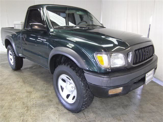

    i just bought an 02 regular cab with a busted front differential. it needs replaced completely. i plan to put a 2 or 3" suspension lift and bigger tires on it some point in the not so distant future and make it fun truck, but nothing crazy cuz i still have to drive the damn thing every day.
    question is, knowing that i need to replace the front diff, should i go ahead and go with a locking diff, or just get a toyota one from a salvage yard, or get a rebuilt one. if u have a suggestion feel free to post links if u know of a good spot for this kind of thing.
    i got the truck for $4700. it has 163,000 miles. maybe not a smoking deal but i felt like it was reasonable. 1st gen regular cab manual transmissions are hard to come by it seems! btw this is my 4th toyota truck. i've had 2 tundras and this makes my second tacoma. i'm not a very mechanically inclined person unfortunately, but my dad will be helping me swap the diff thank god.
