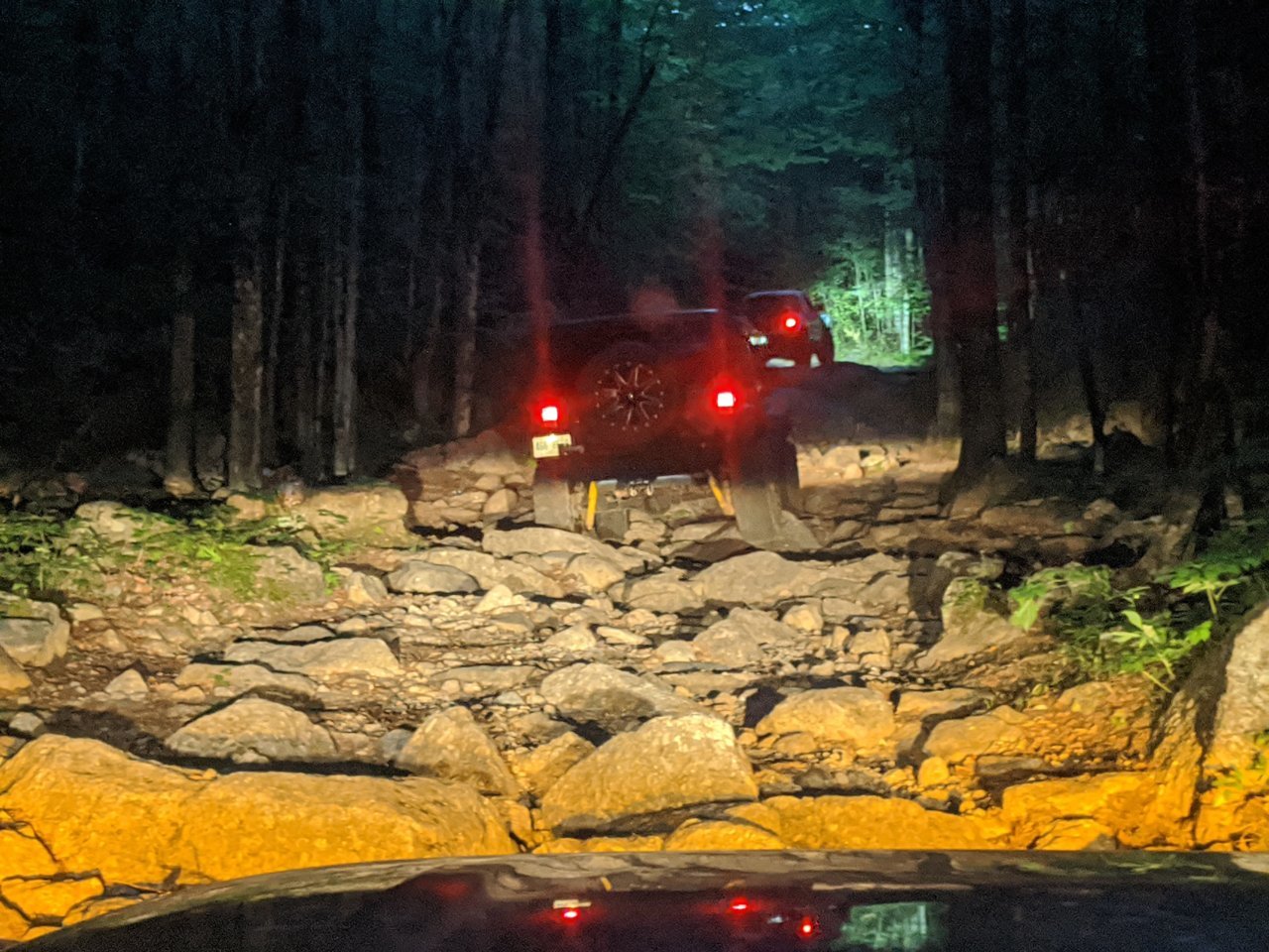

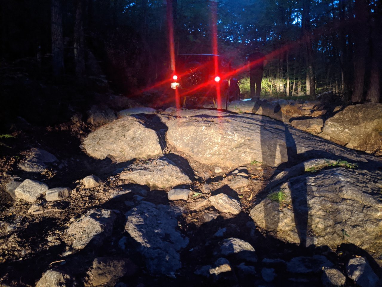

    2" of lift on a third gen with 265/75r16 will handle most things and be essentially problem free in regards to install
    If you're going for a weekend warrior kind of ride you'd handle this stuff no problem with that set up.
