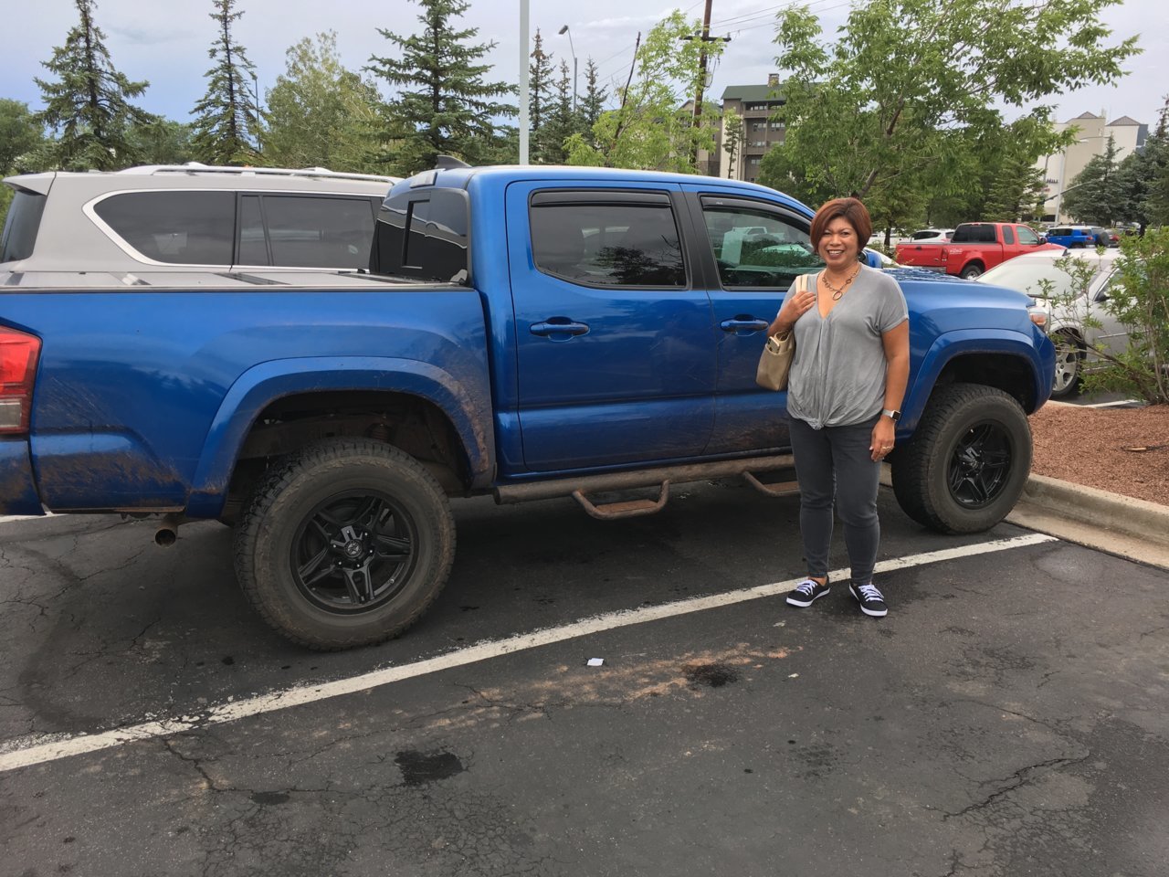

    Thank you, for this. I wish more posted pics had somebody standing beside their truck. Makes it easier to get a feel for how big the lift is. How long have you been running the 887’s? Have you experienced any of the excessive settling or sag that others keep mentioning? I spoke to Marie @HeadStrong Off-Road a few weeks ago about this & she indicated that the sagging issue was typically on trucks running additional weight up front. Maybe she’ll chime in on this. Like you guys, I don’t want to go to the trouble of lifting my truck only to have it significantly settle over time.

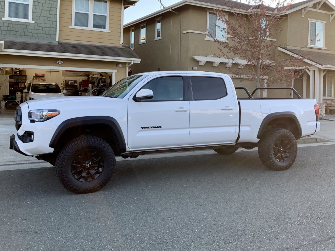

    Just for reference I did 5100’s set at 1.5” front 4th setting , rear I have 1.5” wheelers aal. Ride is great. 265/75/16 yokohama X-AT. No sagging on stock coils. Not sure if your dead set on 2” of lift up front. You could do Bilstein 6112? You will get 2”. Good luck with your build. Post pics when done
