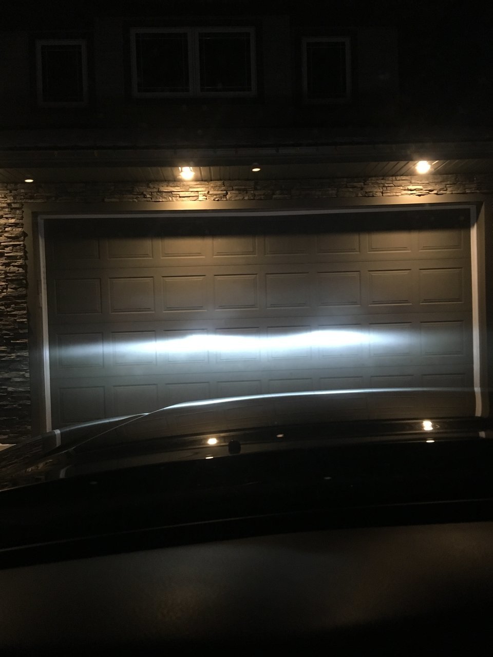

    96EEC2BD-186B-442E-A498-76F84D2EE369.jpg Here is a pic of the cut off of my LED bulbs.

    I’m very happy with the result, no need for me to add extra light bars etc to my truck anymore. Suits my night driving needs perfectly, especially through heavy elk country.

    that looks like you have no usable light below the cutoff. is the pic bad or bulbs?

    The road is bright. Just updating my original post. If I were you I’d stick to regular bulbs though.

    Agreed. That looks decent for a fog light though!

    You don’t want to drop LEDs into the OEM housing as you will have glare and loss of beam pattern. If wanting LEDs look for a complete replacement like the Morimotos, which will have a nice clean cut off and evenly distributed beam pattern.
