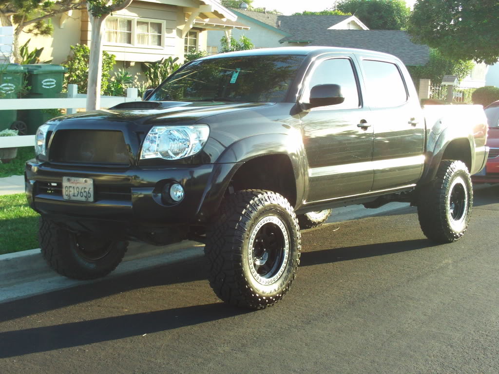

    4 Inch Spindles 1 inch from the coilovers...........about 2 inches of lift from the AAL. Here's a pic:

    what aal did you go with and does it sit level?

    I got the aal from Downey Offroad, but unfortunately they aren't in business anymore. They gave me the AAL for free when I bought the front suspension so I didn't ask too many questions about it.
    At first it lifted me a little over 2'' inches but over the last 2 years it's settled in to around 1.75-2''. I think if you got the spindles and set the bilsteins at about the lowest setting possible combined with an AAL you would be pretty level. Or if you have the money you could get a nice new set of leafs like Dakar or a custom Deaver pack. My brother has the same setup but his AAL sagged real bad so he found a used Deaver 12 pack and it matched the front real nice.

    :thumbsup: when i saw your truck i...jizzed...in...my pants!!! maybe an exaggeration but damn that looks good

    So glad that you (1BLKT) chimed in I have seen pic's of you truck on here but not one as great as that one. It has defenitly help me make up my mind on what I'm going to do to my truck..... :headbang:
