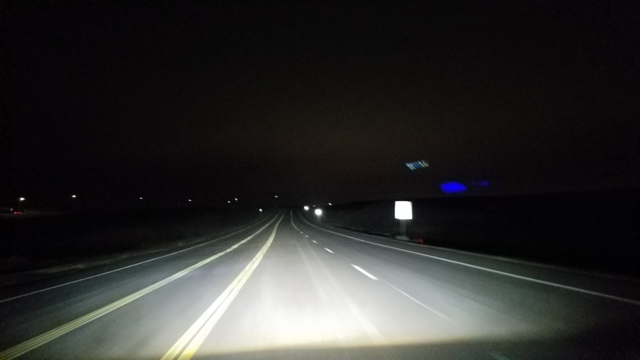

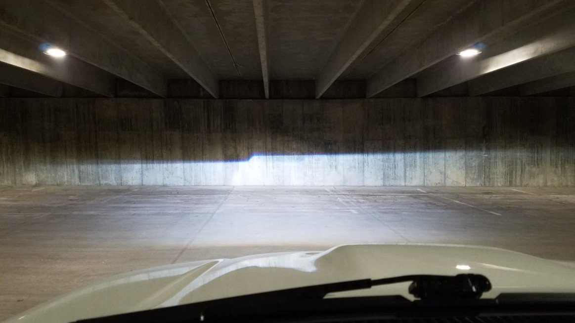

    The projector lights have a great cutoff and the light is controlled, not scattered like the LED
    lights that blind the on coming traffic

    It’s not that hard to do, there are others that do this service,
    The 7x6 are harder to do, the others the projector will fit in.
    It will cost you are 220-250 if you do it yourself with the harness.
    Others want up to 700 to do this

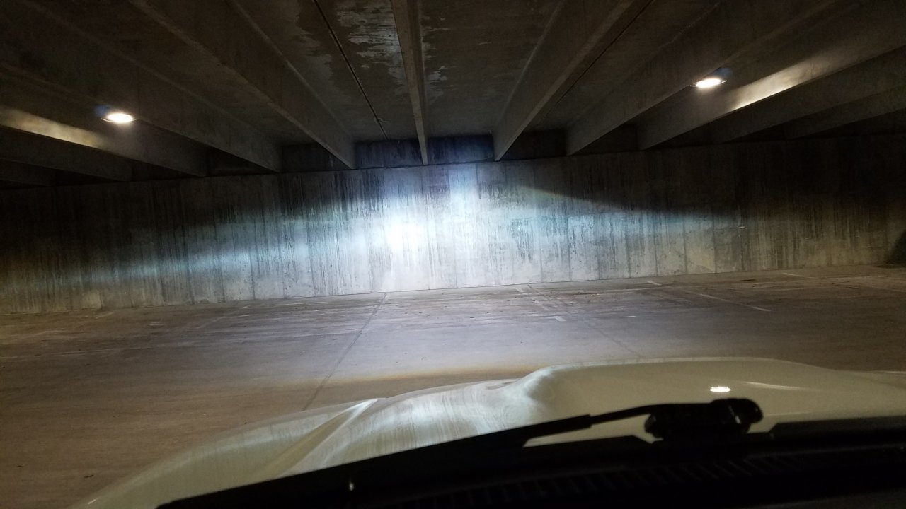

    There are two benefits of that swap:
    1. projector will give supreme cut-off
    2. HID will give additional lumens where it suppose to be
    The only thing I probably would not like is projector retrofit with LED bulb (instead of HID). On my last trip to California I drove 2019 rental Corolla with LED projectors from the factory. I hated that thing. While it had fantastic cut off, the illuminating of the road was worse than my H4 stock halogen in Autopal E-cut reflector. And driving at night with rain was quite thrilling adventure. Especially when now LED are so cheap that many a-holes put them in they old F150 or Suburban and many times I was driving blind. I hate that $hit in California.

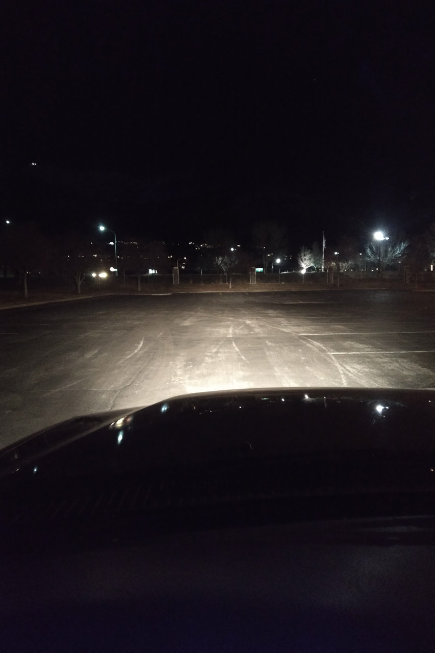

    I'll get before and after pics so I can show the improvement

    Looks great
