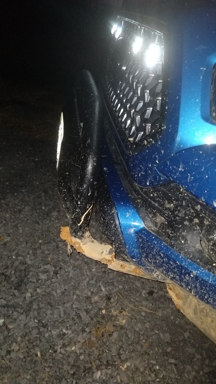

    So who has this and is running a winch? Which winch do you run? So the harbor freight 12k is back to 299 with a coupon but not water proof. Smittybuilt x20 is waterproof and has a synthetic rope for 500.
    Decisions decisions.
    Time to stop having to worry about bending the tyger bull bar each time.

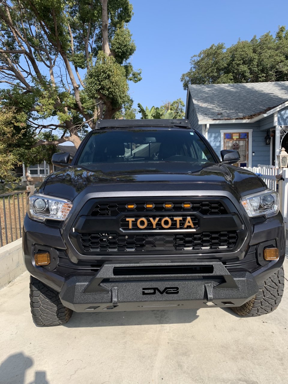

    Because it's hard to find much info about the FBTT1-05 bumper I just wanted to update this thread with a couple of details I got from DV8:
    Weight: 102 lb
    Material: 8 gauge steel

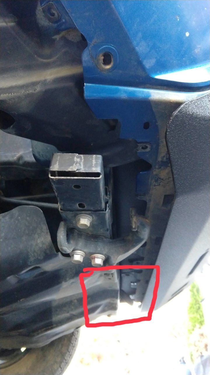

    I didn’t have to use a spacer. I pushed the lines up as tightly as I could, then tightened bracket down.
    To line up bumper perfectly, I , threw a 2x6 here with a floor jack in the middle of it with everything a smidge tighter than finger tight. This gets you dead nuts level with the truck, and then you can change height with the jack, and get fore aft/ side to side/ and overall angle adjustment. Looks like you may need to remove the factory skid so you’ll have a flat surface there. I have an aftermarket skid plate so it’s easier. Don’t tighten bolts until you’re dialed in.
    As far as strength, I don’t see how this bracket is any more/ less likely to tweak frame than any others that are commercially available. If concerned, it would be easy to tack it after it’s all lined up perfectly, then weld the mounts to bumper/ winch carrier and possibly throw in some gusseting?

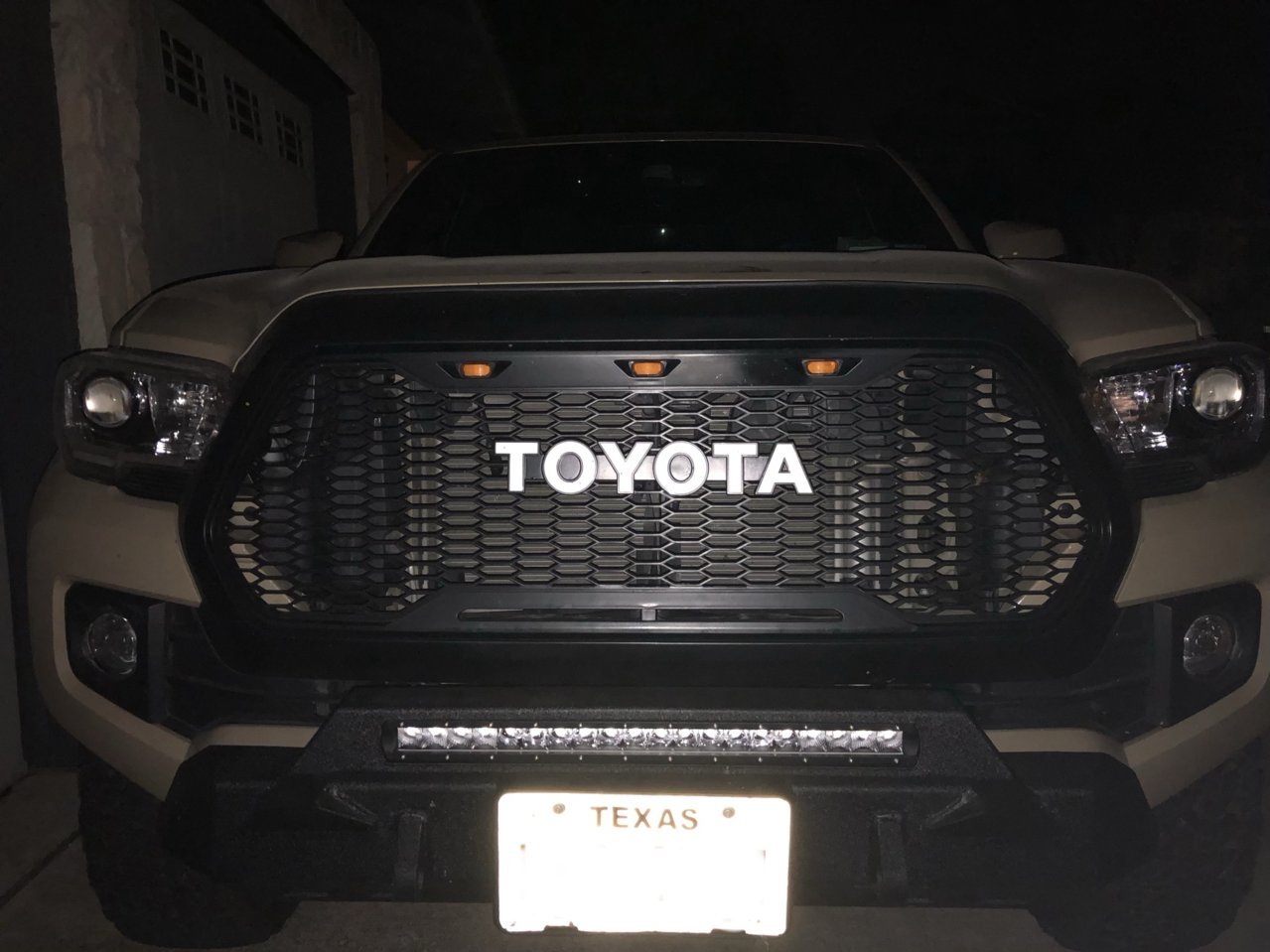

    DV8 Offroad BS20E100W5W - BS20E100W5W
    This light fits perfectly in the hole and is pretty damn bright. It’s no doubt an import and commercially available by other names. Looks very similar to the one that Caliraised sells. Best price I found was Jegs and it does not come with any wiring. Just purchased harness switch from Caliraised today to complete install.
    Slotted mounting ears are already inside of the mounting hole so just need to slide it in and tighten.

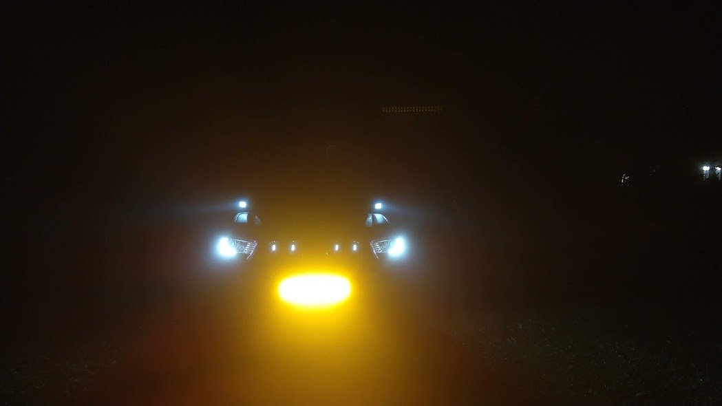

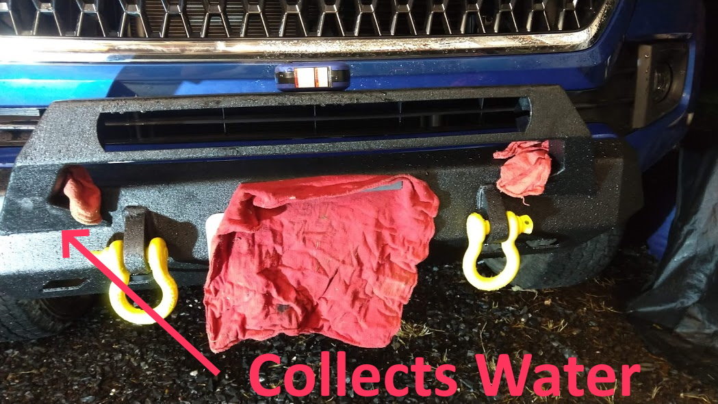

    Had ordered this dual light bar from the jungle shop:
    https://www.amazon.com/gp/product/B07GTL2CTD
    While installing I dropped the bolts and washers in the crevice for the bar mount so make sure to stuff some rags in there so you don't need to borrow someone elses hands and fingers that are small.
    This also brought up another flaw of this bumper which is that the crevice is not painted at all and collects water. When using the air gun trying to get the bolts out I had rusty water spray everywhere.
    So far its been buyers remorse for this bumper as far as design/engineering goes to make it actually function as a winch bumper. Will try to take some daytime pictures of everything. Plate is also just ziptied since the bumper didn't have predrilled plate holes.

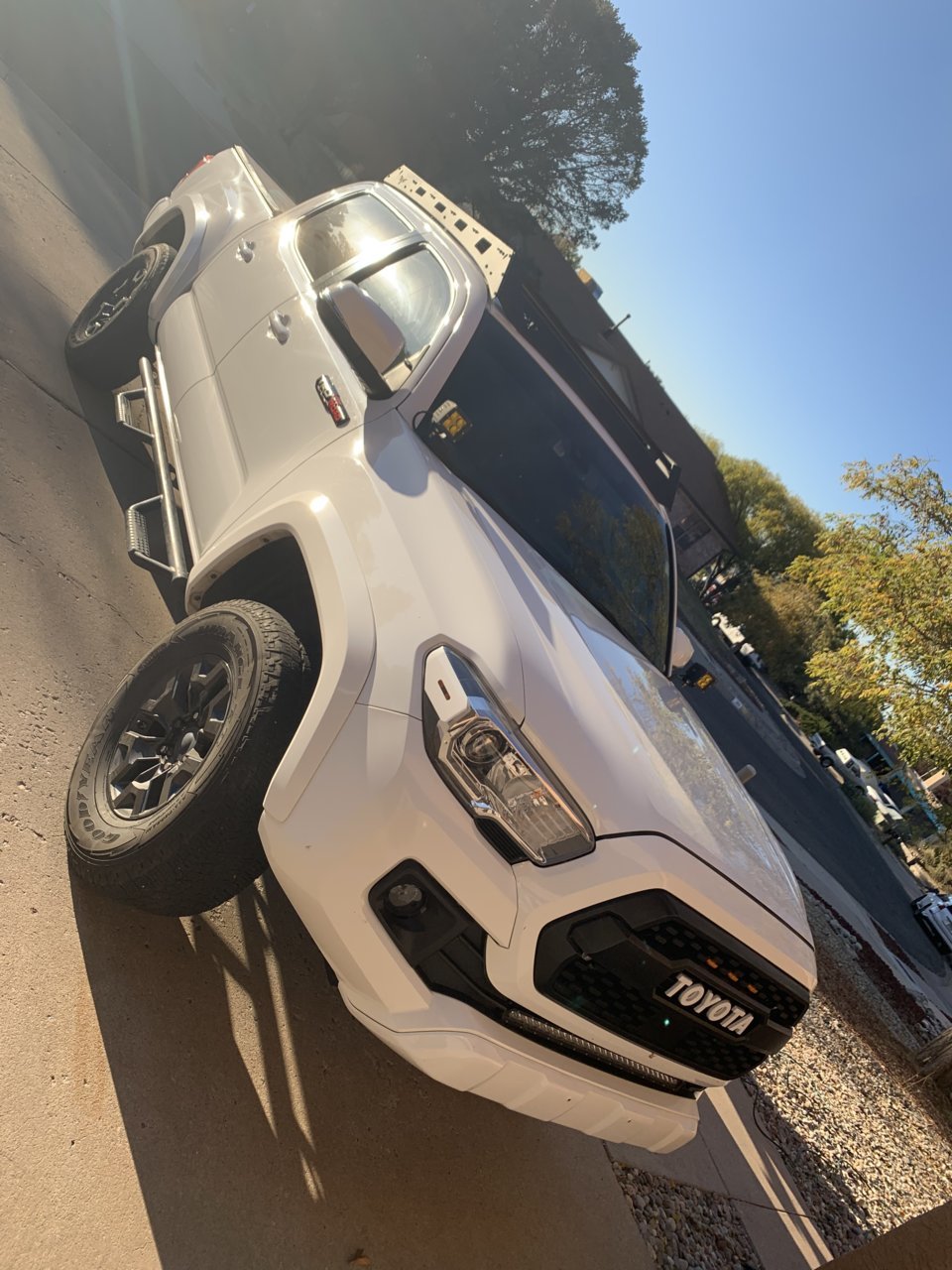

    Finally got around to the install! Looks beast. Made it as level as I could for a late night no light install. Happy with it for now, wondering about license plate mounting.
