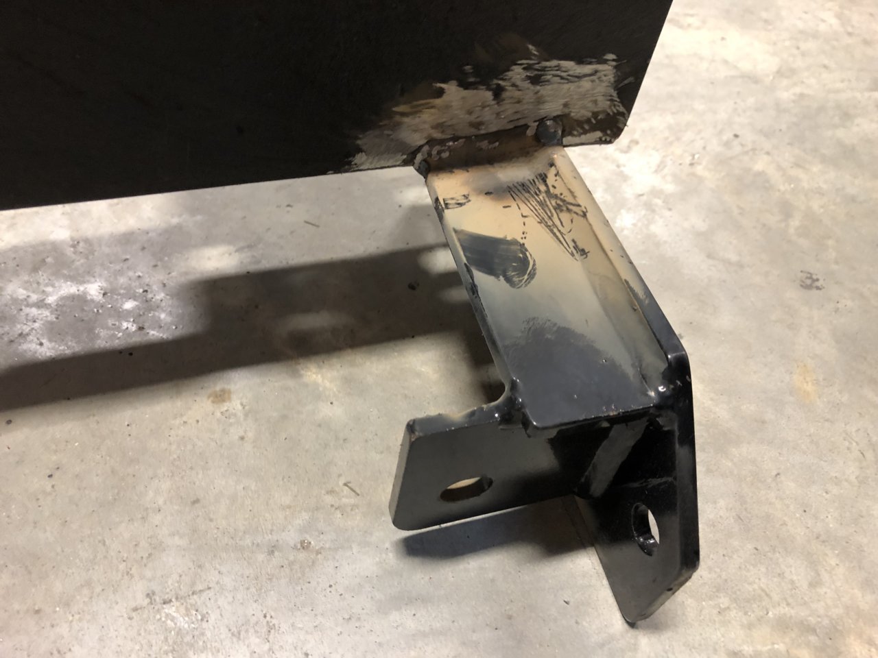

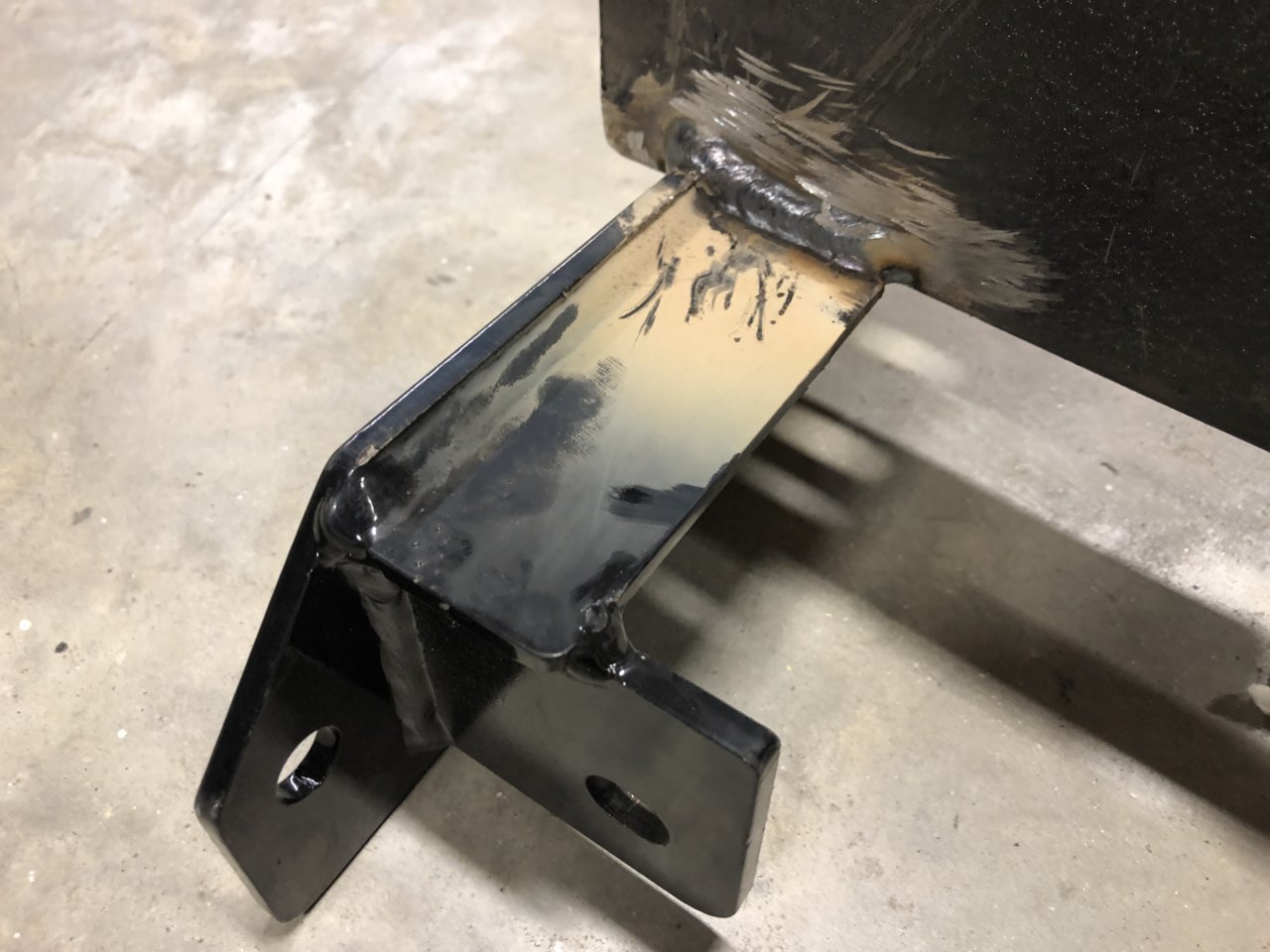

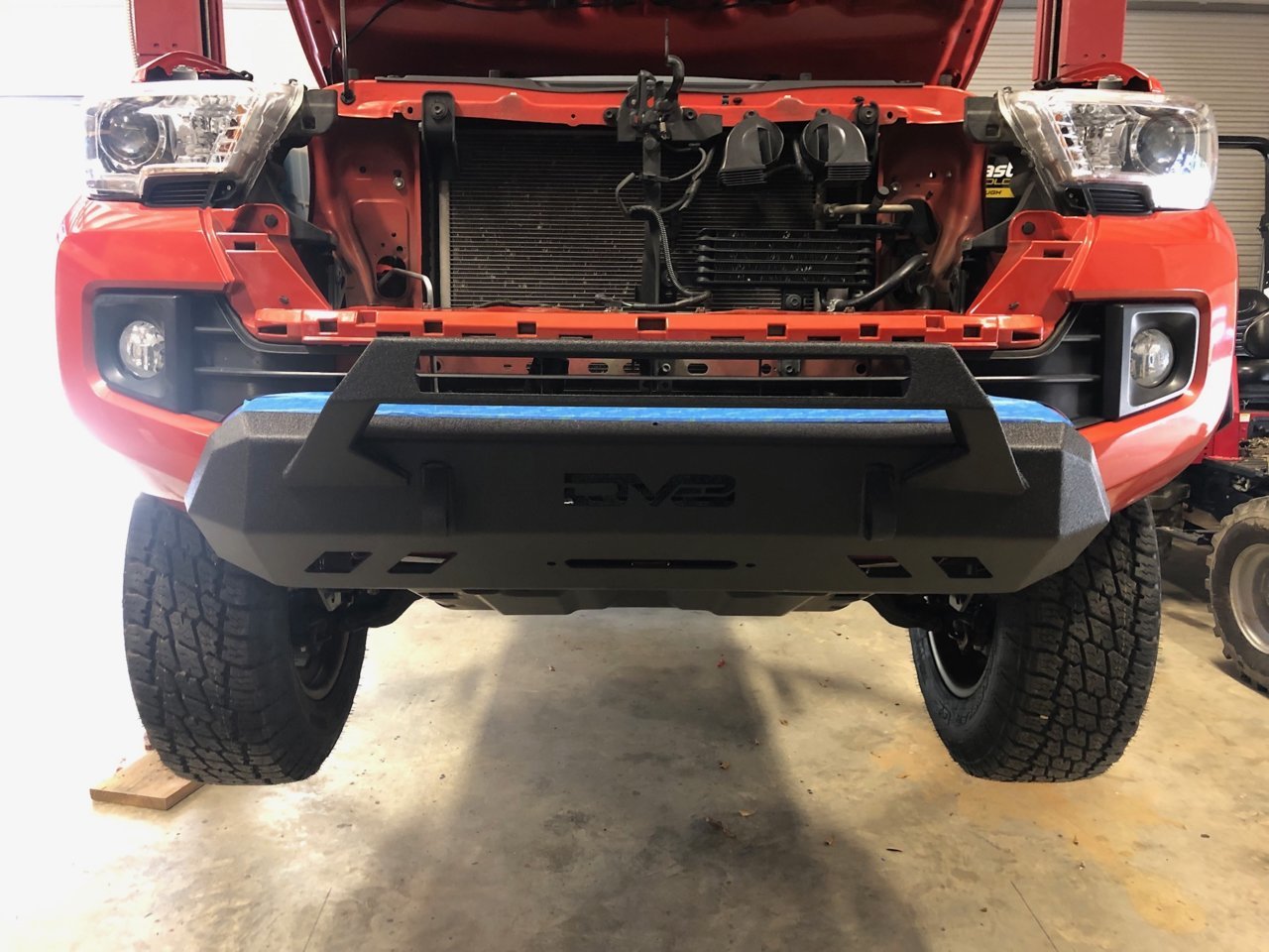

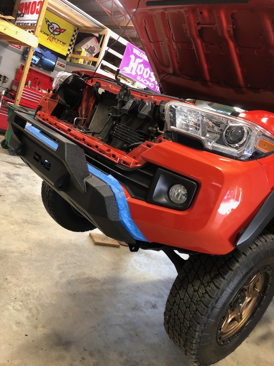

    Stirring the winch pot, again. Anybody installed one yet? Figured out which one(s) fit or which one(s) don’t? I’ll be shopping for one this week...

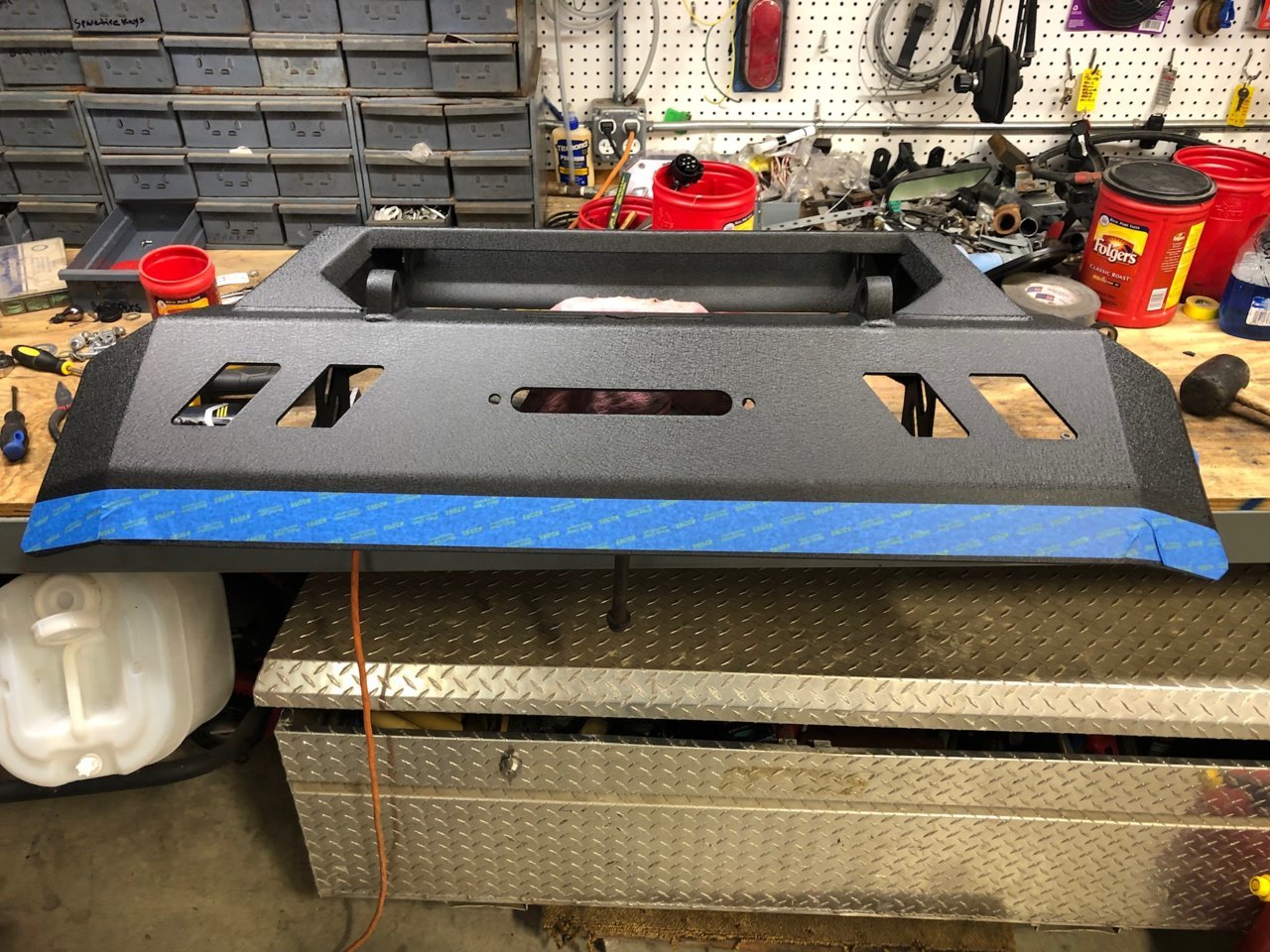

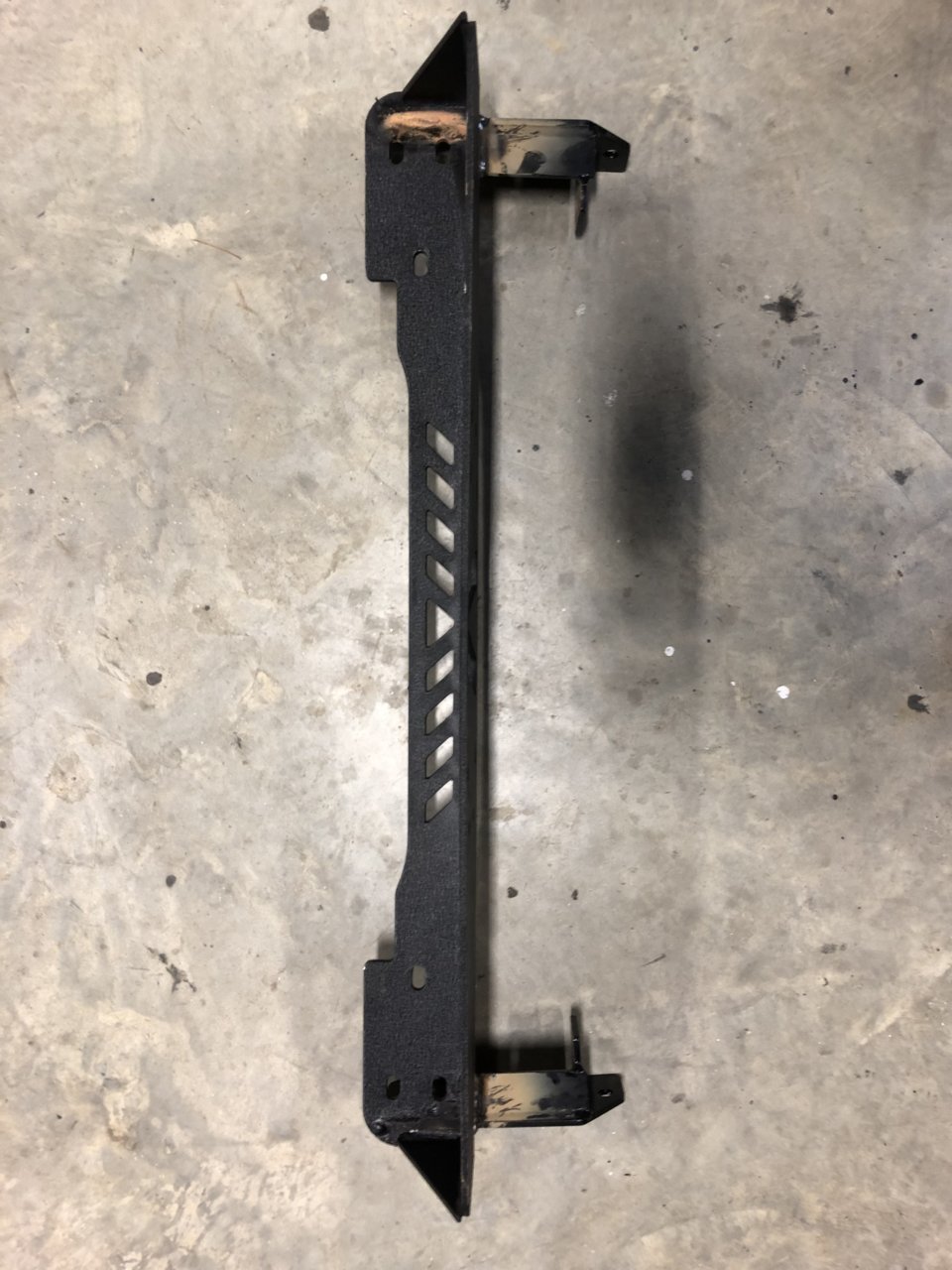

    I’ve been slicing and dicing my DV8 bumper and a Roadmaster tow bar base plate mount. I have it 95% mocked up. I’ll have both kits cut, fit, fabbed and welded up by tomorrow. Then off to powder Monday. I’m having to modify the Roadmaster base plate kit as the two end pieces that the draw bar attach to, bolt to the front of the frame rails as does the DV8 winch plate. I have notched these brackets the fit around the DV8 winch Mount plate and have welded them to the winch plate itself. The draw bar brackets will retain their bolt on points under the front frame horns and through the side of the frame horns. When all is said and done, the DV8 winch plate will be nicely reinforced with 4 additional “through the frame” fasteners and my tow bar will be sold as a rock, as well.
    I also had to trim the bottom of the DV8 bumper itself to completely clear the Roadmaster cross bar.
    Yes, I will flat tow my 3rd gen.
    Yes, I know you can’t flat tow a 3rd gen.
    Not my first rodeo.

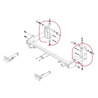

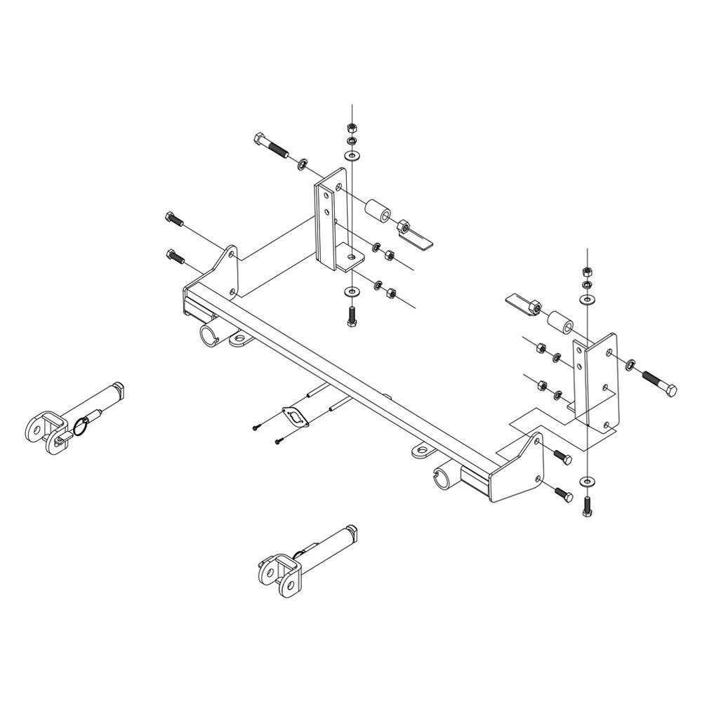

    I understand. The more I looked at it when I got it, the more I saw the potential for failure. Fortunately, I have a shop and enough experience to adapt and overcome! Not to mention a want and a will to set this truck up for a particular job set.

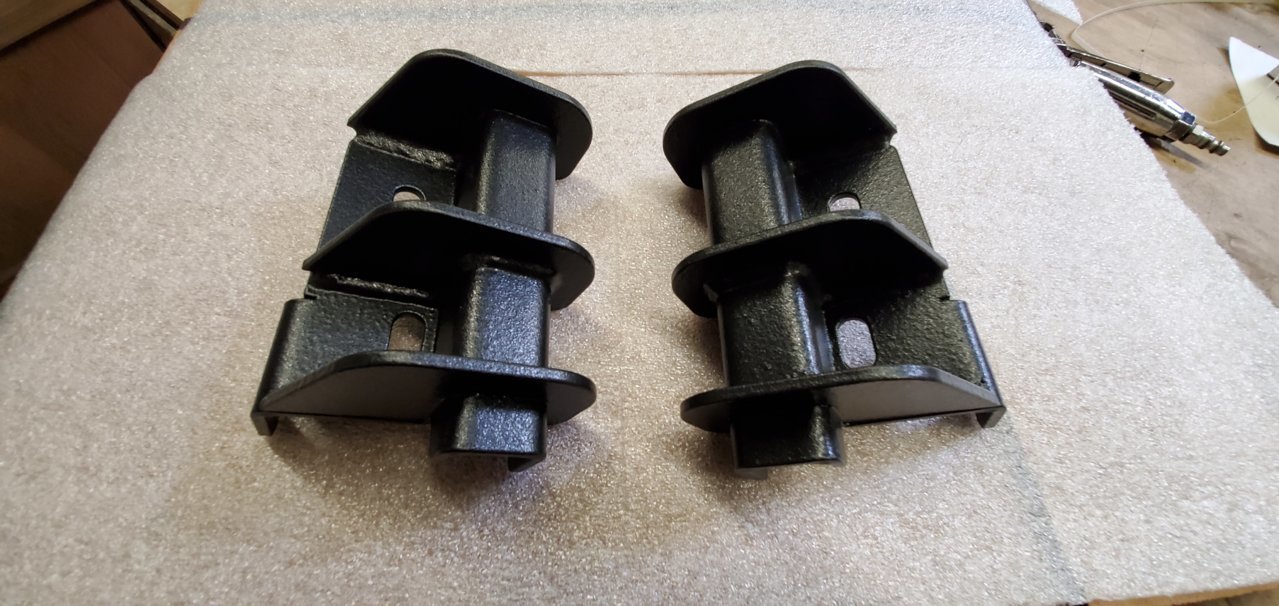

    Beings that I am setting my truck up to be flat towed behind "random" trucks on the regular, as well as part time by our MH, I saw a way to add both the Roadmaster Towbar and reinforce the winch mount by merging/purging the two kits together. In the picture below, you can see the two end brackets in the illustration from Roadmaster that bolt to the front/sides and bottoms of the frame horns. I just cut the parts out of them that utilized the front frame horn bolts leaving the 6 bolts solely for the DV8 winch mount. The Roadmaster brackets were then welded to the winch mount plate and along with the 6 bolts that would normally retain it, it now also benefits from a pair of 5/8 x 3.5" long bolts through each "side" of the front frame horns and yet another pair of 1/2 bolts/nuts through the bottom front lip of each frasme horn. That's a total of 10 bolts holding just the winch mount/cross bar assembly in place. Welds are rock solid and this puppy isn't going anywhere.
    All that said, I need to add a gusset to each of the outer bumper mounts. I think the greatest failure point is the outer part shifting side to side during a pull to the side. It's a simple fix if you have a welder and the ability to utilize it.

    Guys, listen. I don’t mean to muddy the bumper waters here with my custom tow bar/winch bumper modifications.
    Fact is, there are companies out there that make, market and sell winch bumper reinforcements already. Some for their own bumpers and some for “any” bumpers. I’ve just come up with a way to adapt this setup to my needs and in the end will have a super strong setup. One that will perform well beyond anything I’ll subject it to.
    In the end, however, im just trying to show how easy it can be to beef up this particular bumper.

    nice welds!
    sadly my skills arent that good =( but keep up the pics so we get some ideas or someone to come up with some "bolt in" style brackets maybe.

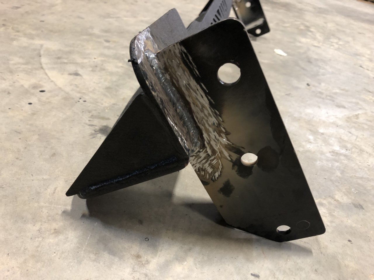

    13
    2004 Tacoma Xtra cab 4x4

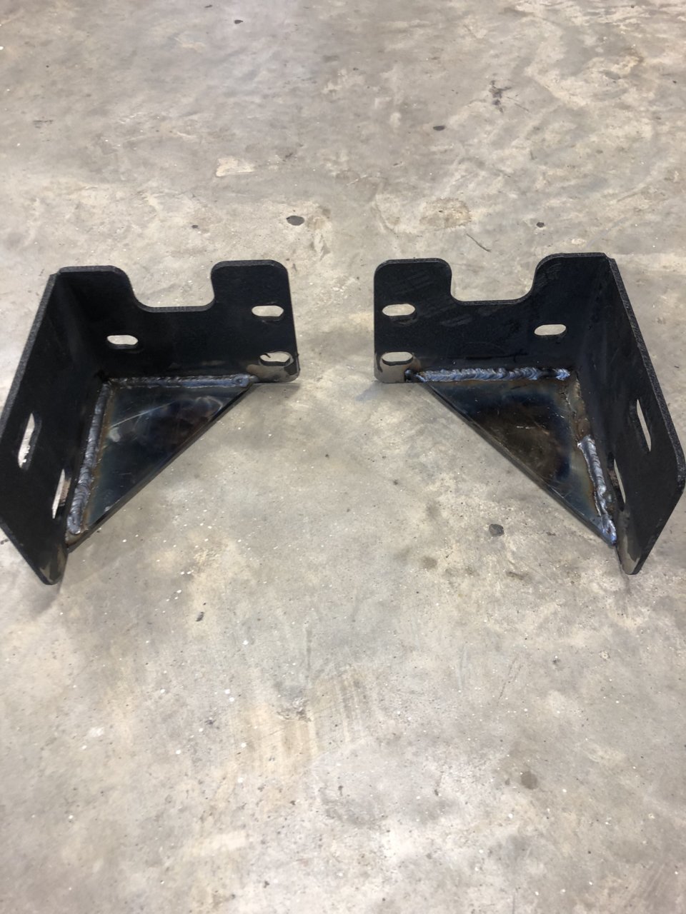

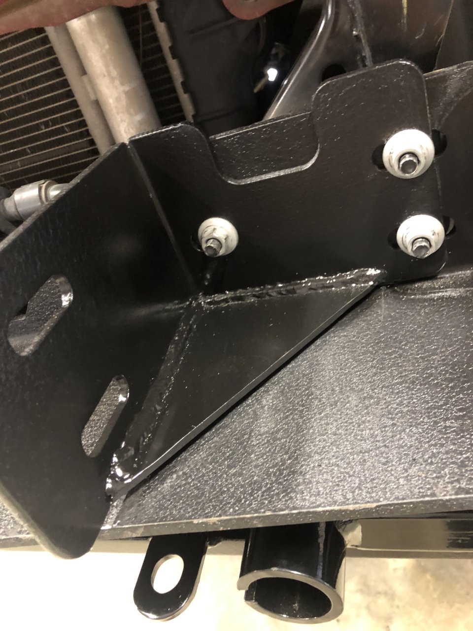

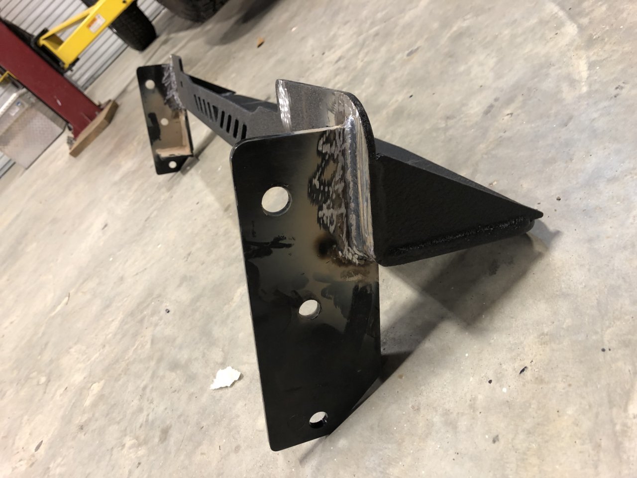

    Here are the bumper brackets after adding a simple gusset to each one. The tabs on the bumper itself that bolt to these brackets are already gusseted from the manufacturer. This should help prevent the bumper from from shifting left or right during a side pull with the winch.

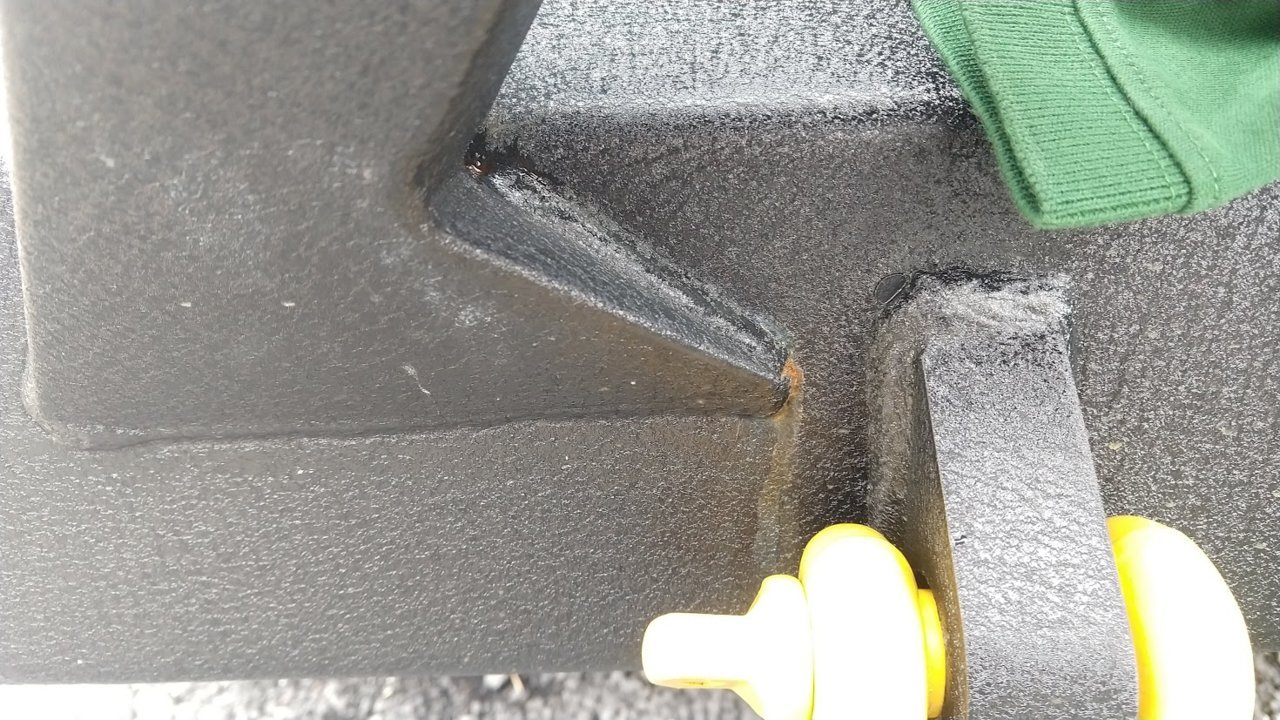

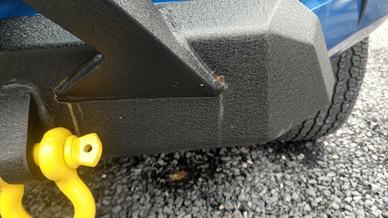

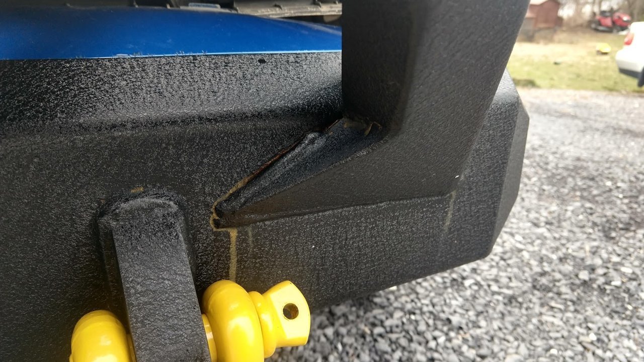

    Make sure to treat your bumper around the light bar extension so the rust doesn't bleed out like on mine:
    IMG_20191202_140400998_HDR.jpg IMG_20191202_140405109_HDR.jpg IMG_20191202_140420105.jpg
    This is the rust after 6 weeks of weather in Virginia without any snow exposure.
