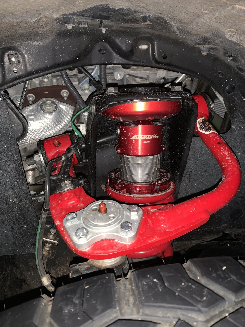

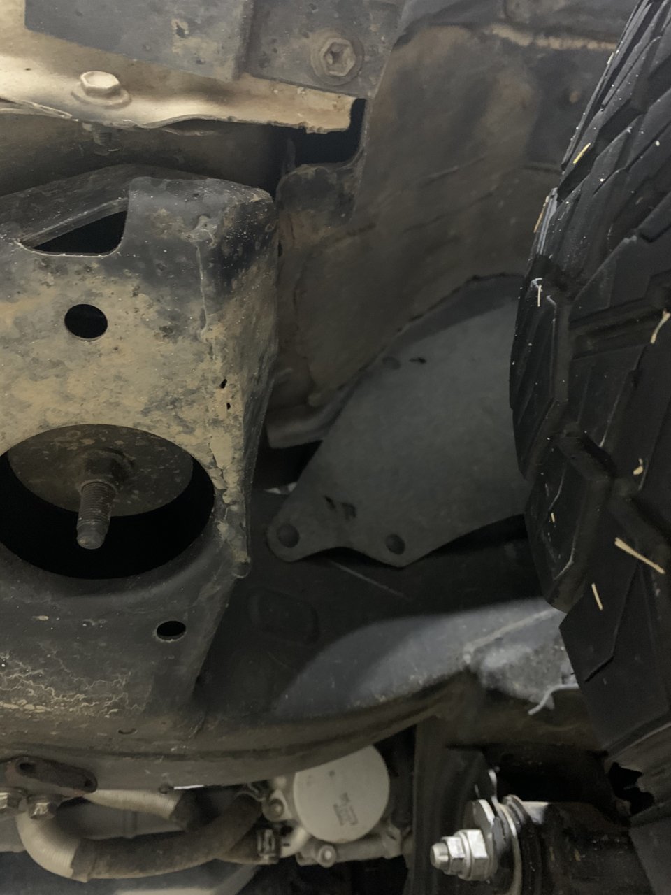

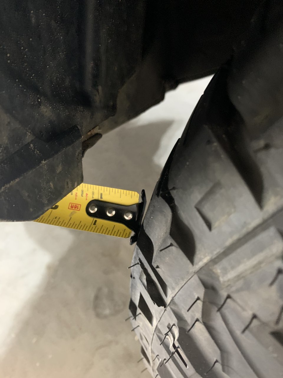

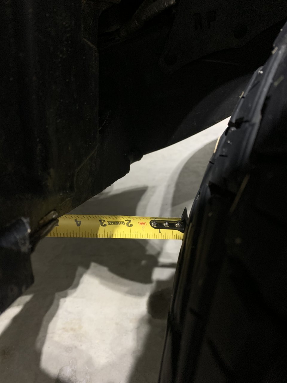

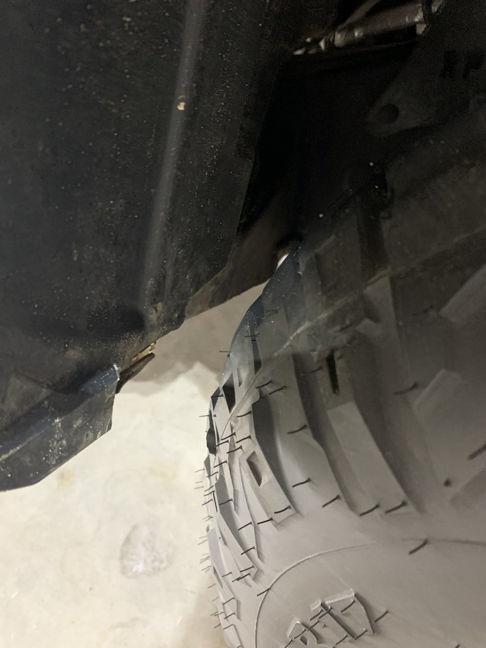

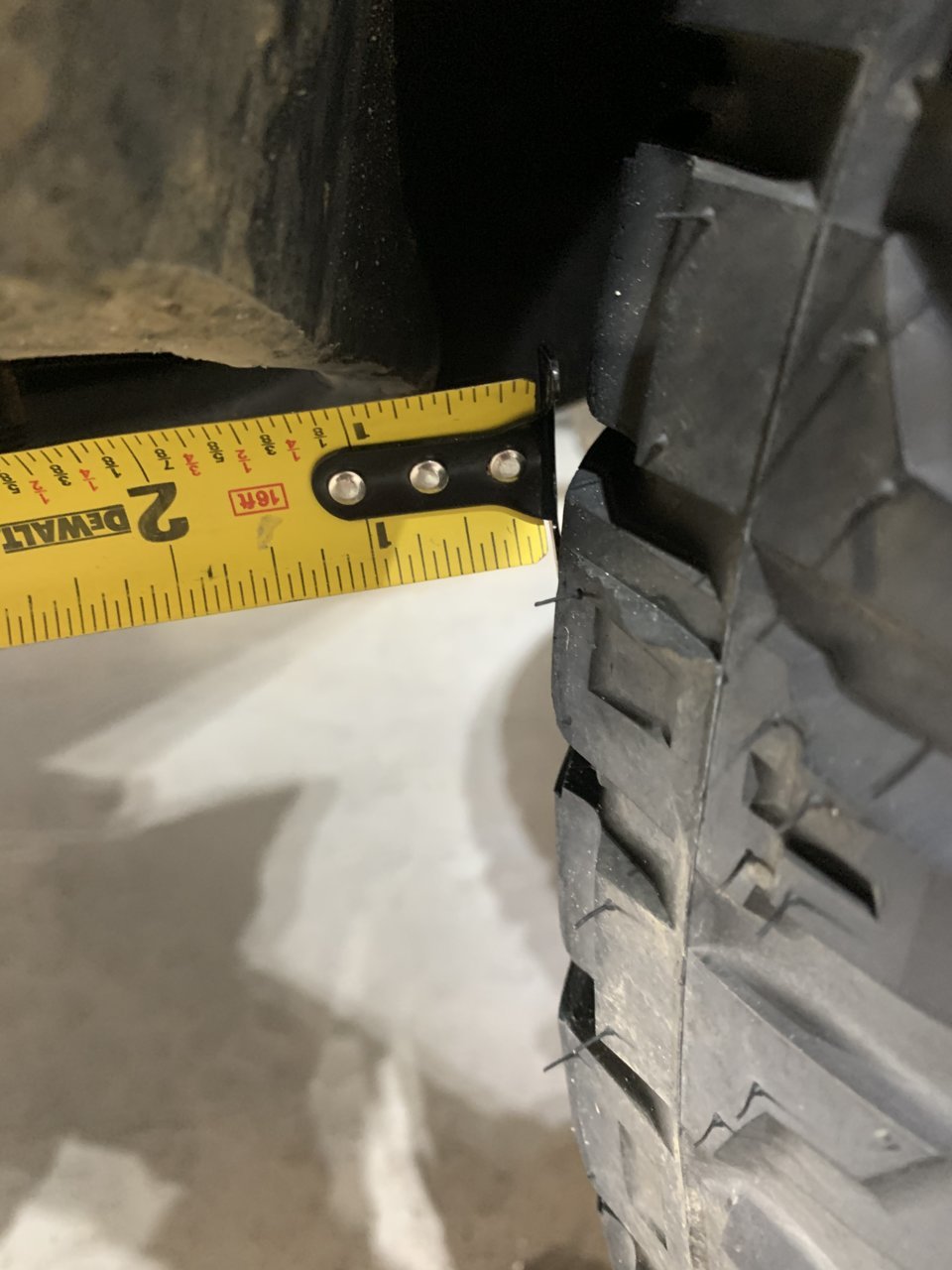

    Ok maybe these help- sorry about dirt - weather is crap here right now in Oklahoma and wheeled ozarks over weekend
    You can see full lock I have 1” of space between CM and tire. This is on 285/70/17s and with 2.5 “ of actual lift. Lifted 3” / sags 1/2 in. This is with 17x8.5rims with 4.5” BS AND 0 offset
    I do not rub ever. hope this helps explain why you will need to CMC and why width is the main issue vs diameter
