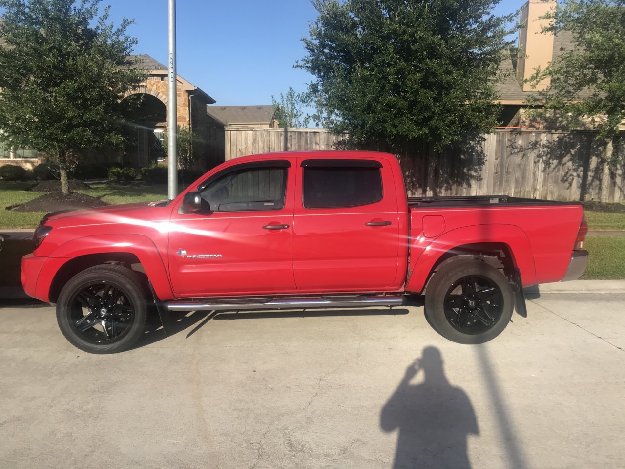

    Greetings friends, this is my first post on the forum, I recently just bought my first Tacoma, a 2007 TX edition Tacoma double cab 2wd.
    I am using this as a daily driver and am mostly running it on streets and highways although I do occasionally go over some dirt roads or bumpy areas for shooting.
    Was looking to lift my truck
    (at least 2 inches) for a more aggressive look but didn’t want to drop $3,000 on a kit since it’s mostly for looks. Am trying to spend no more than $1000 total on parts including installation. Something that will not throw my car out of wack and is decent quality as well as not wrecking my mpg. I have looked into some rough country stuff spacers as well as this suspense suspensions lift kit i found on Amazon.
    Here’s my truck currently
    Thanks in advance friends!

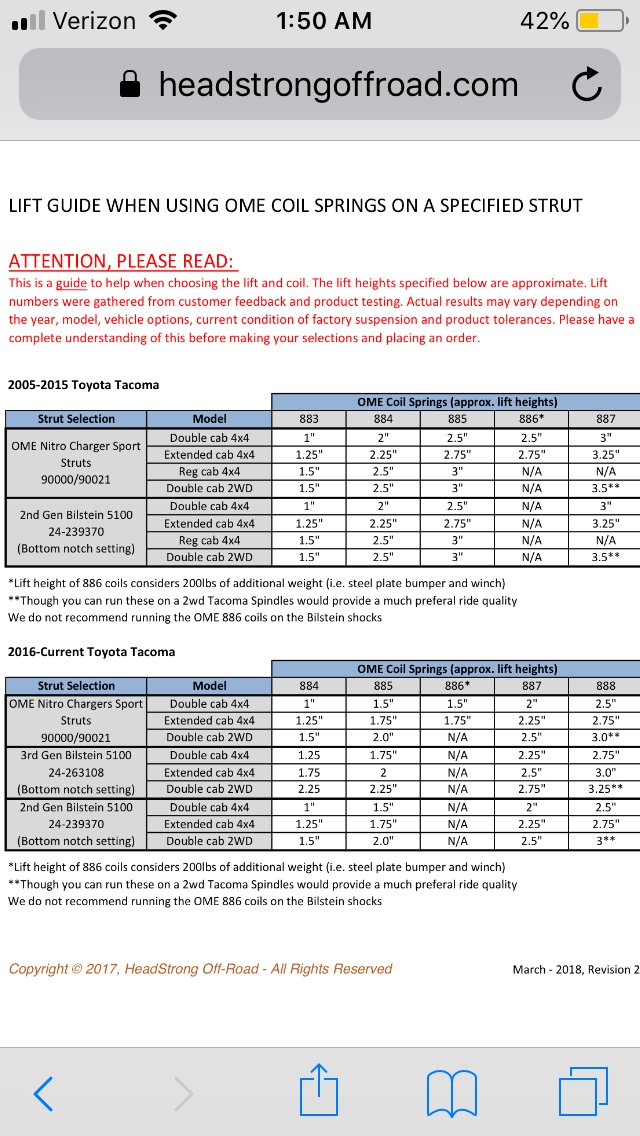

    This is what headstrong gave me to identify what I might want to use,they was very helpful haven’t ordered mine yet but there prices seemed really good or at least the same as other places I looked , mine being regular cab was gonna go with 883’s with 5100 set at 0 was gonna give me closer to level , not sure what the best coil would be for ur truck but this chart might help to get an idea
