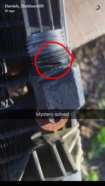

    Sounds like you have a leak in the system, not a bad compressor. There is some stuff you can put through the lines that will react with oxygen when it comes out of the leak point and turn the area around some bright color so you can easily identify where your trouble spot is.

    I turned the truck off so I could hear a leak. Behold the front bumper rubbed all the way through the steel in the bottom of the condenser. Over night part and it should be an easy fix! Keep the wheels turning!
